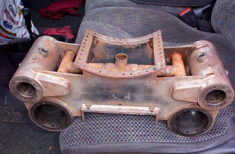

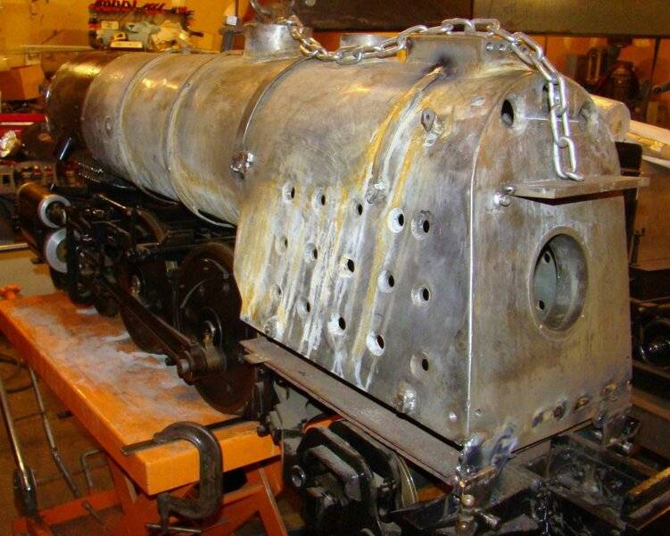

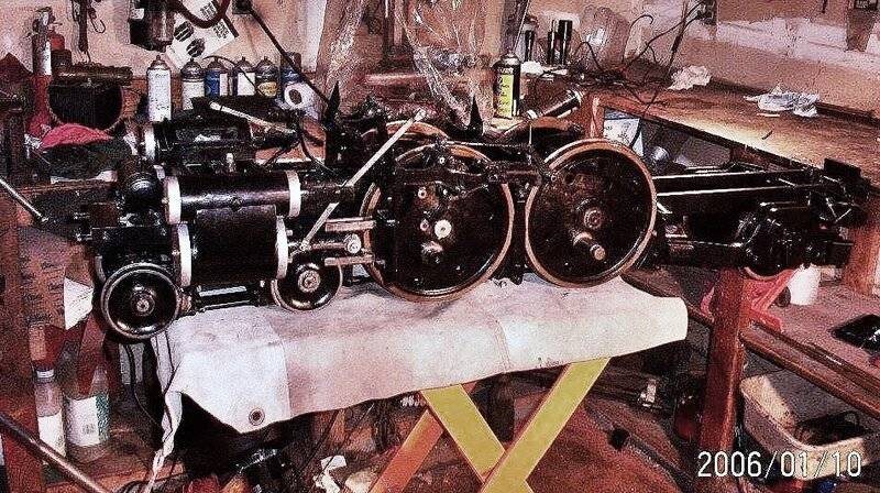

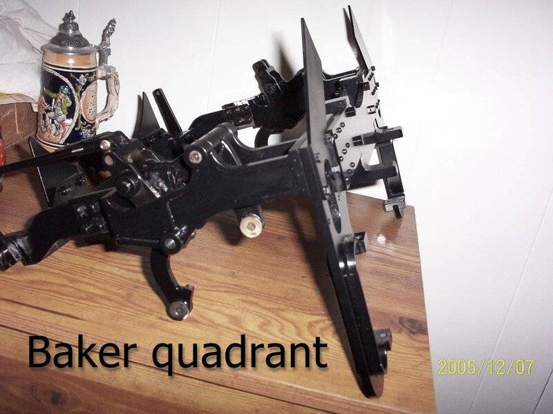

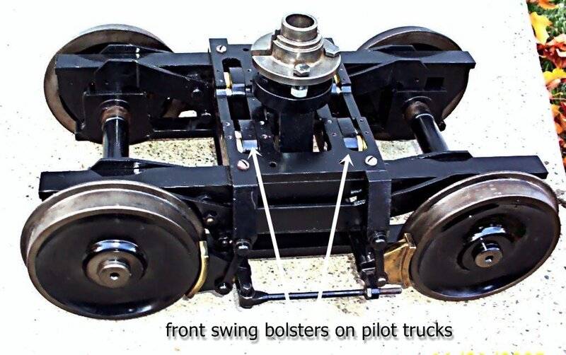

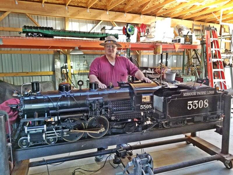

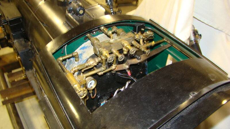

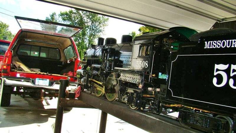

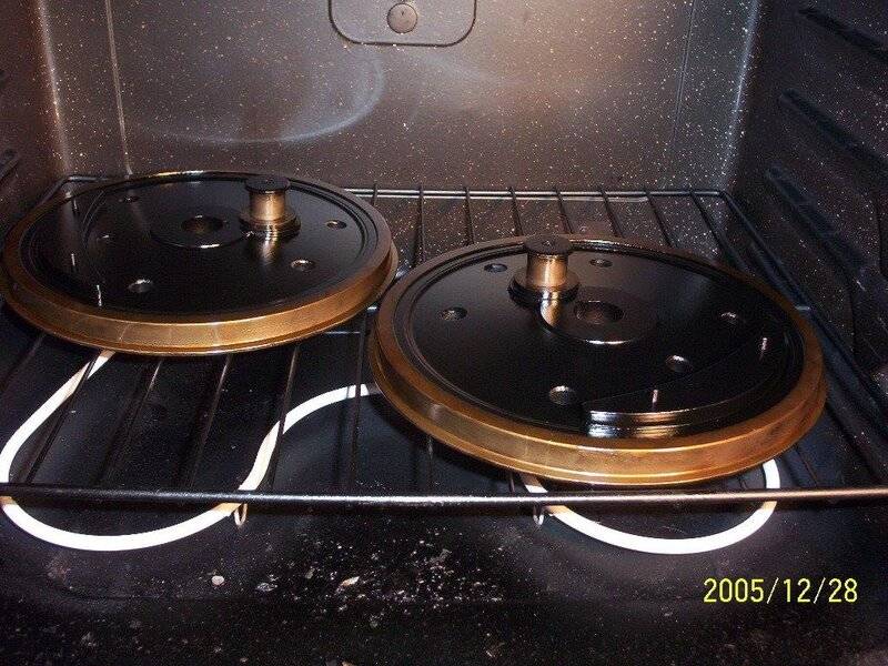

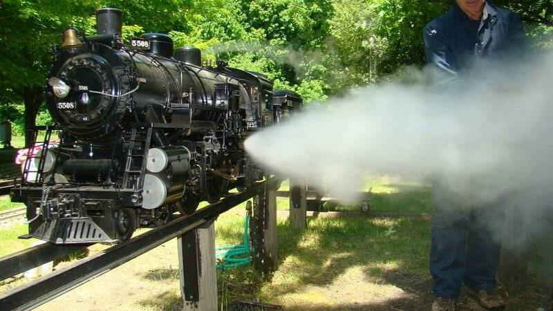

I built this locomotive a 442 Atlantic 7.5 gauge a 1.6 scale weighing in at 850lbs with 11 inch drivers and with 3 inch cylinders.
The boiler walls 3/8" and the back head and flue sheets were 1/2"
The engine suspension was sprung between the 2 drivers for better traction.
I have too many pictures so here are a few.
I could no longer run it because of the coal sulfur dioxide fumes raised hell with my breathing and skin irritations.
a few random pictures.
