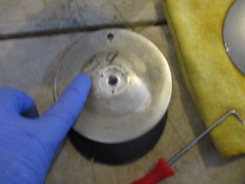

For the Love for my Father, My 69 GTX Restoration

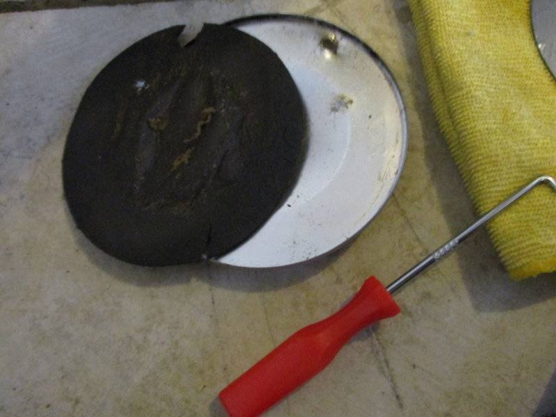

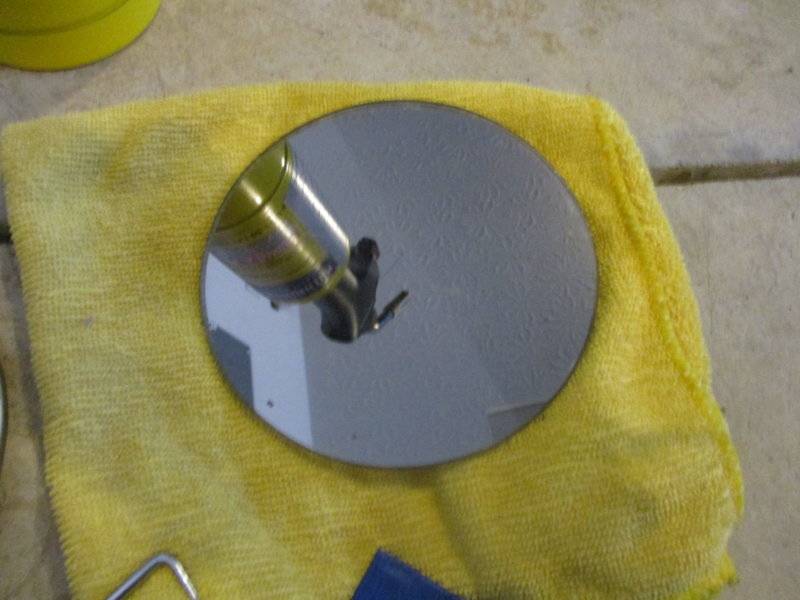

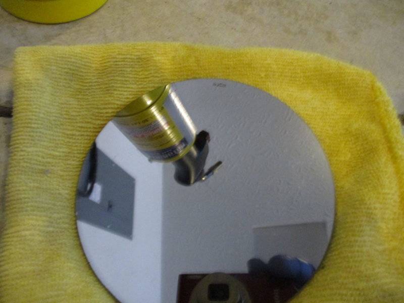

This is not for the "faint of hearts".............
I have finally accomplished a task that has haunted me......

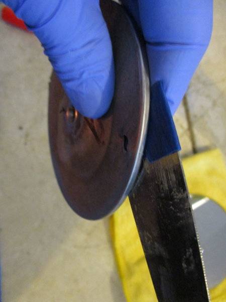

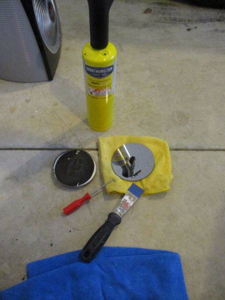

Let me describe my "crude" process.....First, hairdryer, waste of time.....WD40 did zero damaged to the adhesive.....Heat gun was not in the cards.......

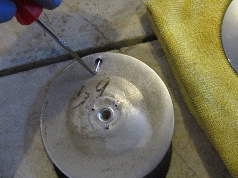

I pulled out the big balls MAP gas.....Putty knife and a 90 degree pick......I laid the mirror face down on the concrete and ran the torch around the perimeter until I heard "crackling". There is a 1/4" hole on the backside and i used the 90 pick and worked its way in slowly without scratching the mirror. Then I put the heat to it again. So with the tip of the pick facing north towards the edge of the mirror. I her so carefully pried back towards the center. It opened a gap between the mirror and the housing. Then came the putty knife.
The key at this point is DO NOT pry with the putty knife. Now I am using physics, heat and pressure. With the putty knife wedged in tight. I went crazy with the heat with the mirror face down on the concrete and putty knife in place. I went to pick it up by the putty knife and the mirror resided on the floor, done deal...:D:D:D:D
I finally, finally......still cannot believe have the perfect date coded mirror for the X......When the car gets back in the future. I will update with the install......

Ohh BTW look at the date on the back of the housing......very fitting......
What a way to start a beautiful Sunday!:thumbsup:

Finally found a mirror with good reusable glass for the X. It has the correct date range for the SPD. The date on the mirror is 9JC8 for September 1968.....
Anyone have any good ideas on how to soften the glue to remove it safely?
Hi Justin- I know it's after the fact and you successfully got the mirror off, but my technique for removing glued on mirrors is taking fishing line or dental floss and slipping it behind the mirror and using the line/floss in a back and forth sawing motion to separate the glue from the mirror. It's sort of like a wire cheese slicer, with the thin wire easily cutting through dense cheese, once it separates the cheese/glue, there is no resistance to keeping it moving because it is so thin. Wire is stronger than line/floss, but might damage the mirroring. Just an FYI for anyone else too. - Abe
Abe
thanks for the input......The only flaw in your approach I see is the the mirror sets in the frame and its tight. There is a 90 degree lip on the metal frame.....Have you done this with a mirror in the frame?
Btw my route took five minutes.......
Justin
I've done it on several mirrors, both in frames and out. The fishing line is flexible enough to slip in the small gap between frame and mirror yet stiff enough to "push" it into a space to get it where it needs to go. Just another method.
Good to know and thanks for the info. It just seemed with the recess mirror it may not be possible....How long did it take?

Did you ever think of a “soak” in toluene? Sorry couldn’t get on the last couple days because of pop ups from Amazon & Walmart ads (?). Prying forcefully is not the way to go! The “pop-ups” were from ‘safari’ on my iPhone.(it obviously knew I loved FBBO!)
I have been having the same issue on my iPhone and I have deleted everything multiple times and no luck......
Thanks for the input but thats a nasty chemical.....
There are a variety of chemicals and chemicals that will damage the mirror backing.......Also, I dont have every chemical know to man in the garage. I would rather start simple and then move more complex.Paint thinner would have been the next choice as where I read many have had great results with that.
I didn't pry on it forcefully, just enough tension to flex it out to get the putty knife in....Once the putty knife was in, then heat along with the tension of the blade. As the glue meted, the mirror magically released.........the mirror is out and undamaged....
In hindsight. I think you could just lay the mirror flat and just go to town with the heat and it would fall out......

Thanks my friend.....I wish I had a three or more mirrors to just try again. To try my process again and the PT/acetone/toluene as you and others suggested. Also, the wire trick.....
