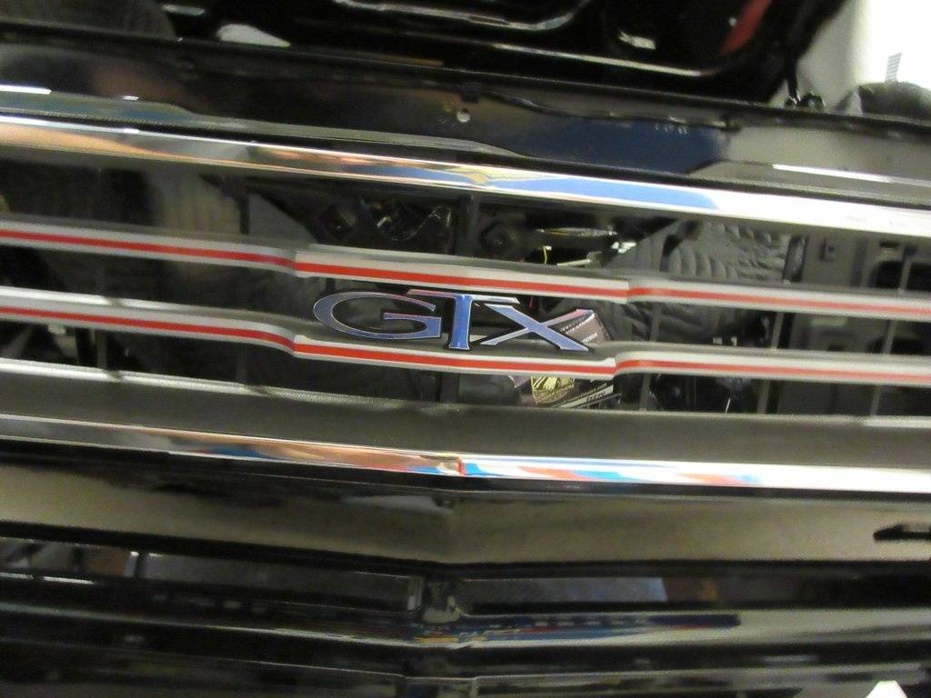

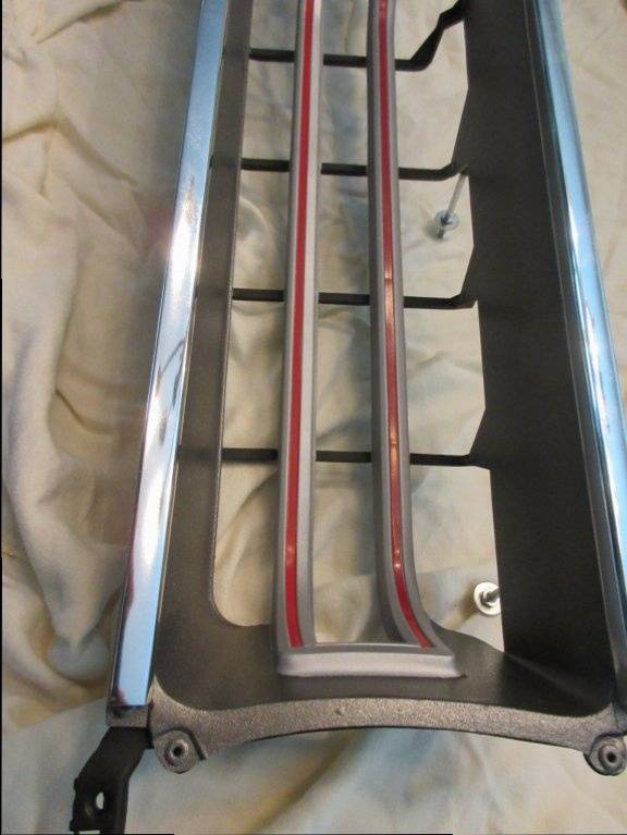

The GTX grille was restored by Totally Auto and they far exceeded my standards as always. Let me tell you Dave and Chaz(especially Chaz) went above and beyond for my project. So many stories and too many to list on my journey with them. Chaz brings a friendship and a home type feel when you deal with TA enough. The PR, customer service and quality are second to none..

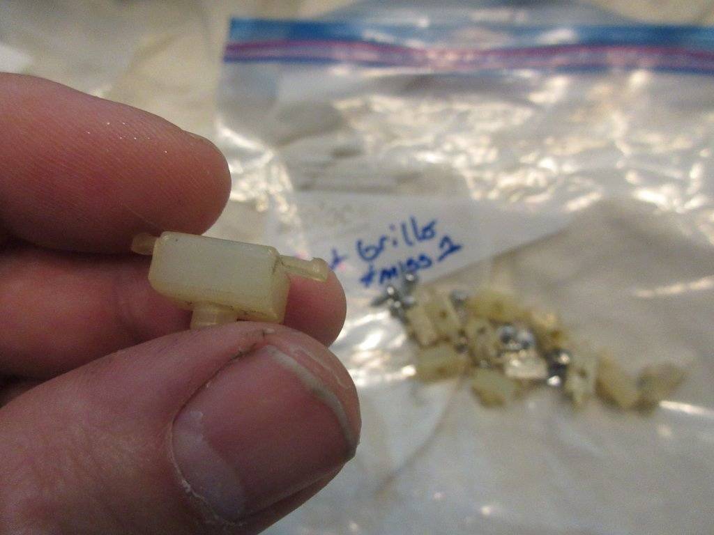

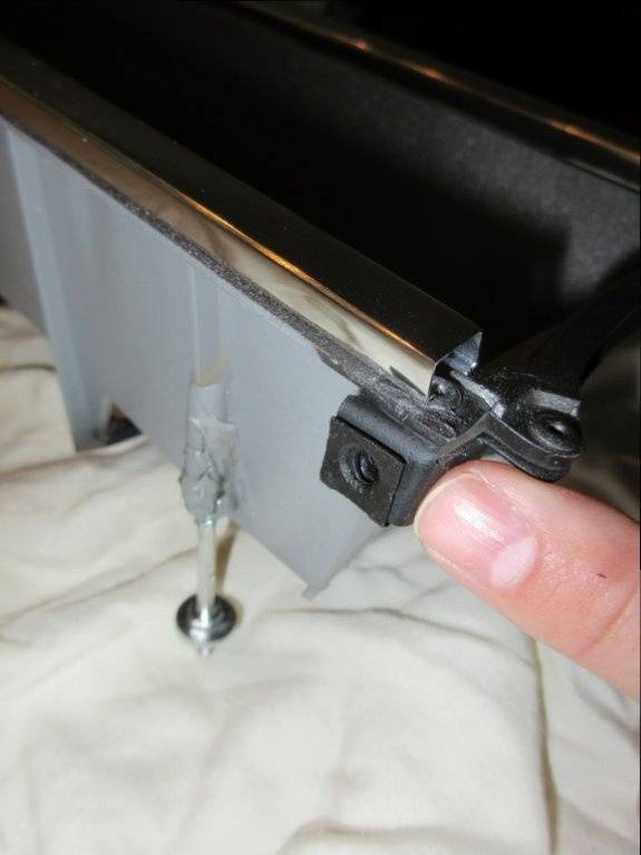

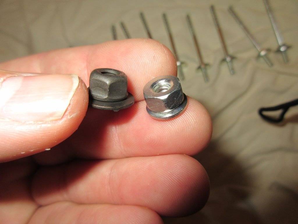

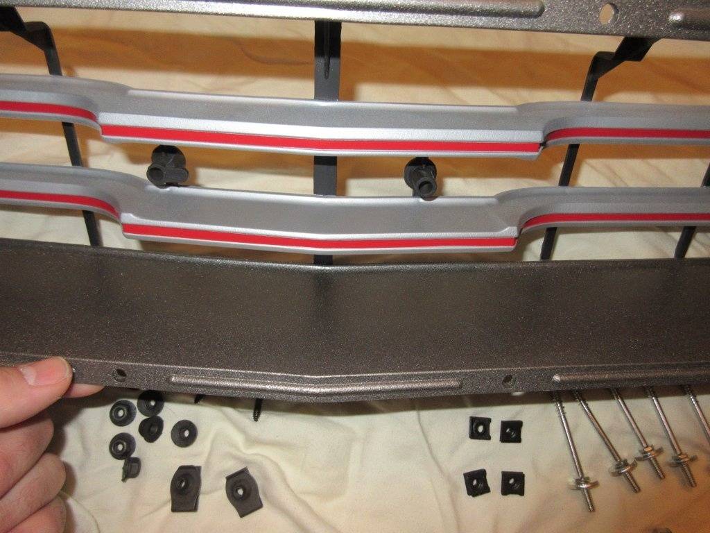

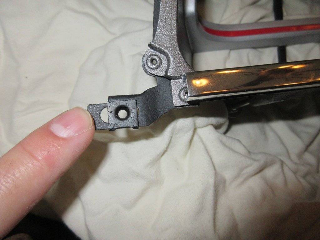

The grille hardware kit that is repop is not even close the only usable item was the bezel screws! The picture showing the two nuts with captive washers one on the left is a repop and the one on the right is from TA's kit....What a difference! The kit from TA for the rods and washers is spot on...The last picture shows the original nut with captive washer.

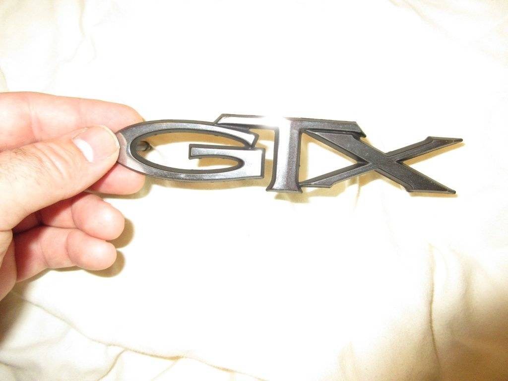

The GTX emblem is the original one and TA polished and applied the black treatment....

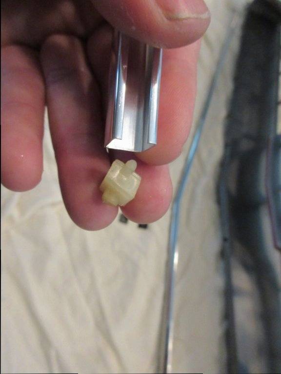

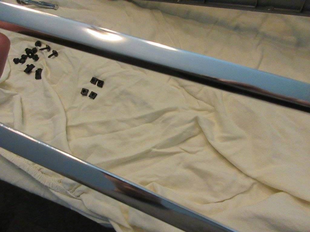

The original trim was anodized by King of Trim. The original trim clips were cleaned up and the screws were plated. The plastic pieces go in one way with the raised center facing the grille. Those center fit in the round holes in the grille to align everything up.
Original hardware was plated and do not forget to install the bezel clips and the clips that go on the center support bracket...

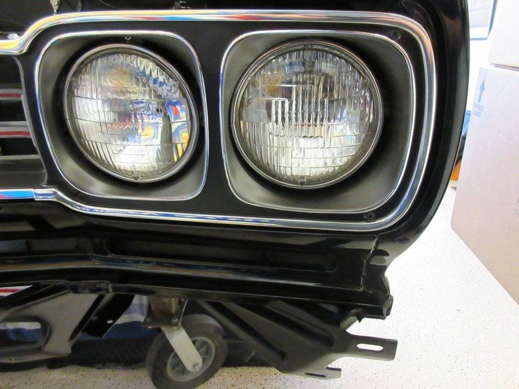

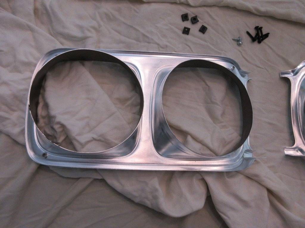

The original headlight bezels were restored by King of Trim. They anodized them and applied the satin black/textured argent(TA's paint)...

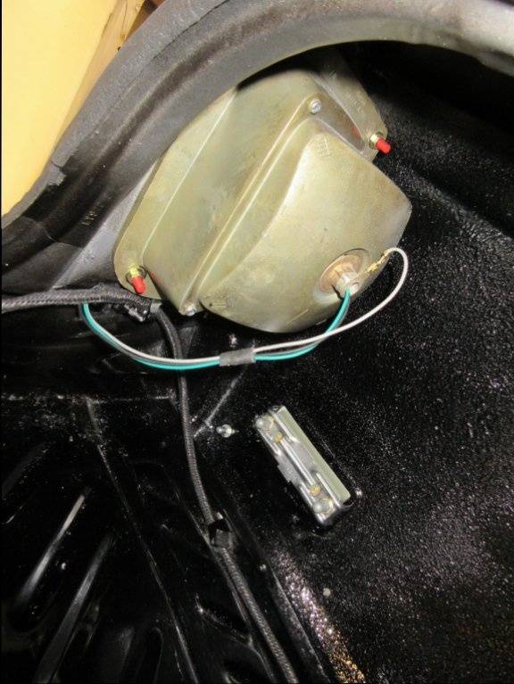

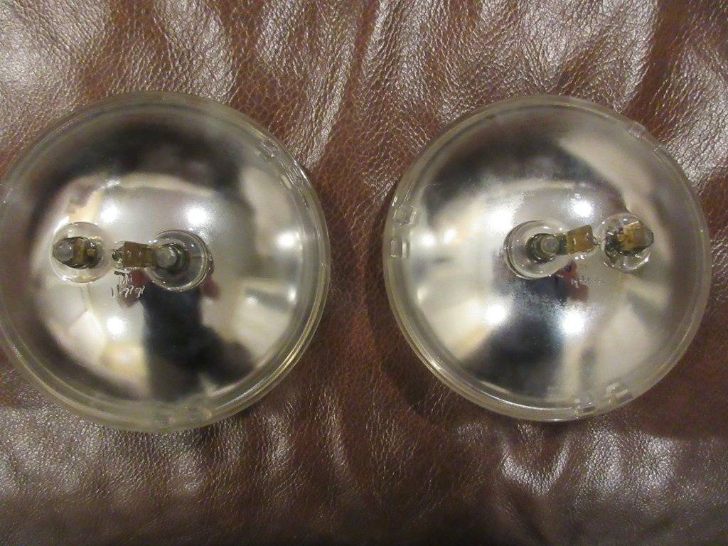

Front end looks fantastic! I really need to check my headlight buckets because I paid zero attention to the colored stripe on the back lol.
There are some fine adjustments to do...I will deal with that later once it gets on the ground.
Thanks! The majority skip the stripes but judges with keen eyes and mirrors do not miss em....

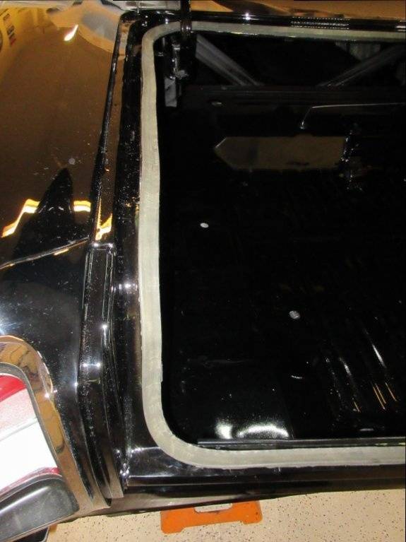

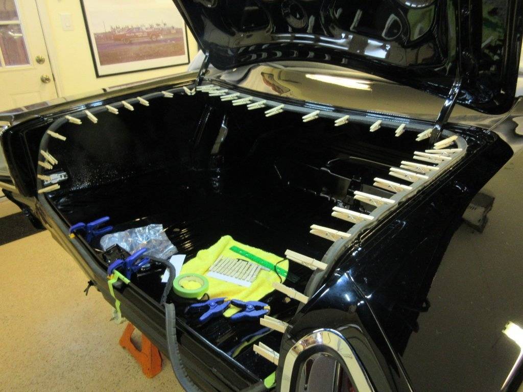

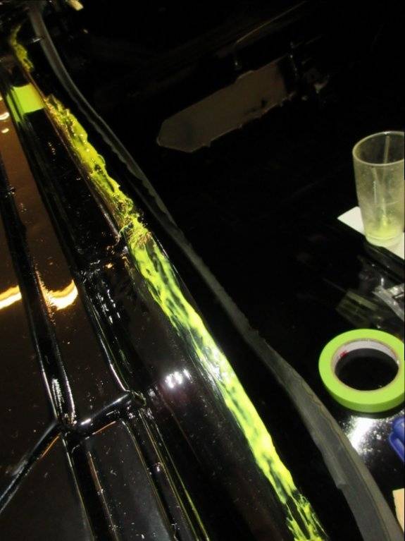

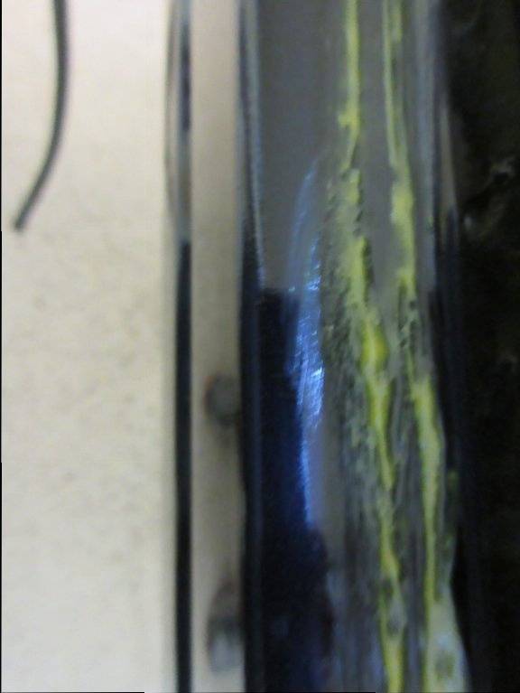

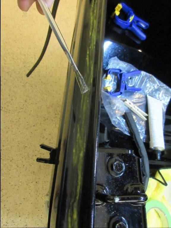

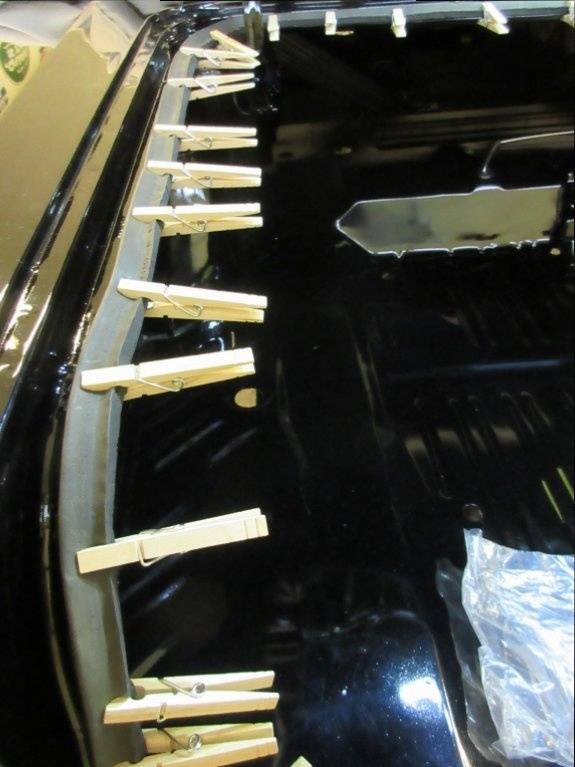

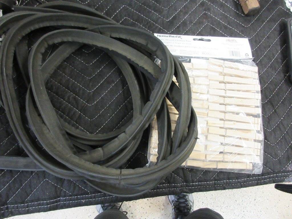

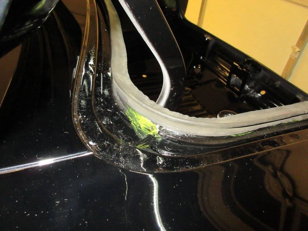

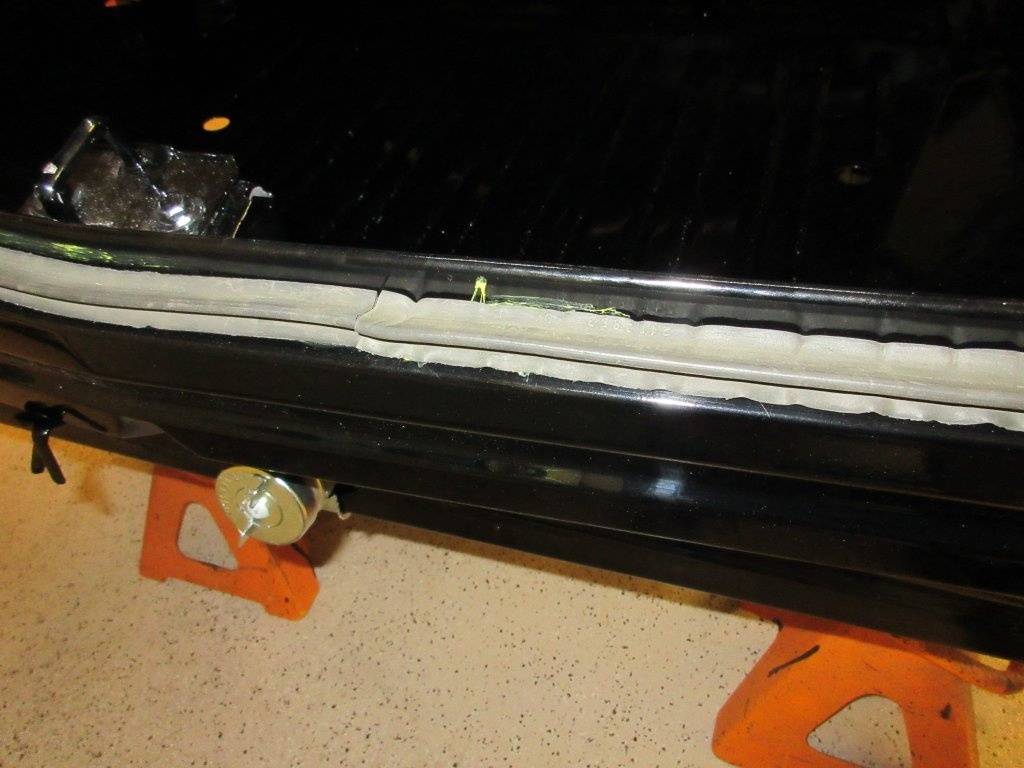

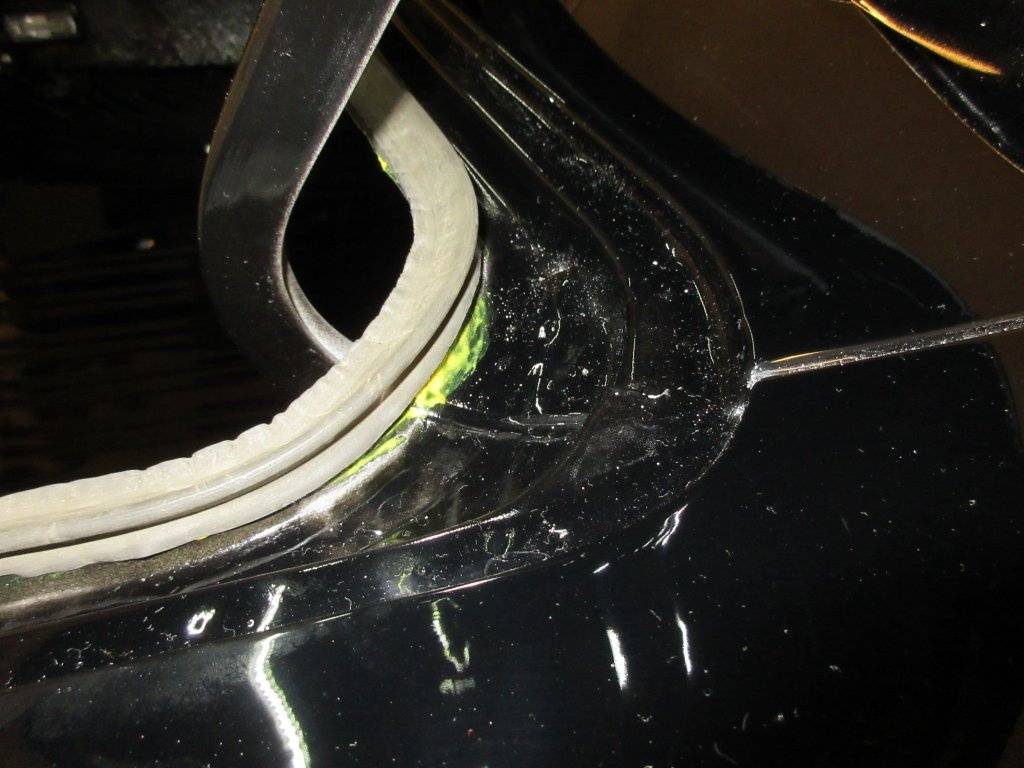

Installed the NOS trunk weatherstrip. First thing I do is wipe the trunk lip down with wax and grease remover. Next, I dry fit the seal and hold it in place with tape, clamps and close line clips(lots). Once fitted I divide my work area in sections which on this car was five. So about a 3-4 foot section at a time. The adhesive I use is 3m's yellow trim adhesive. So I pull back the first section and lay a bead then to mimic the factory look I spread it out with a brush and get sloppy with it. On an OE job you should see areas of visible yellow adhesive on the paint. I allow it to set for a couple minutes and then install that section. Wait about ten minutes and then start on the next section. No need to rush it...I did not put any adhesive where the partial vin stamp is so it can be pulled back to see it.

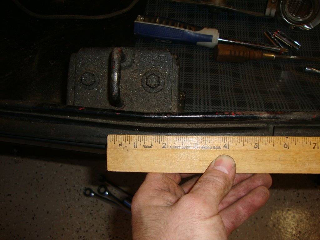

The original gasket was off set to the right 5 1/2 inches from the trunk latch. So the NOS one went in the same spot.

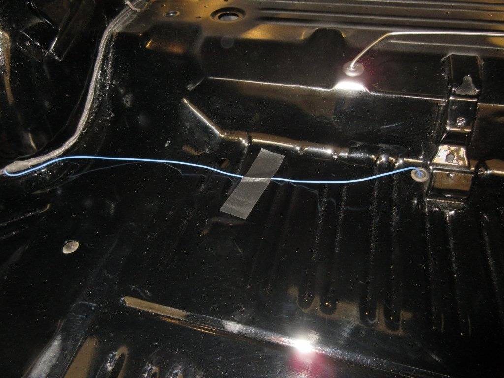

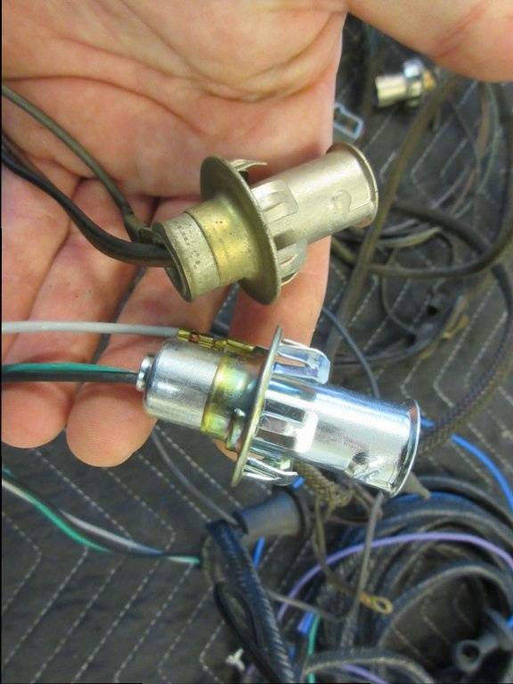

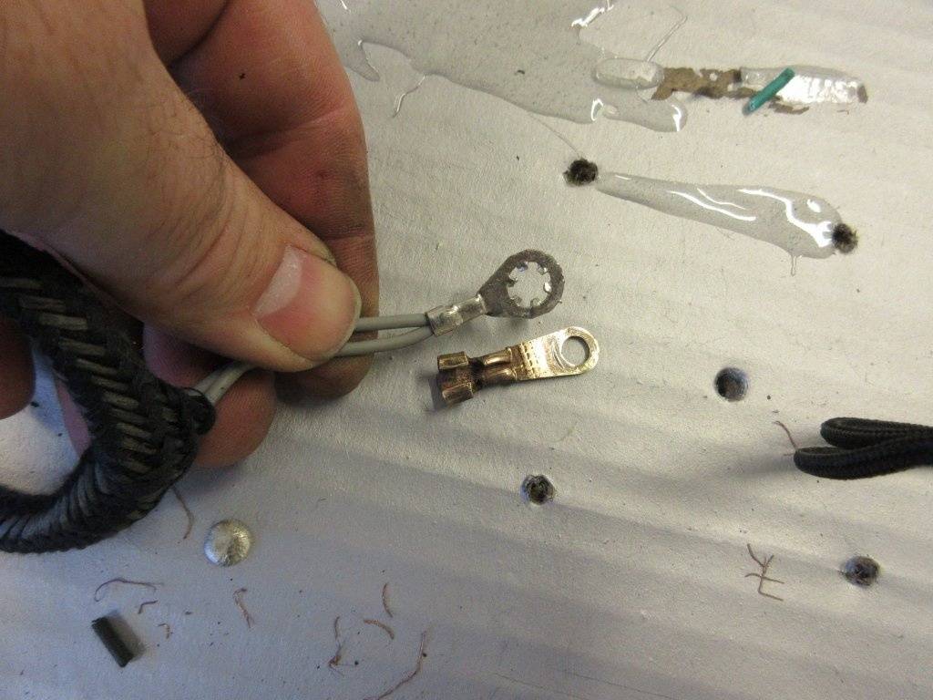

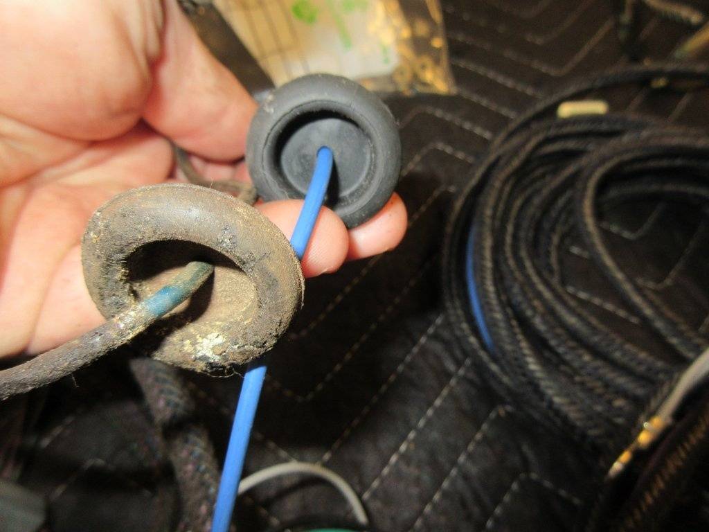

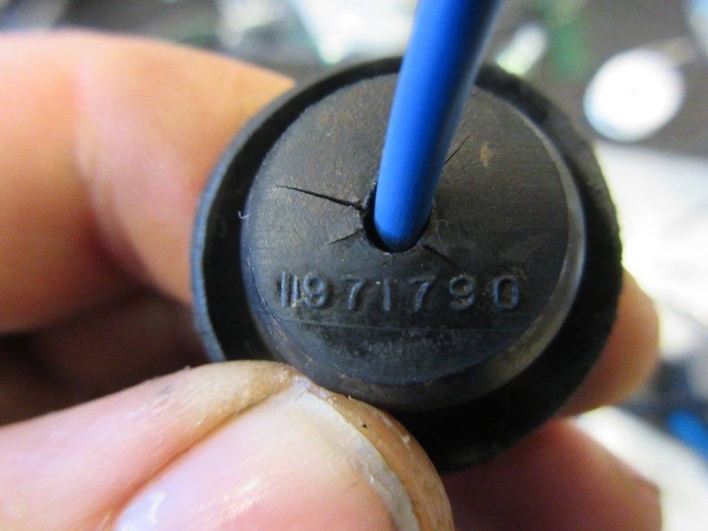

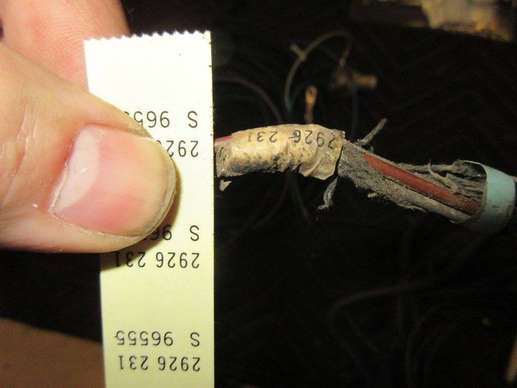

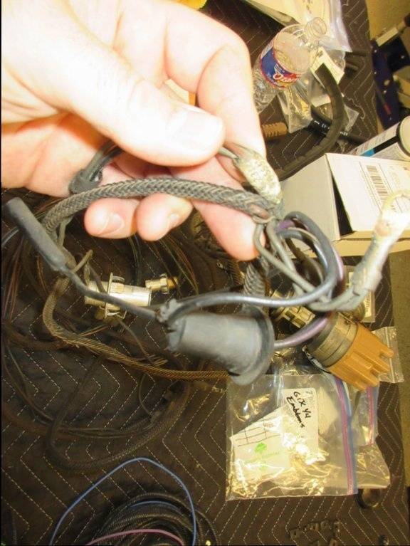

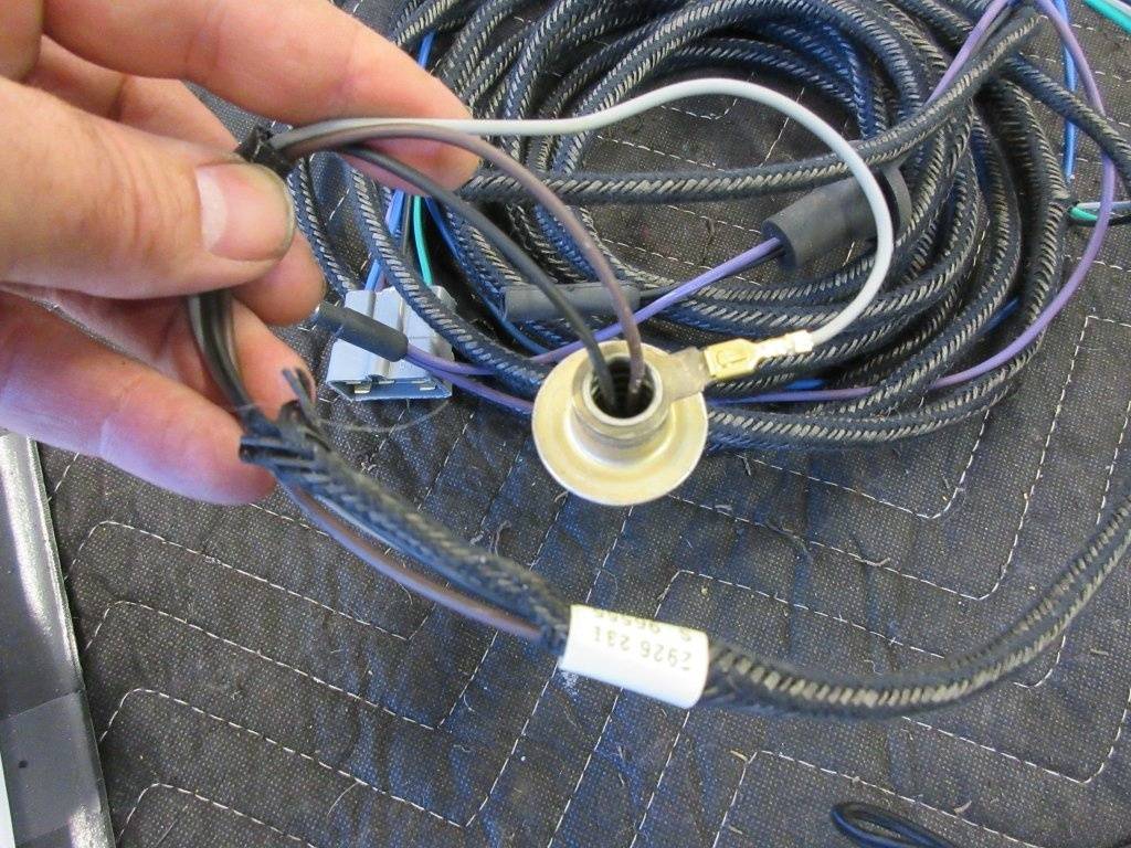

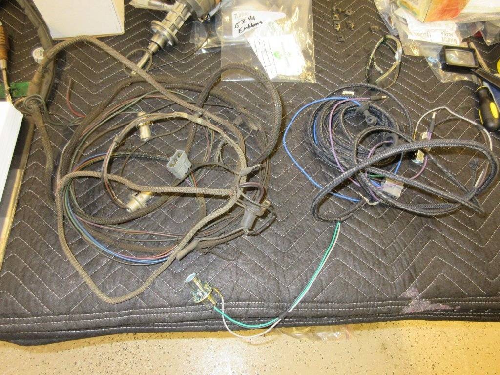

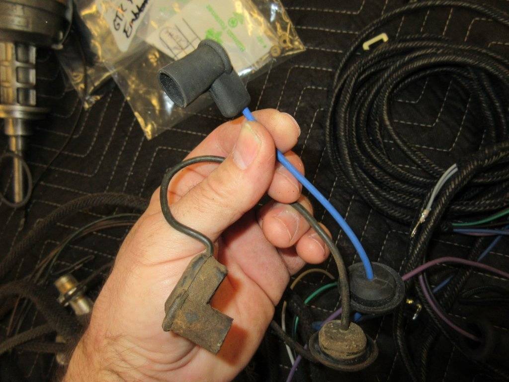

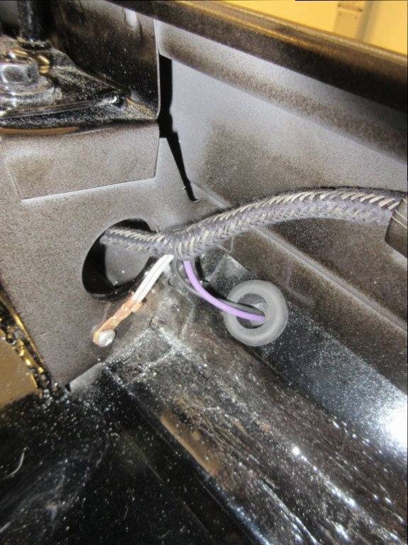

The original tail light harness was unusable mainly due to the covering and faded/painted wires. Never was able to acquire an NOS or a real nice original. So I had to make a new harness to look like the original. As you can see the sockets are completely different, the sending unit plug doe not have a pn/dpcd logo, the ground clamp is different. So I spent a lot of tedious time and transferred the old parts to the new including the plastic hold down clip. Applies the harness tag from ECS in the same spot as the original one....
Installed and 2" wide paper tape was used on the sending unit wire
