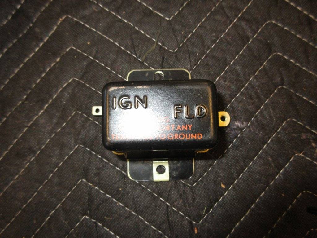

Finally, acquired an NOS voltage regulator to replace that POS reproduction aftermarket junk....Big D A12, Darrin, Is working on the cover to get me one with the proper font, color, and date code. Once I get that cover I will repost this and show it on the car. Wish I paid $19.50 lol...

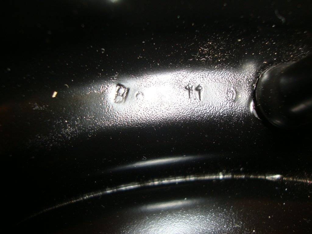

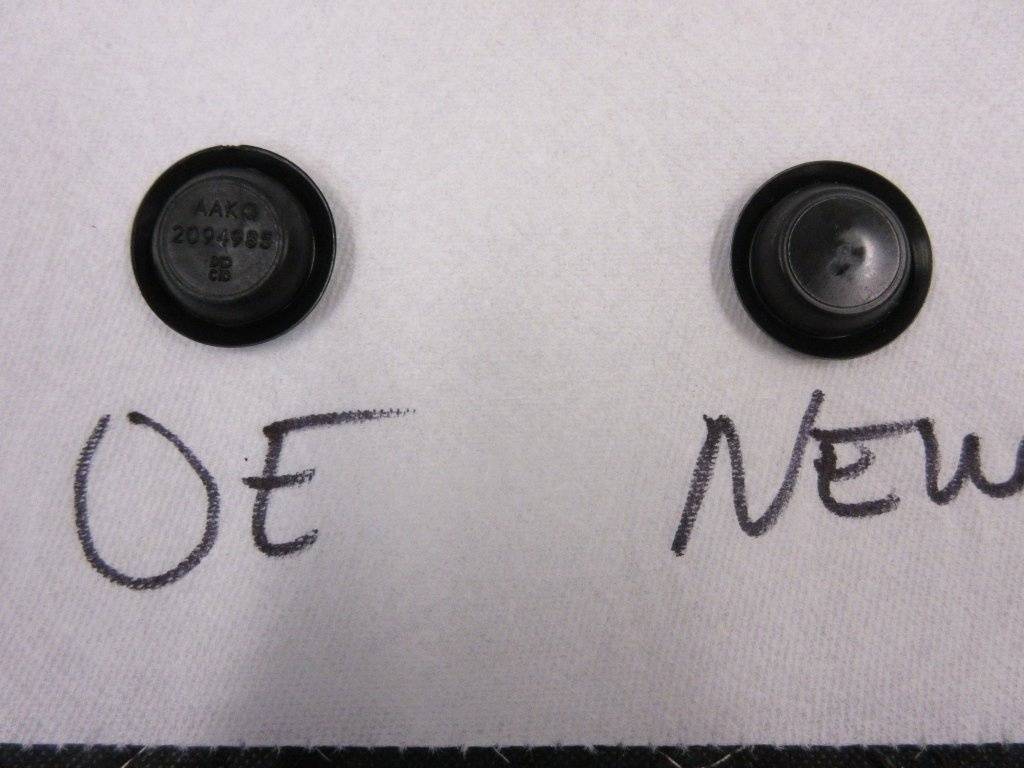

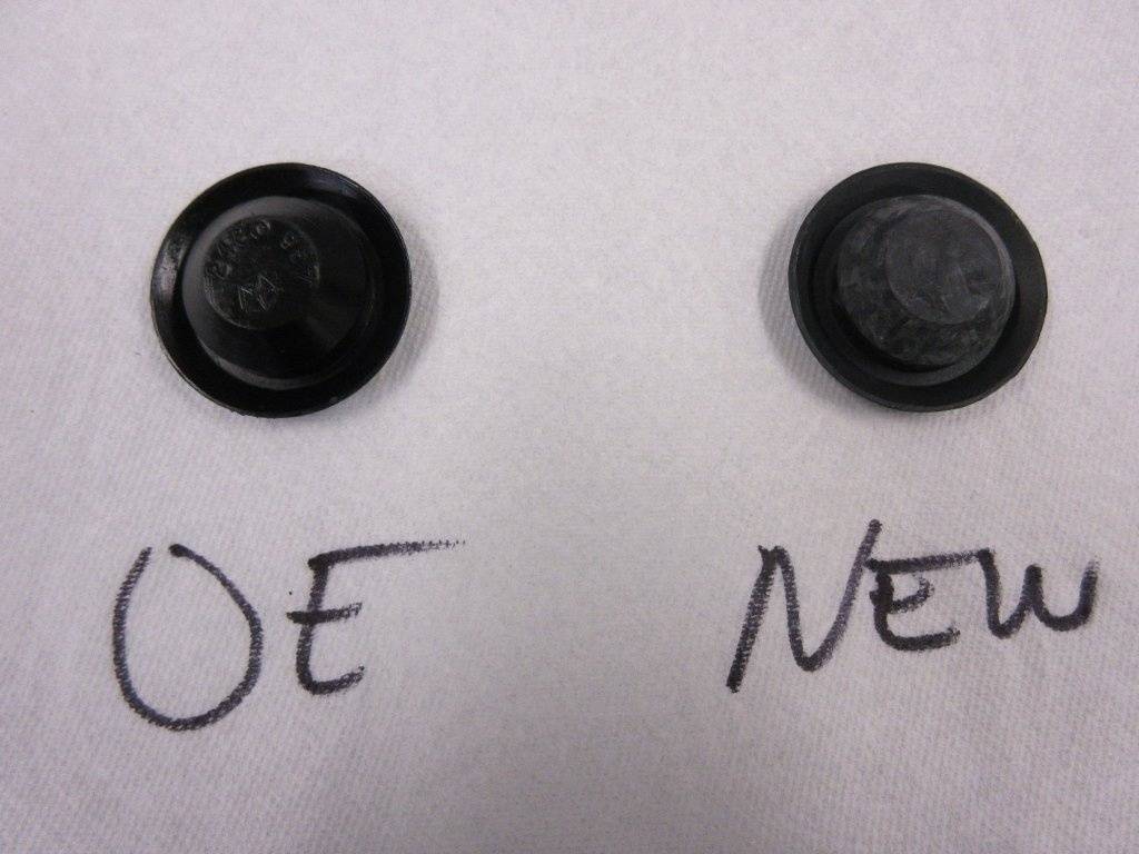

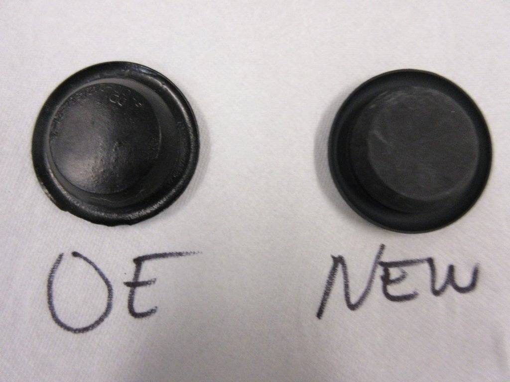

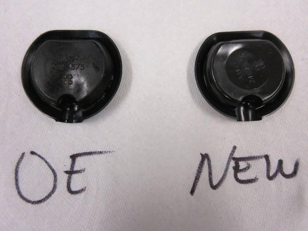

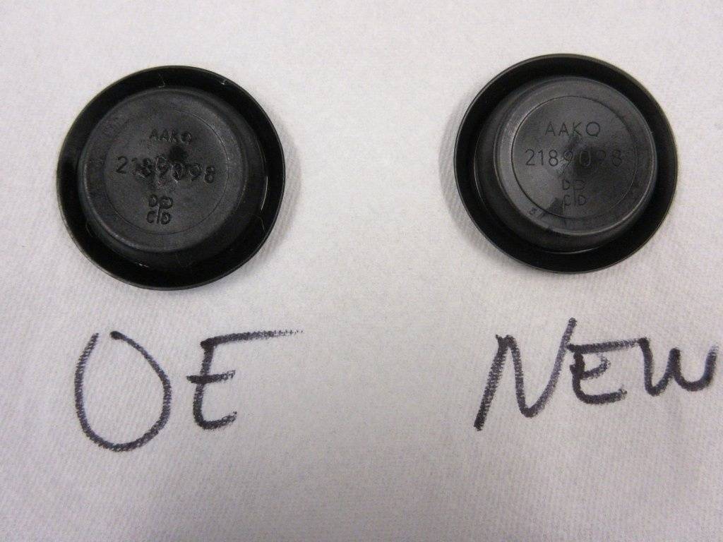

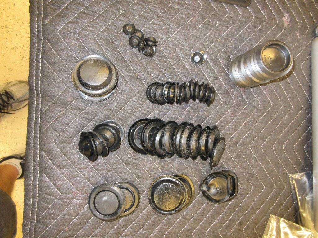

Spent a lot of time restoring the original body plugs. I first boiled them in water for about 2 minutes. I cleaned them using SEM vinyl prep and liberally applied "back to black" from Mothers to rejuvenate them. They turned out nice for being as old as they are. I will take pictures of them installed once I get the 2 plugs damaged replaced. Showing exactly where they were placed on the body.

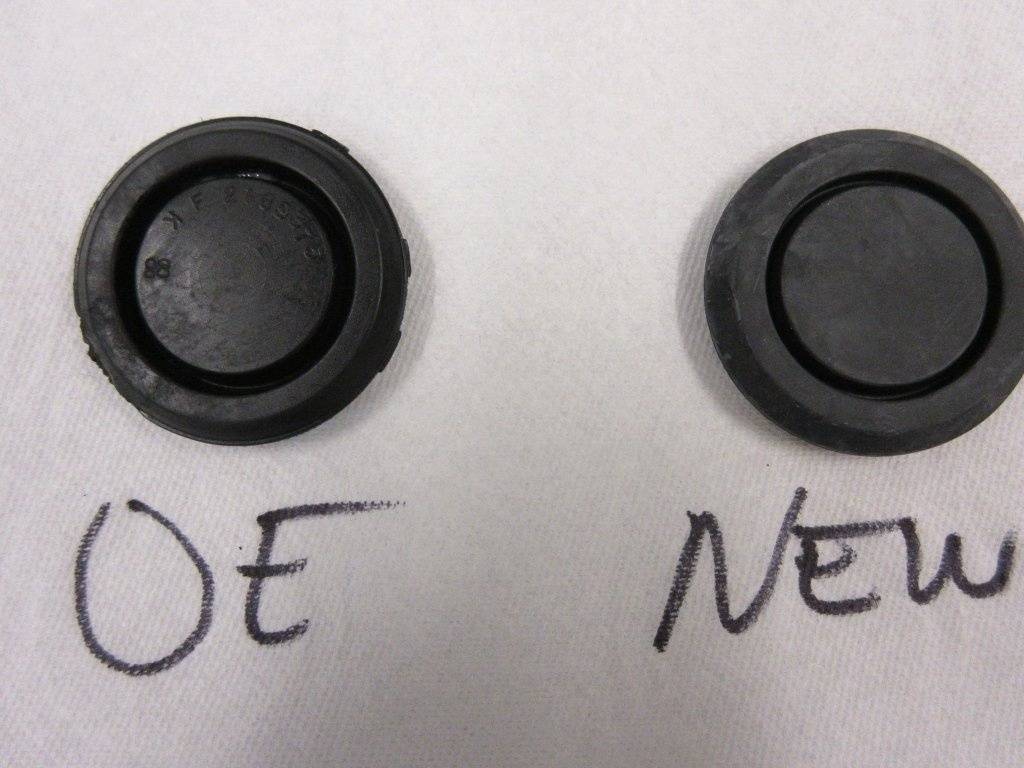

I also compared a new set to the original and the new set is junk....They are bigger than the originals, no PN's, PN's in the wrong style/font etc.

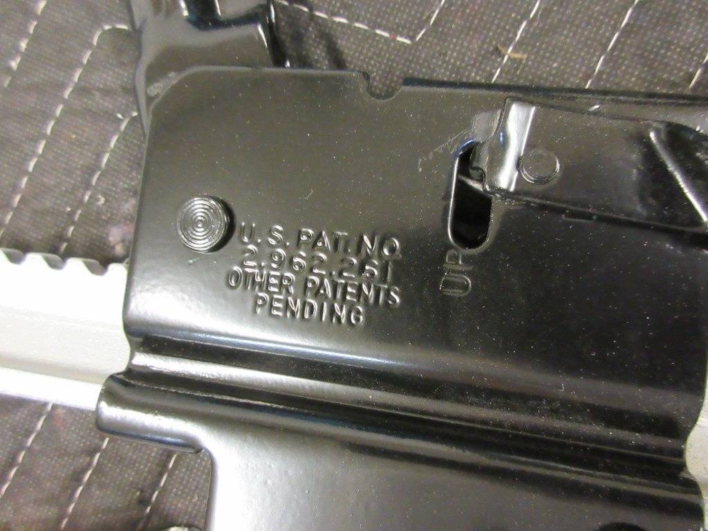

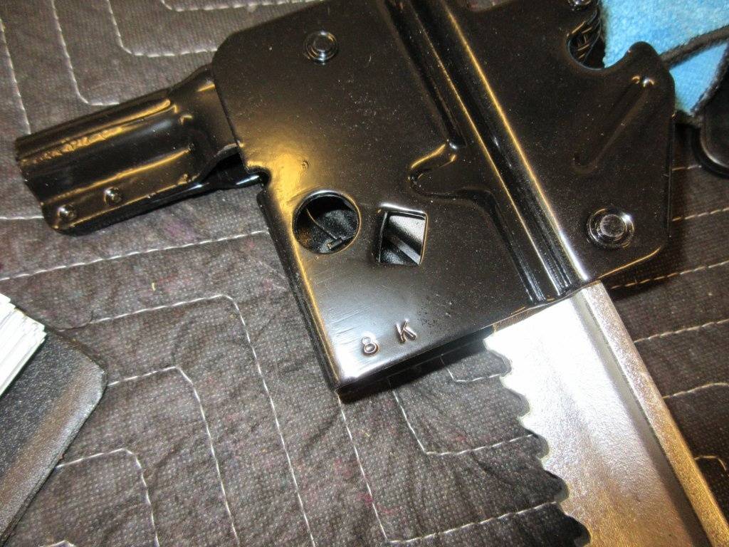

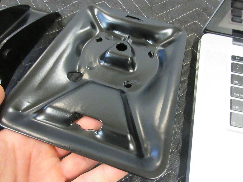

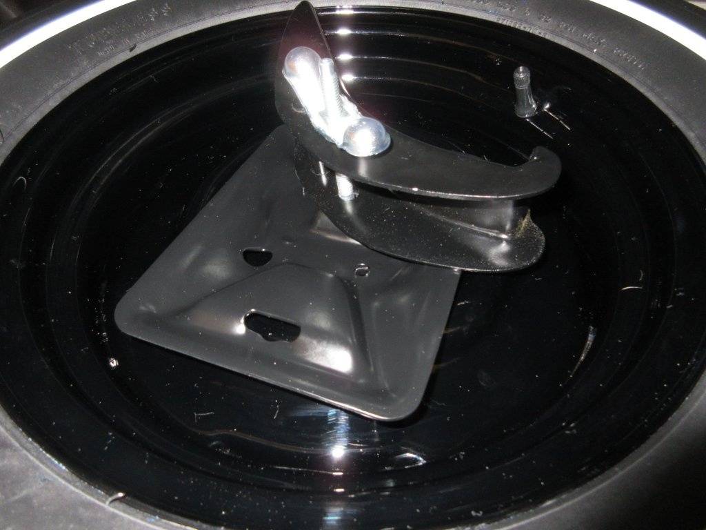

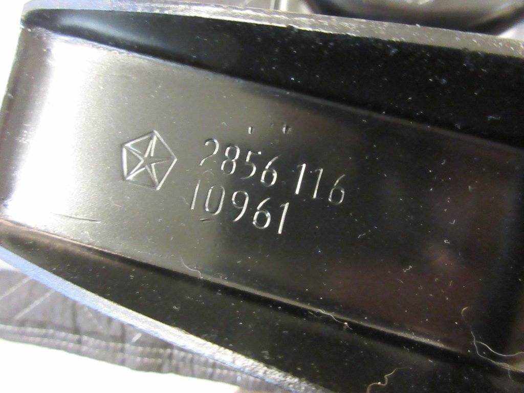

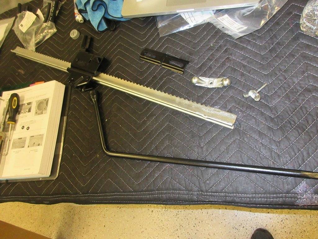

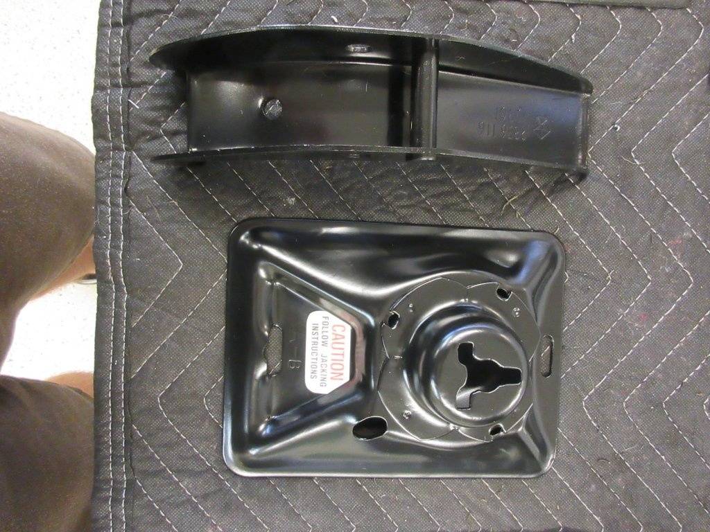

Original jack was restored by Totally Auto. The date is 8 K for 68 November. This is the original jack and one of the three parts that had an only dated part. The wing nuts, rod hardware and rod were restored by TA as well. The hold bracket, base, and lug wrench I restored all are done in semi gloss. The bolt has the "H" head marking.

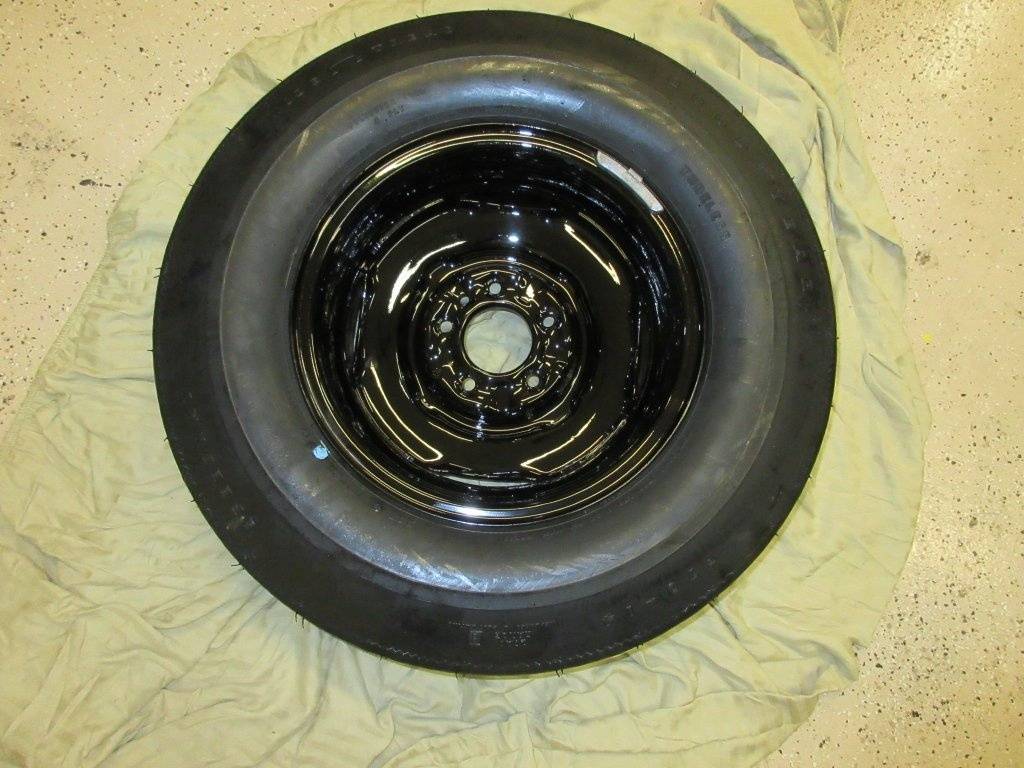

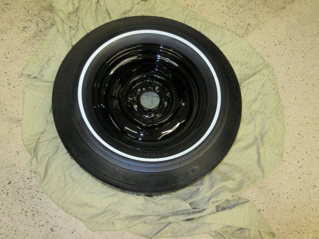

The rim is the original spare tire rim. It was the only rim that survived. At some point in the cars life the second owner put magnums on it and pitched the steel wheels. This car came coded for the steel wheels and dog dishes. The tires were originally Goodyear speedway pro's F70 14" white stripe. I also have the original spare tire with correct dates but the condition is poor. Apparently, it was rotated with the original tires.

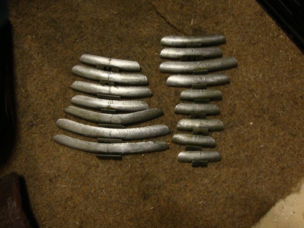

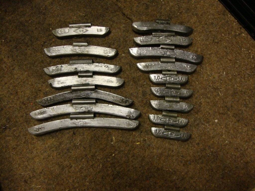

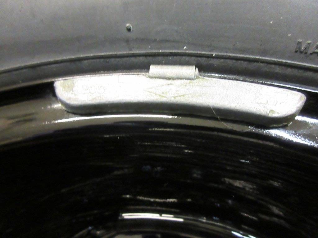

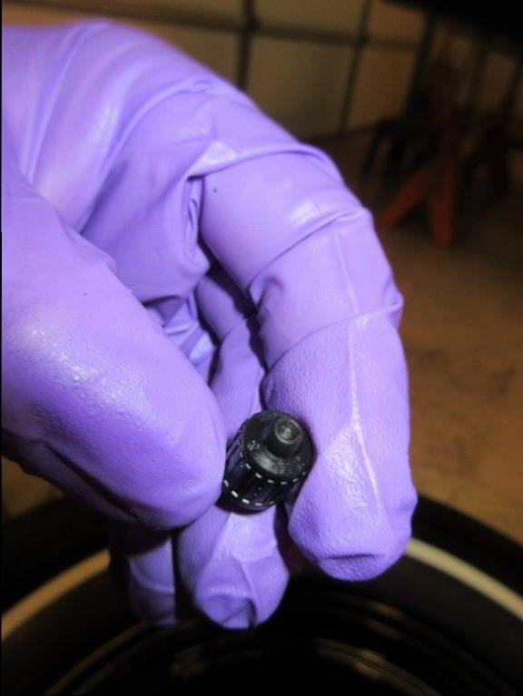

The valve stems and caps came from Bill Rolik and they are the "dill" caps with the correct marking. Through time I was able to amass a lot of the original wheel weights of different sizes. Diligently cleaned them up without harming the markings. The key feature is the diamond shape with the manufacturer label "LH". These are hard to find these days and I do have some left over.....

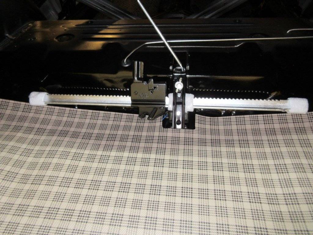

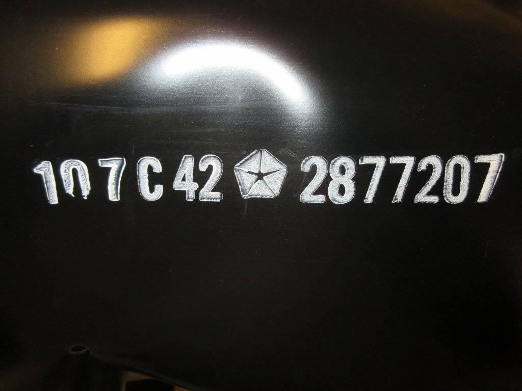

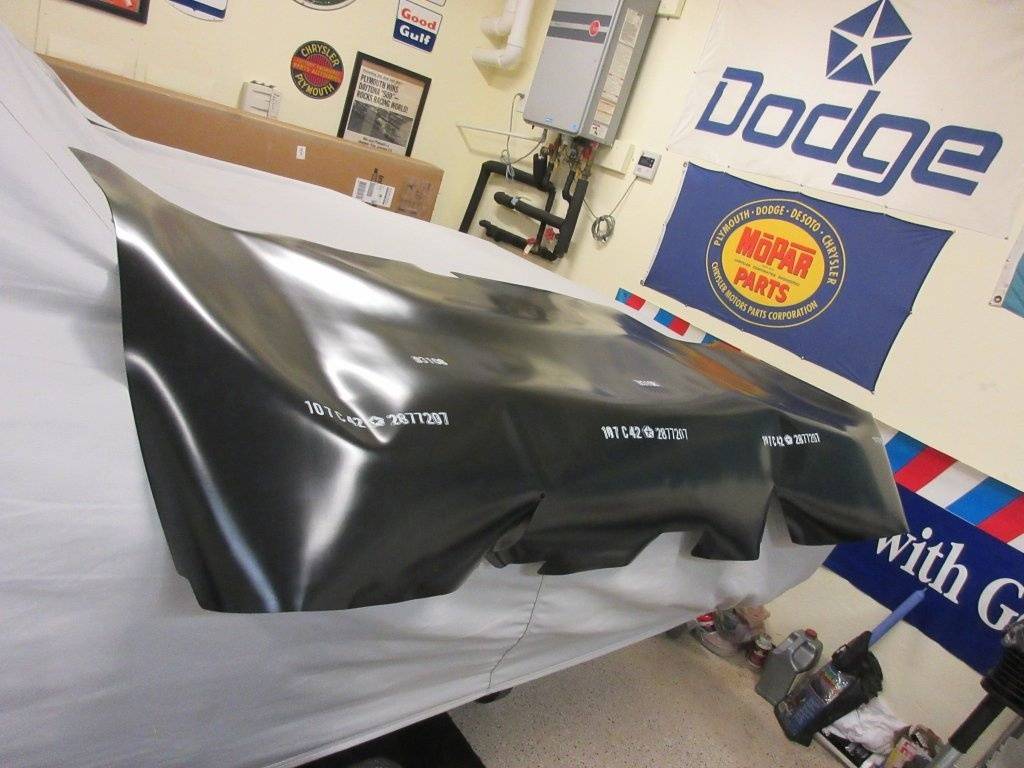

Special thanks to BIG D A12, Darrin for getting me the correct trunk mat and he also did the correct stampings for the pn and date. This mat is beautiful and perfectly done!

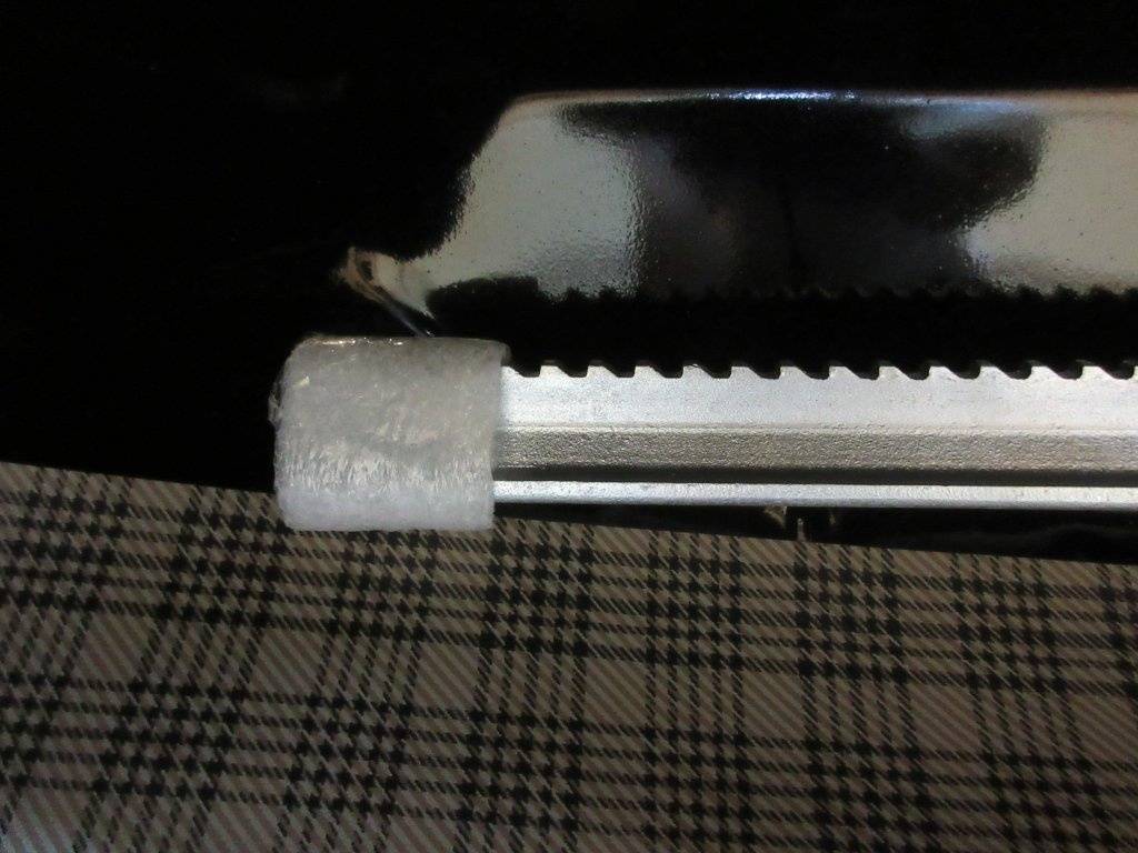

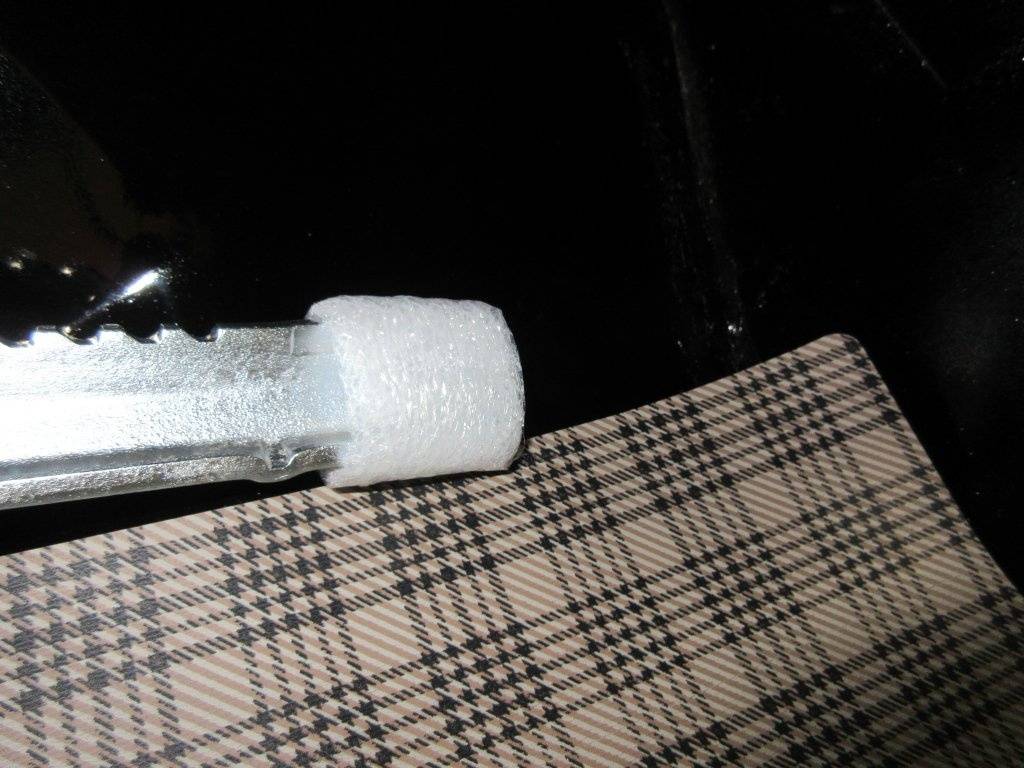

Before any one asks, NO the foam is not correct but is there for protection purposes. The ends are removable and the other is hidden once the spare tire is on.

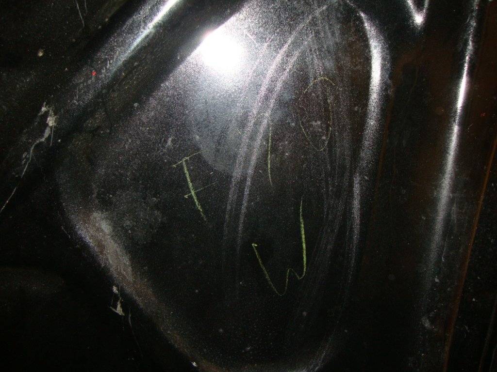

Showing what was left of the jack instruction(residue lol) and the line marking for the tire size and sidewall F70 W....
Placed the jack decal(ECS Decal) on and applied the F70 W via wax pencil but soon will be changed with the appropriate marker. This was a test run before I do the real deal....Which will not wipe off like the wax pencil, lol.....

Hey J, looking good. Did you find the grease pens I sent over the other day? I will have the VR on the way soon.

Looking forward to the VR and will post pics of that when I get it from you!
