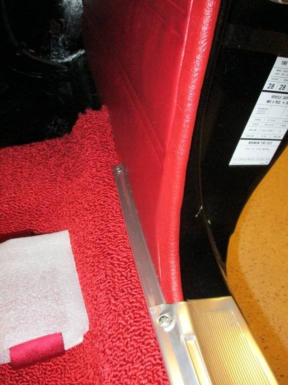

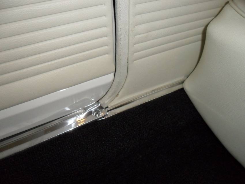

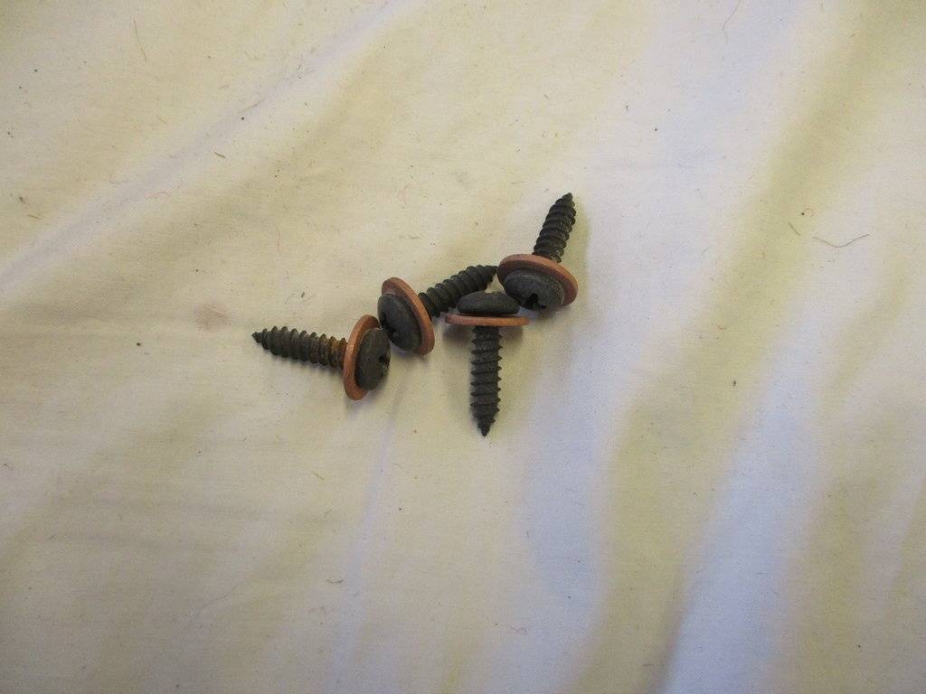

I always wondered how those sill extensions installed. No much on the interwebs about it with photos.
Thanks
Thanks
And then you've got the problem of rust from underneath wallowing out the metal where the screw is supposed to grab on to.
That is a very good point to put out there! Thanks for noting that!
Either could be rusted out or wallowed out from multi removals and installs.....Check every screws holes prior to paint....
Thanks
I have seen them installed both ways.....I had 3 survivor cars and they were installed the way I did above. I tried one time to install them the other way and they did not fit and the key thing they did not hold the carpet down. When installed my way they fit and they lock the carpet down.
Where people make the mistake is by comparing edges and think the thin edge has to go to the inside....
Look at the poor fitment of the pic below...
Versus this fitment

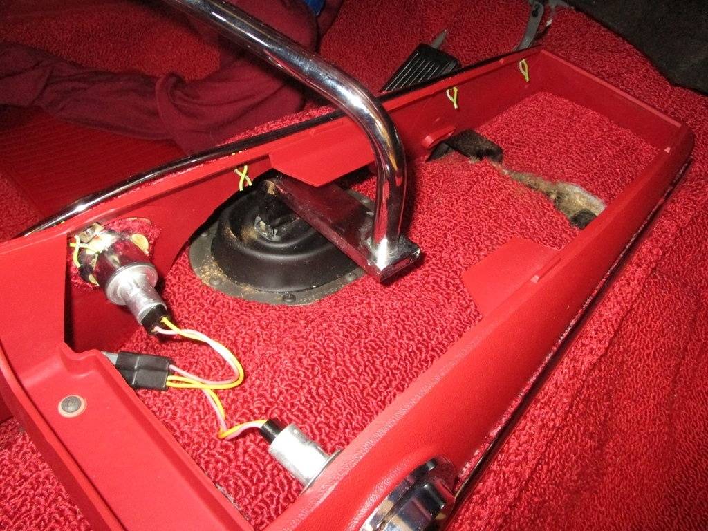

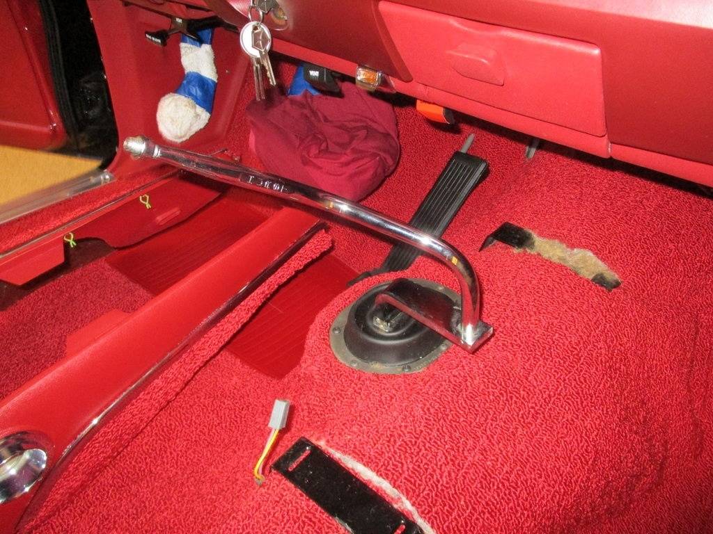

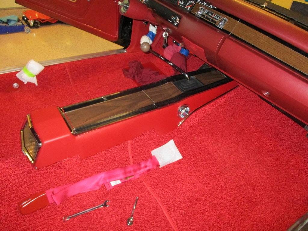

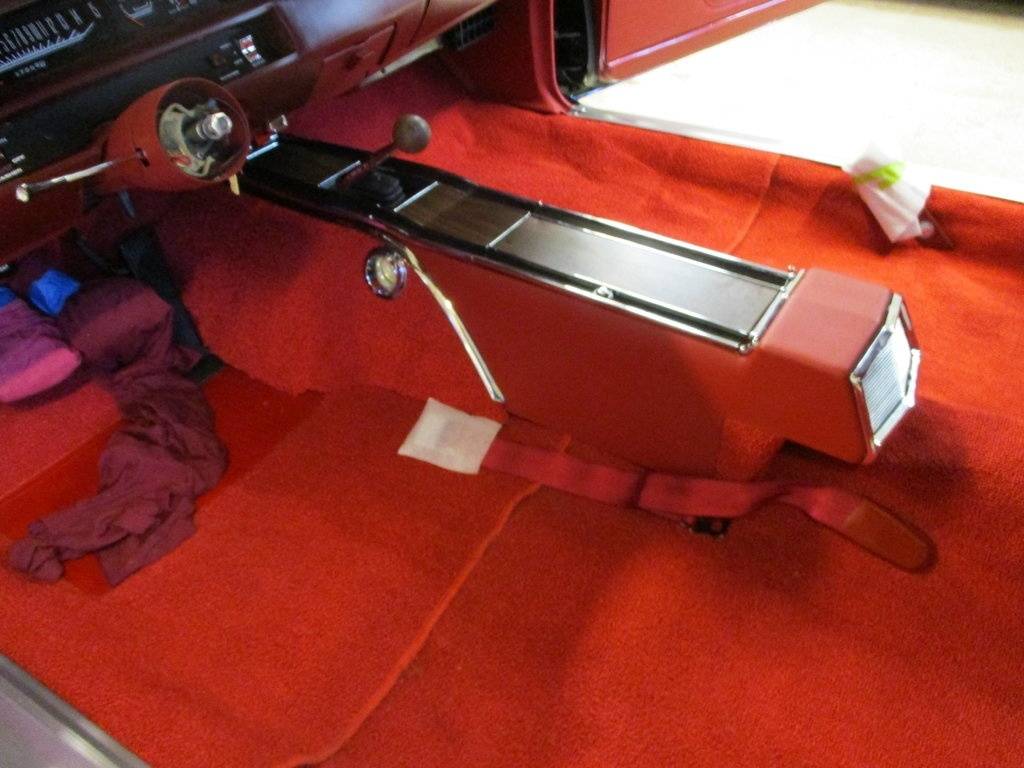

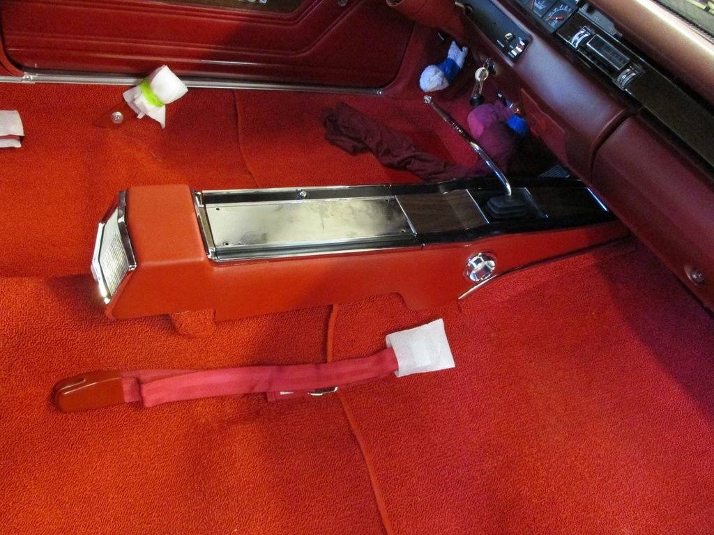

Installing the 4 speed console. Trimming around the hump board was an area in question. At some point in the life of the X the original carpet was replaced. So I could not use that as a reference. I asked a few experts regarding this and they said trim around the panel. I obtained several pics of original units and that was how they were done. If you ask my opinion of how it looks, well it looks like sh## but thats how it was done.

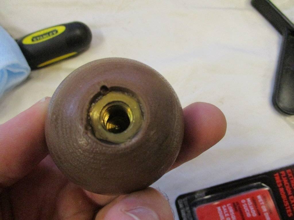

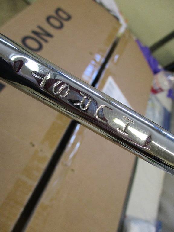

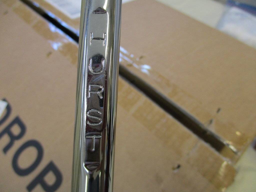

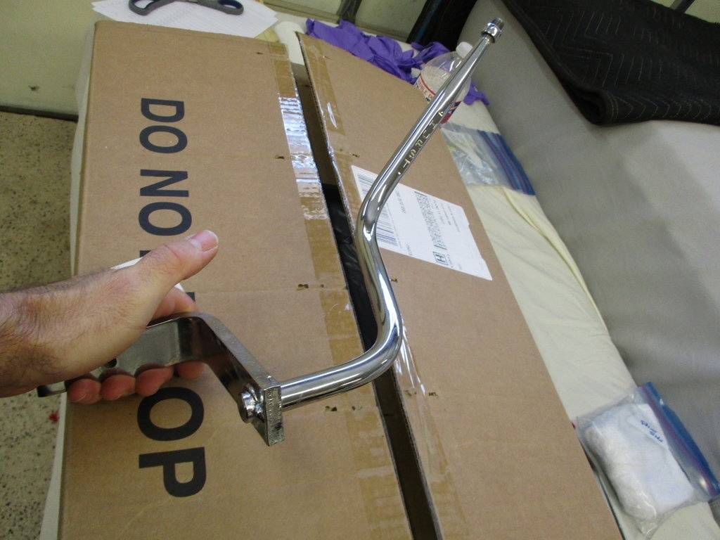

The original hurst shifter was sent to Paul's Chrome for plating. Most do not know but the script on this shifter that is engraved is the early script and the later script was wider on the letters. Confirming an early part for an early 69 build. The handle is the push in type into the hurst unit and locks when placed in the shifter unit.

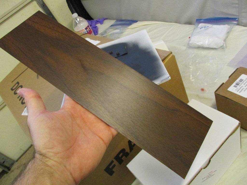

Got the final woodgrain installed on the console compartment door....

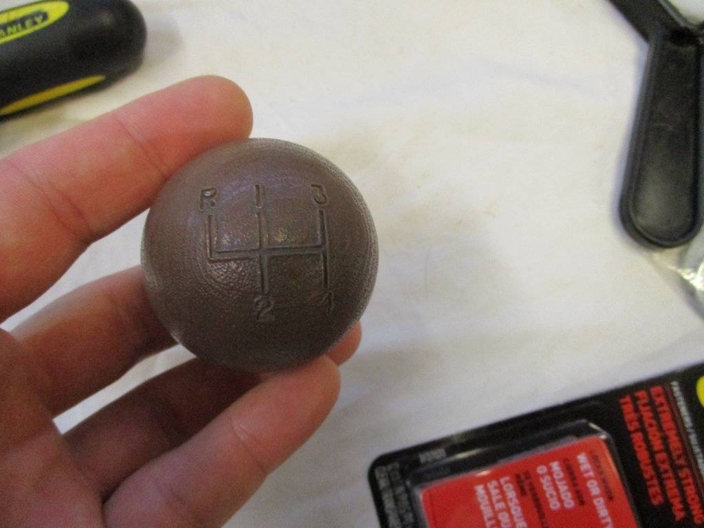

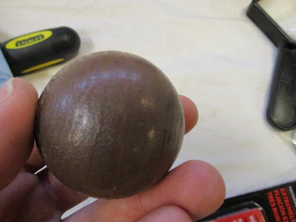

The shifter ball os an actual 69 NOS and thanks to Greg K. digging through his staff for me!

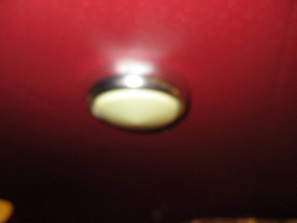

Installed the NOS dome light lens and housing...

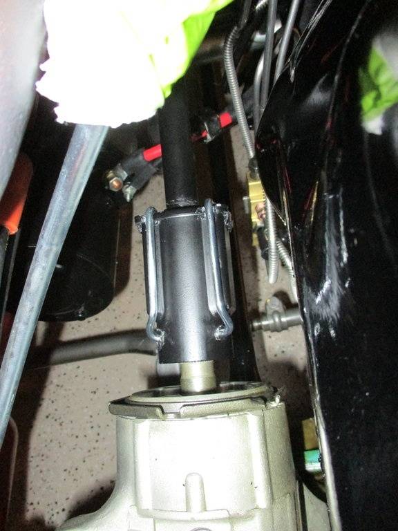

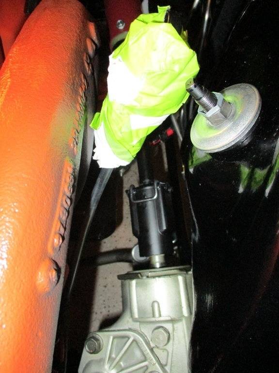

Installed the PITA steering column roll pin and the coupler bracket
Where did you find the clip? I have never seen that before. Must be one of the first things to get pitched?
Page 48. Near the bottom I posted a link...
It was a service fix Chrysler required whenever the column was removed etc...it was not a factory line installed item but it is worth for the added protection..

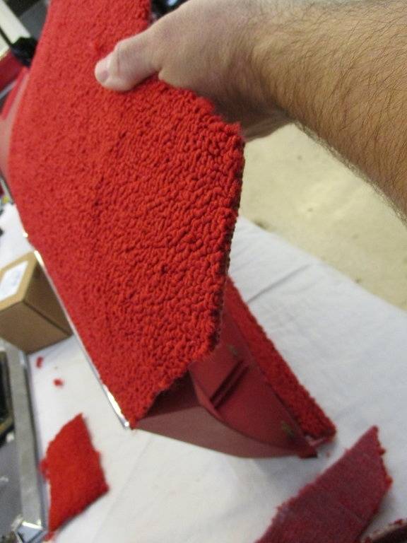

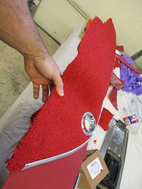

Justin did you cut carpet for console sides from front or from the back?

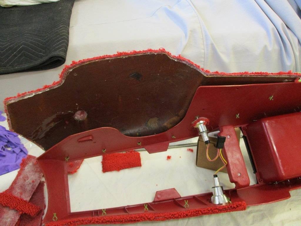

The console carpet was a kit from ACC.....The passenger side required no trimming. The driver side was trimmed just like the two original examples I received from friends with original equipment. It was trimmed out of the car. The pics I have are on my home computer but here are two other examples.
The one above is close but the front extends to far and the bottom front would interfere with the gas pedal. The funny thing is when they posted the console installed they didnt show a pic of the driver side. It is obvious as to why.

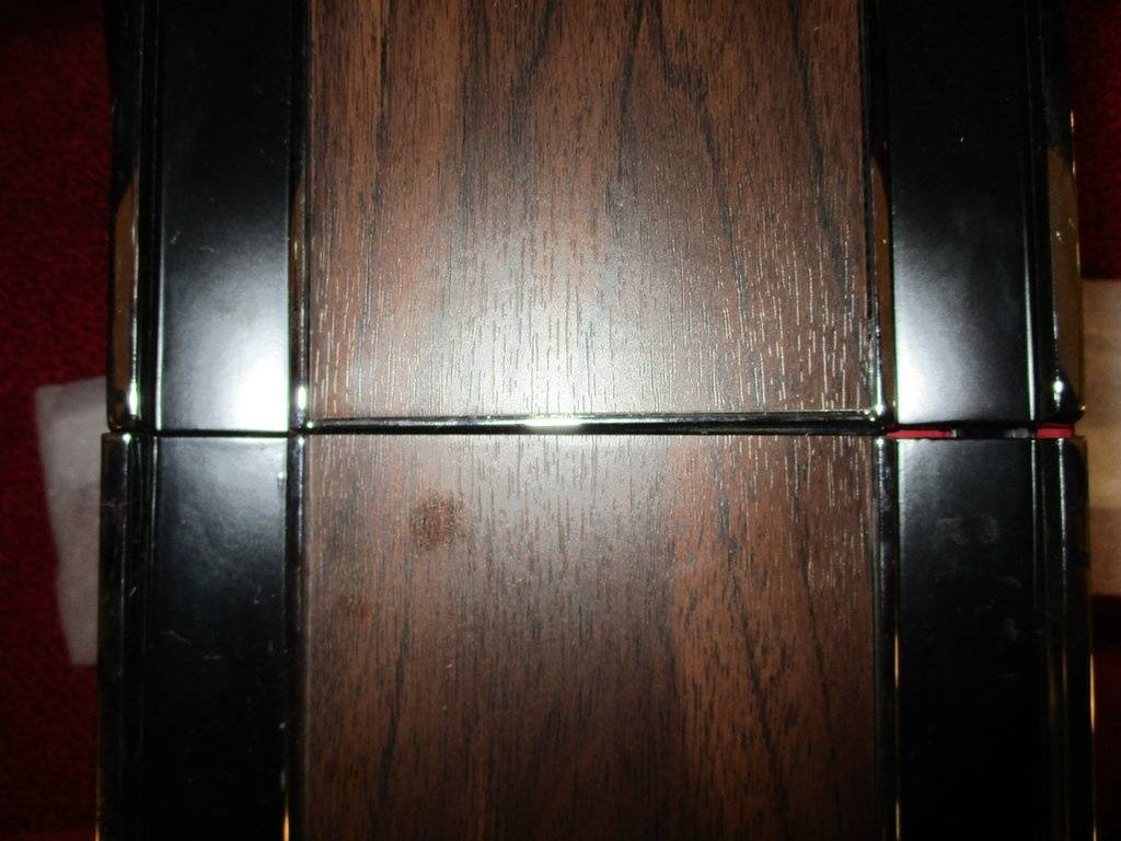

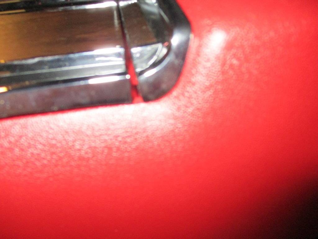

Would you please post a few photos showing the console door alignment with the top plates? Mine is close enough but I wish it could be better.
Thanks
Thanks
Sure, I will get around to that this weekend....They are as good as I could manage...
Did you use a NOS hinge and spring? I bought a re-popped hinge and it pops the door up but I have to lift it open then the spring keeps it open.
Not NOS, it is the original and I got it plated....

Mine was darn near perfectly aligned when I put it all together on the bench. Not so much after the installation in the car. I have new floor pans and console mounts from the previous owner. So, I figure it's as close as it gets without a whole lot more fiddling which could cause the old console to crack.
