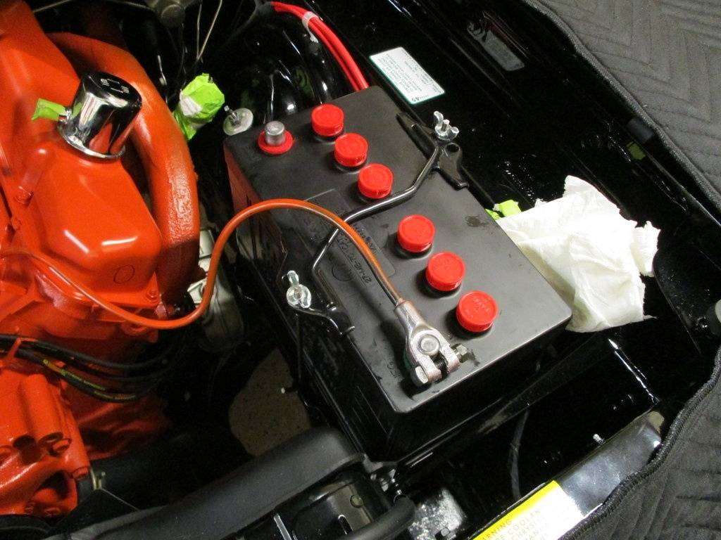

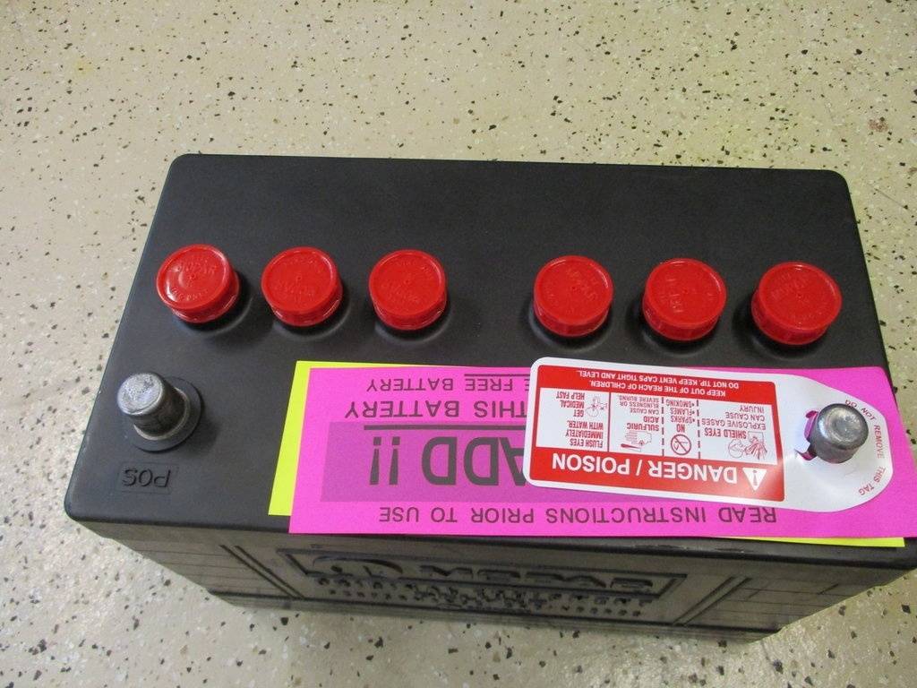

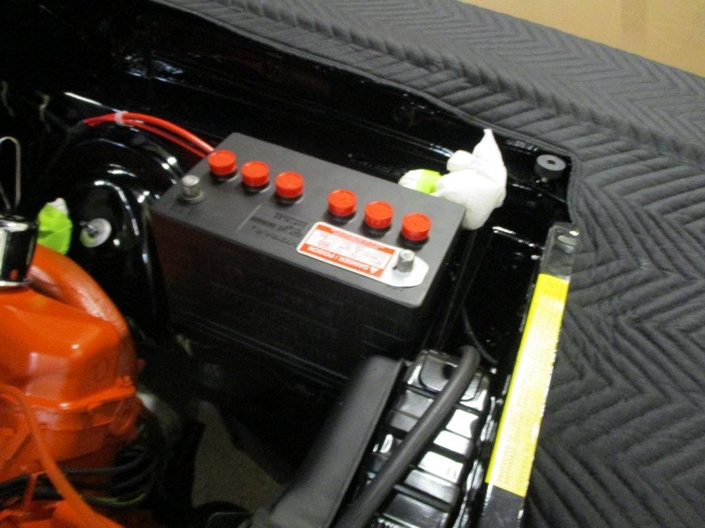

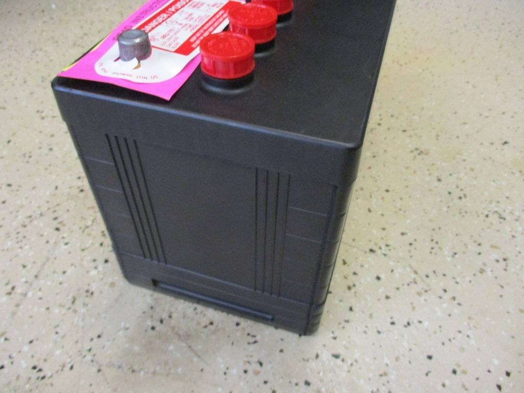

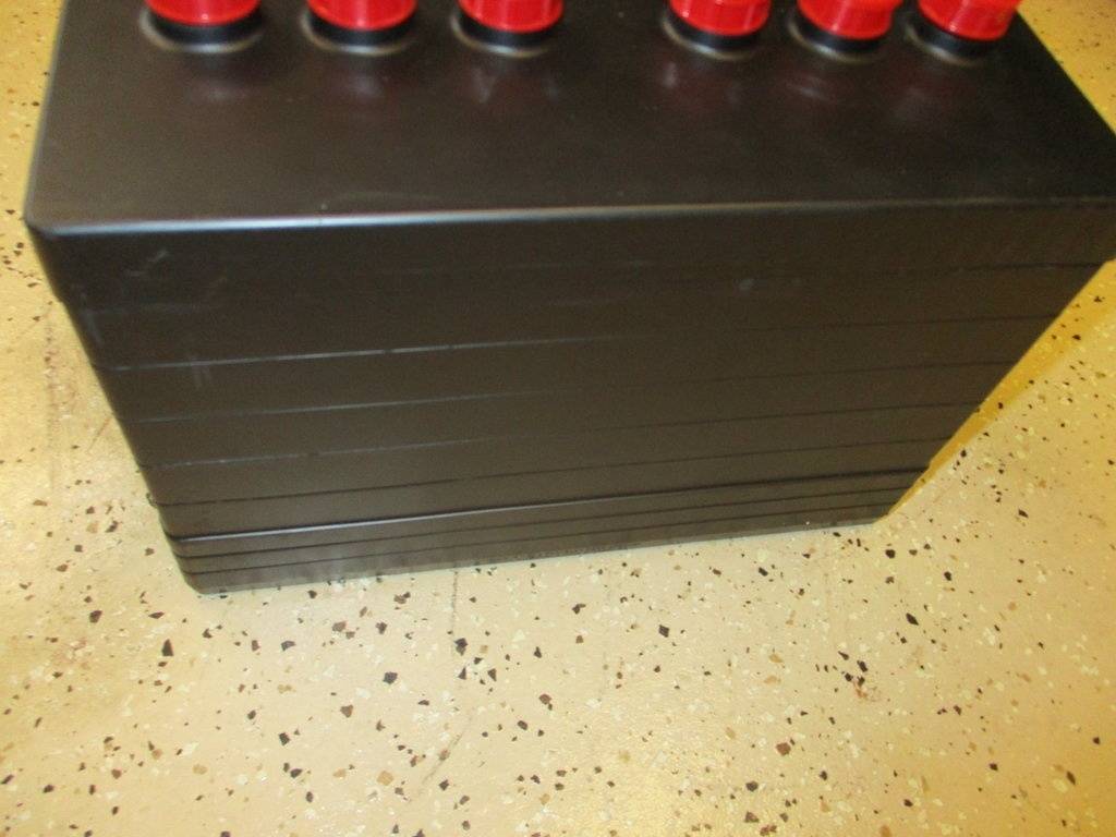

Installed the mopar battery.....
It came from these guys:
http://www.antiqueautobattery.com/chrysler.html#Plymouth

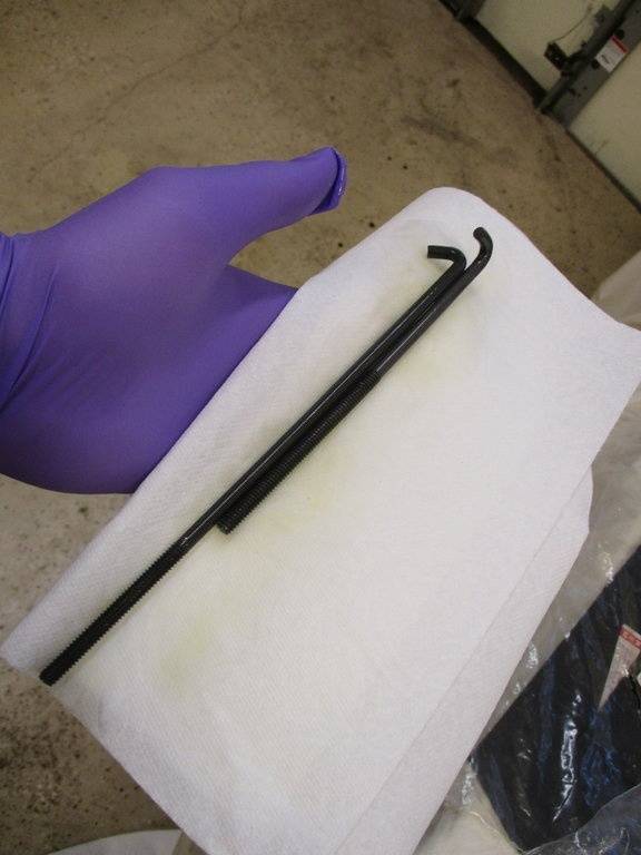

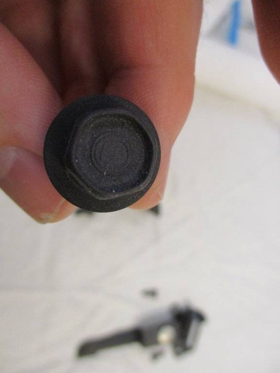

The comparison battery cable bolts are one from Frank Badalson(Left) and the ones that comes with the reproduction cables(Right). FB bolts are 100% correct...

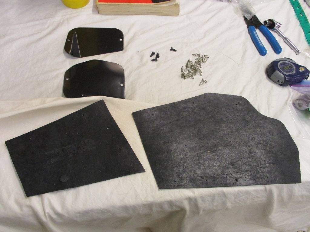

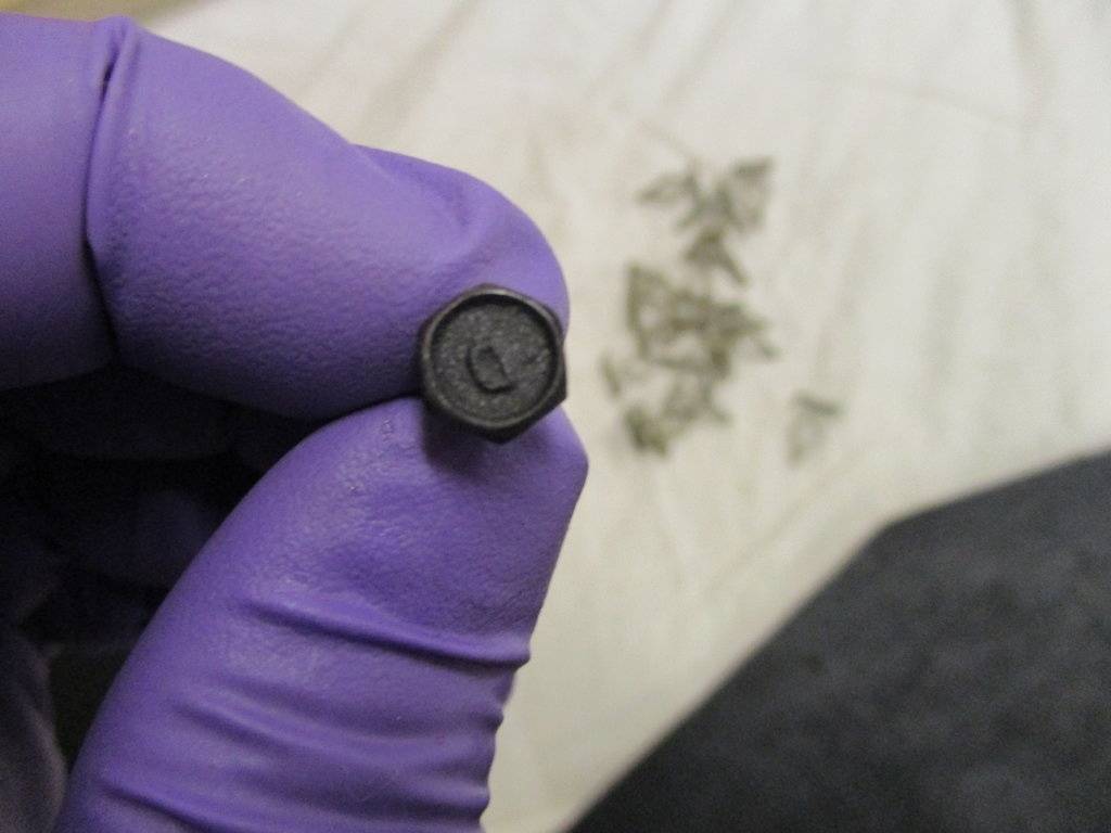

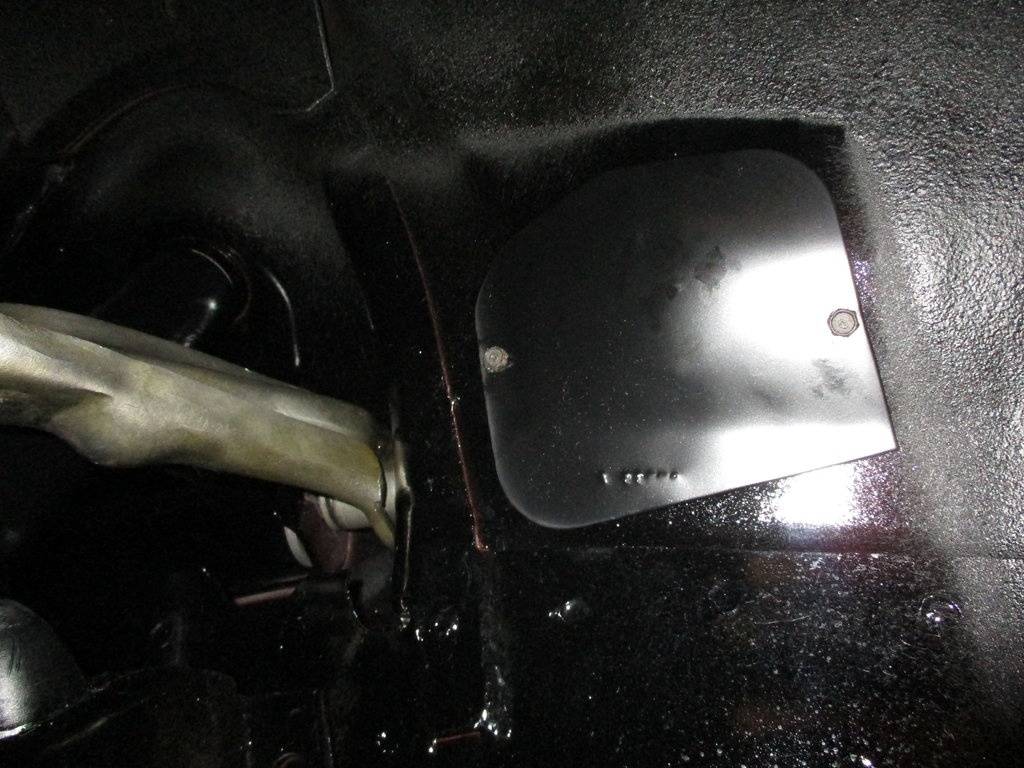

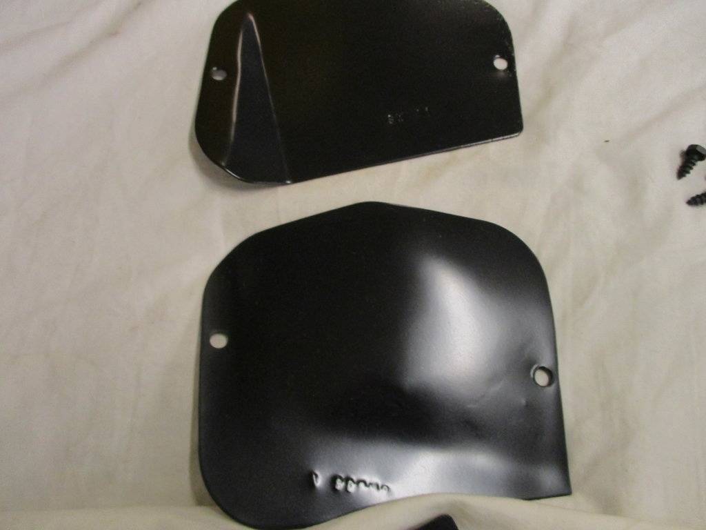

Installed the cam bolt access plates. They are painted in semi gloss black and hardware was black phosphate. The rubber access cover are from REM...

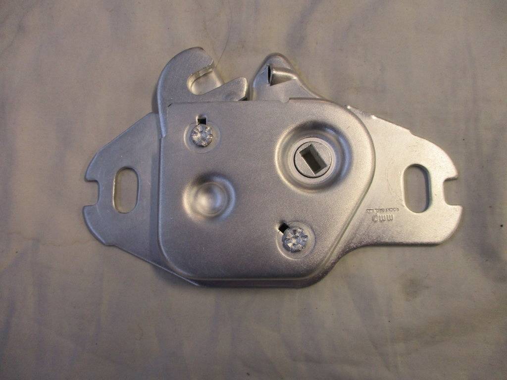

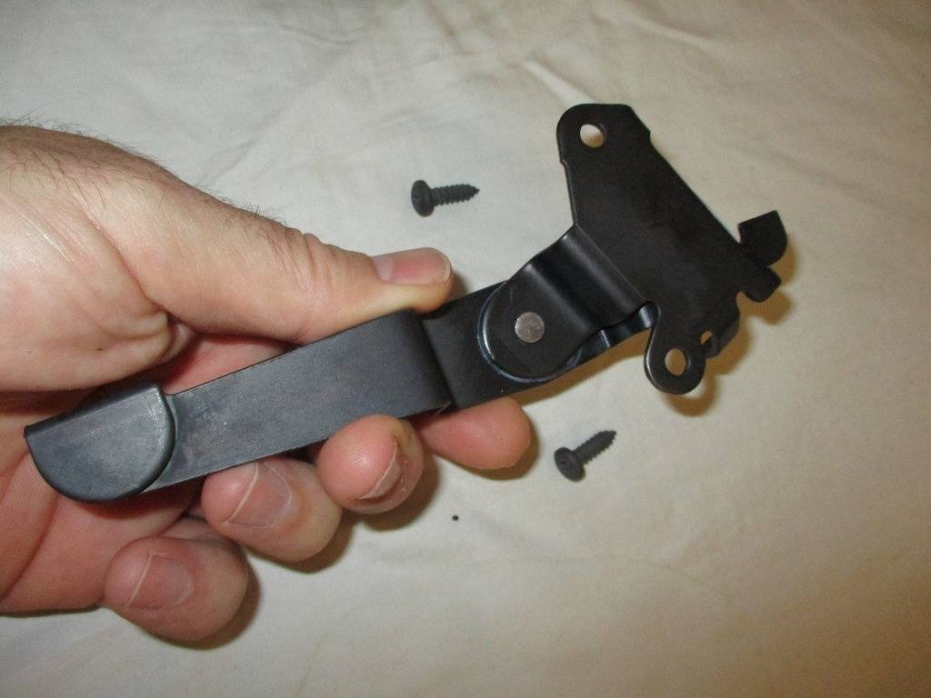

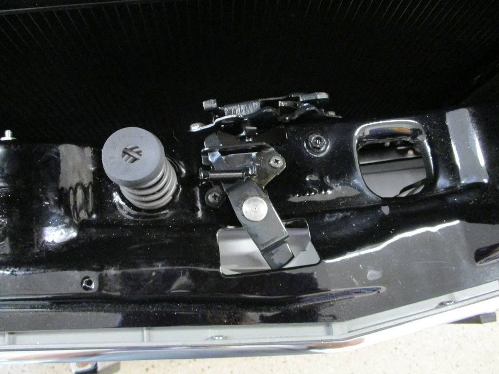

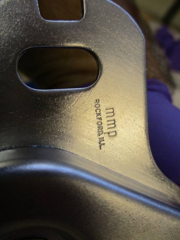

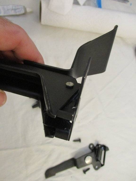

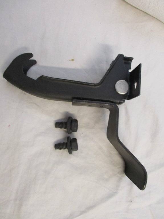

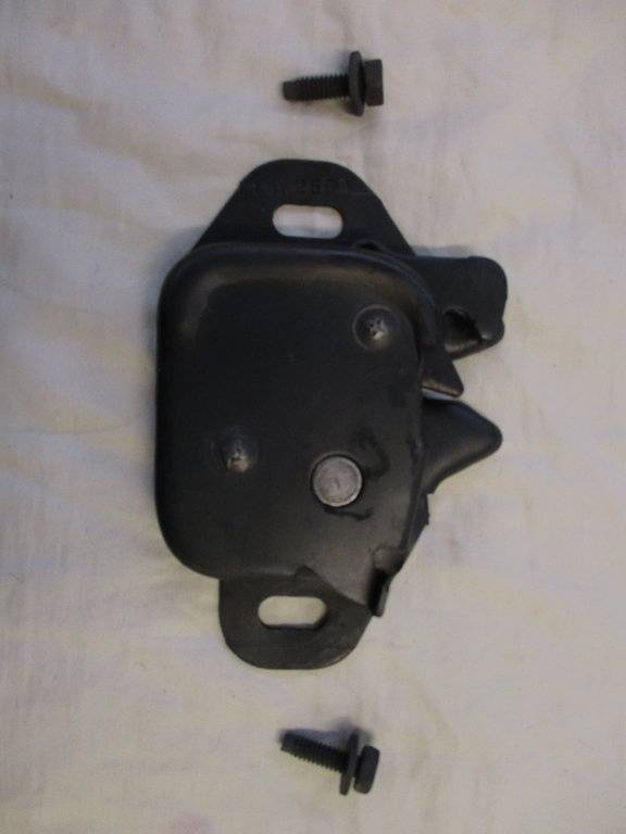

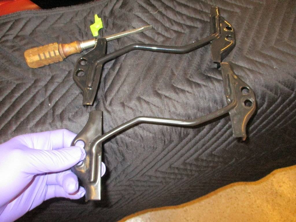

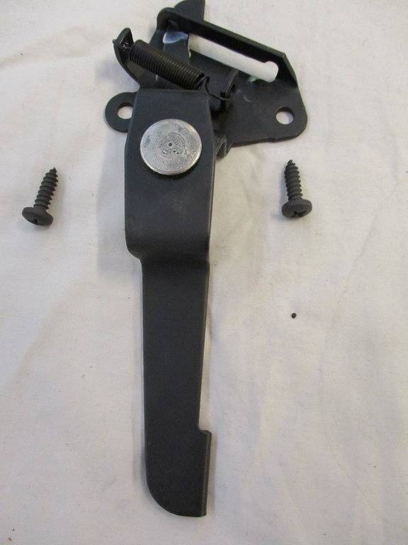

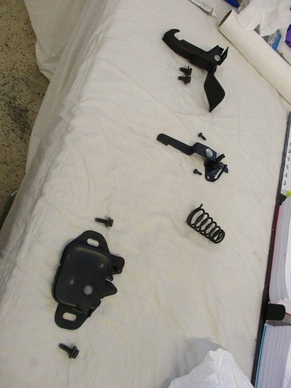

Installing the hood latch/catch, spring and safety catch. All three were restored by Bill Meerholz in the correct finishes and pin's...Hardware was black phosphate...

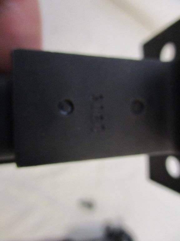

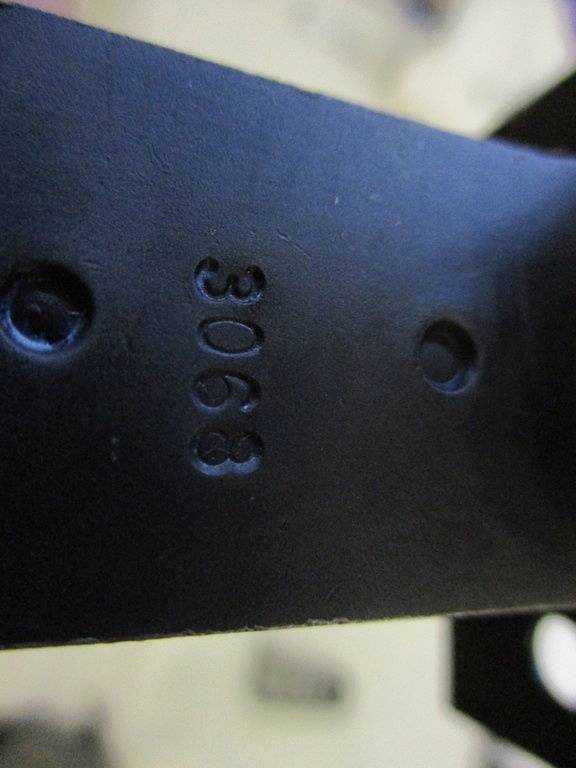

Latch is dated 256th of 68
Safety catch is dated 306th day of 68
###the bolts pictured here are for the latch, the bolts above with the latch are for this, sorry###
Everything fitted up nicely for a factory look....

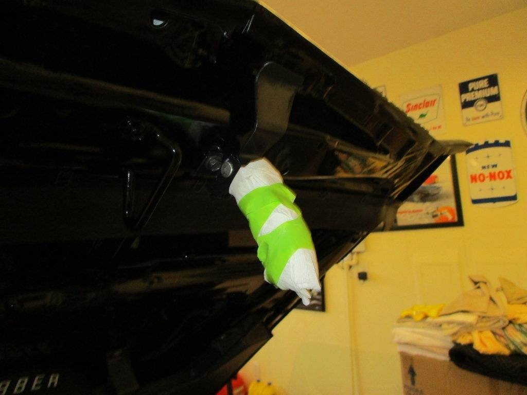

I take a hood bumper and cut some of the guts out and fit it onto the hood spring for protection....

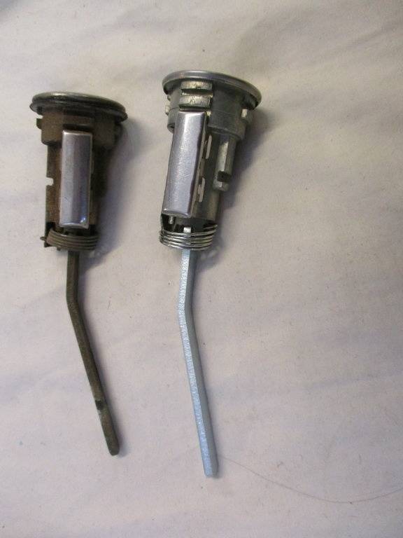

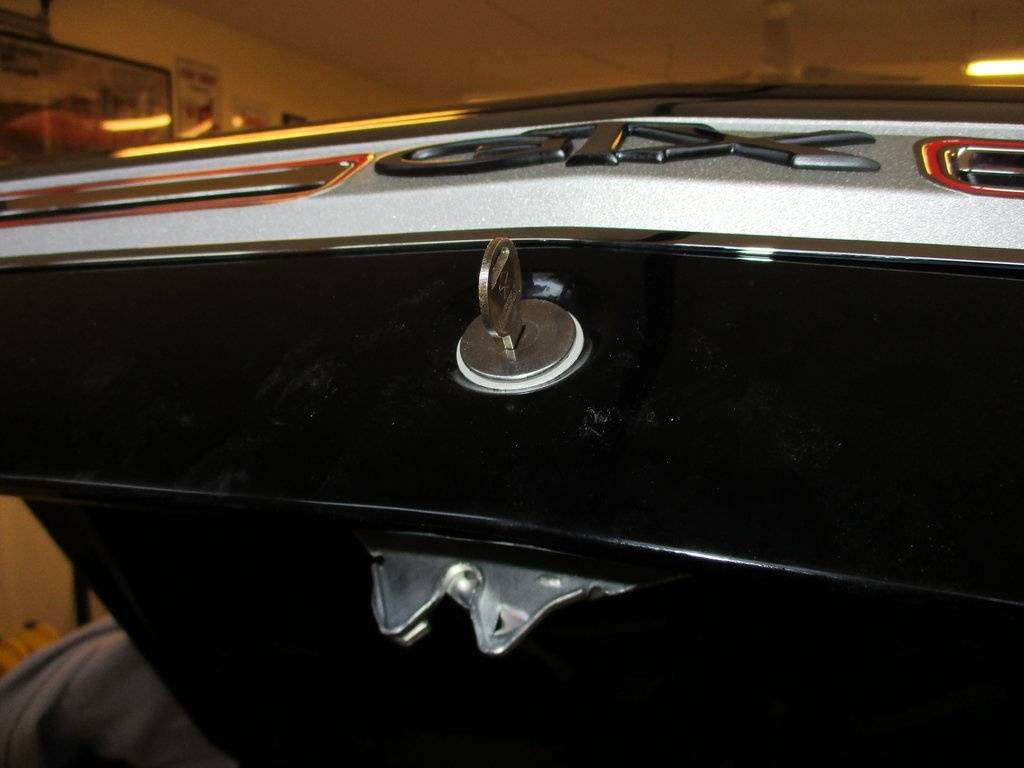

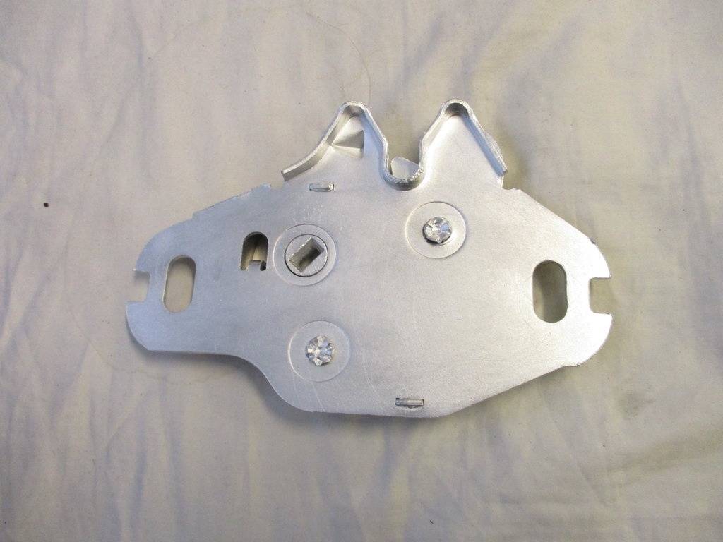

Installed the trunk latch and NOS lock cylinder. The latch was restored by Bill Meerholz and the hardware was painted with the car(as the factory did, or can be black phosphate). Notice the wear on the bolts heads since the latch was put on later to mimic what the factory did. ##the little things count##The catch and bolts was painted with the car like the factory did. I had to file out the lock cylinder opening in the deck lid due to paint buildup and touched up the filed edges. Man the clip that holds the cylinder in place is a PITA to put in. What a tight area to get to. I would have shot a pic with the trunk closed but forget and will have to update.
