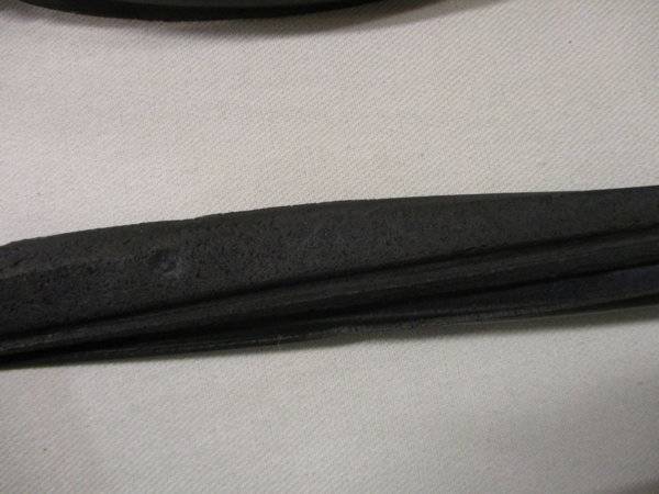

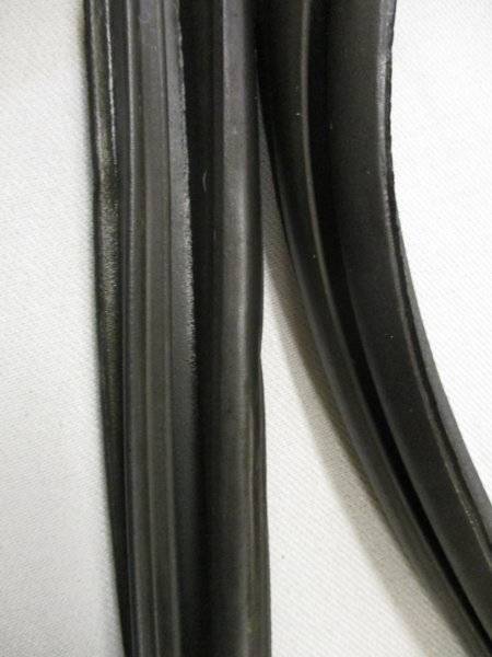

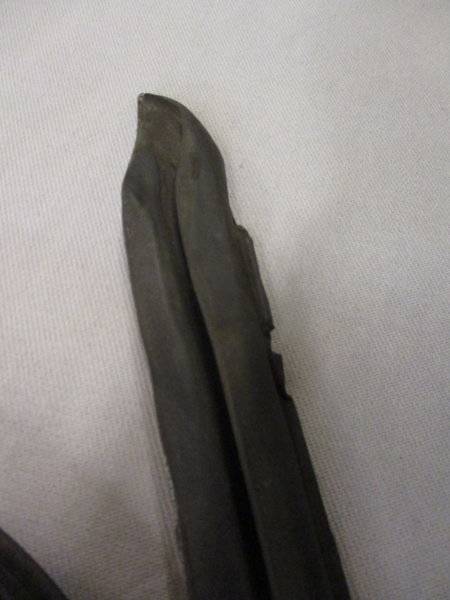

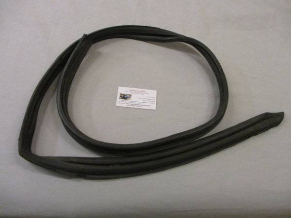

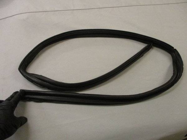

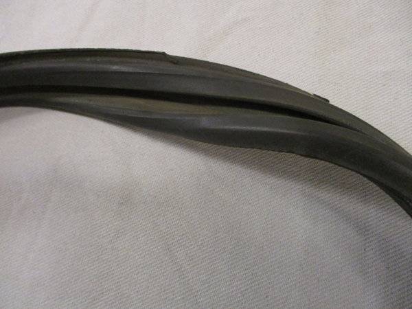

Today I received the Driver side roof rail weatherstrip. This came from a member here Moparparts Don at Wolfies's Cars. I have used Don multiple times for my project for some key parts. He knows the parts extremely well and has tons of parts. I highly recommend him for anything from bolts to parts etc.
I have to give Don special props because he spent a lot of time to find this part amongst the many he had to chose from. He sent me plenty of picks to view and to make a decision on the best one. Once one was narrowed down he sent more pics of just that part. Man I have to say how respectable that is for him to do this because time is money. He is 100% for the hobby and the hobbyists!
Don thanks my friend much appreciated!

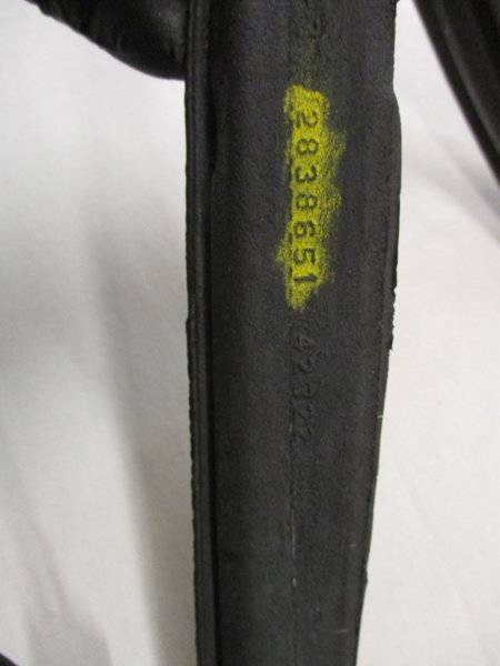

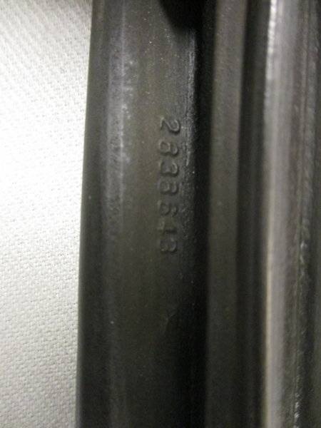

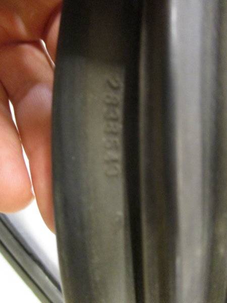

This is actually a used roof rail piece if you can believe that. It could literally be passed off as NOS almost. This is the PN for the driver side. On the top side of the two weatherstrips there is a moulding number as well. I left that out of the earlier post about the passenger side strip. The numbers are different on the "A" pillar pieces and the tails are reversible(but the passenger side has 2 numbers?) when they mated the two together for each side...
Soon I will be putting them on....Anyone want the reproduction roof rails?

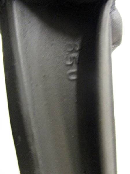

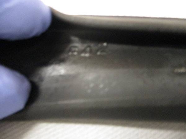

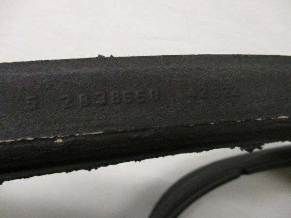

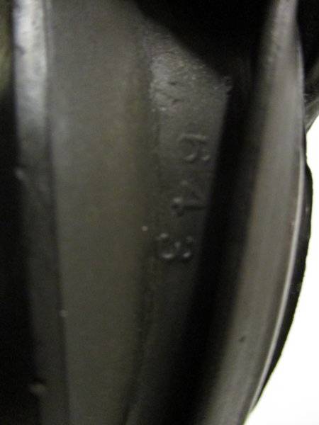

Driver side numbers:
Mould # 2838651
PN # 2838643
A pillar half # 643(equates to PN)
Passenger Side Numbers:
Mould # 2838650
PN # 2838642
A pillar # 650 and 642(equates to mould # and PN)
The passenger side only has 2 numbers on each half.....

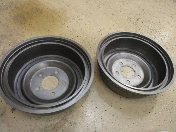

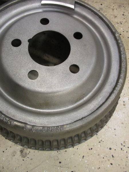

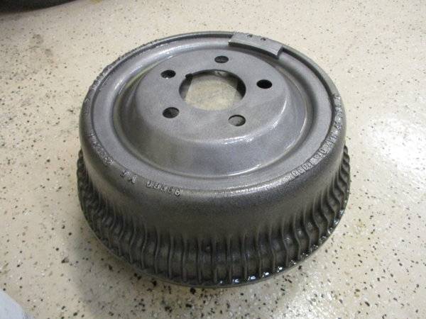

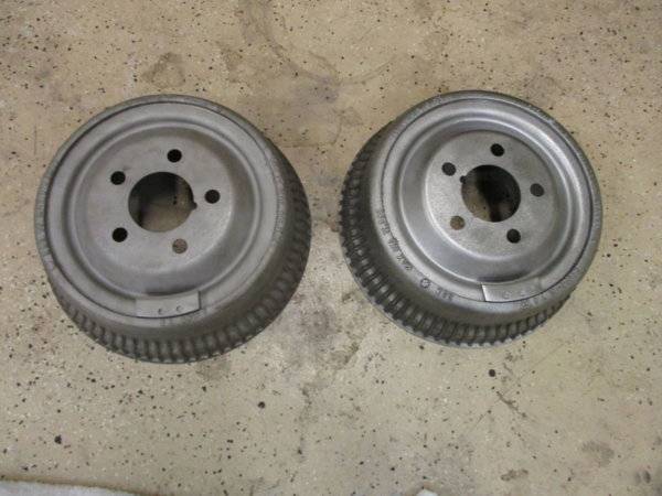

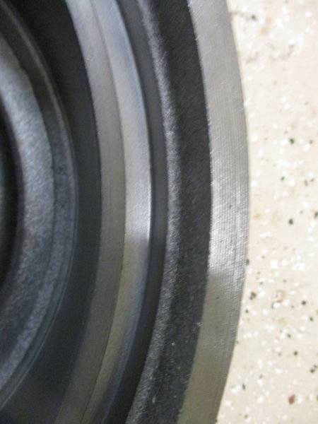

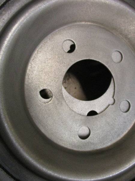

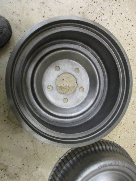

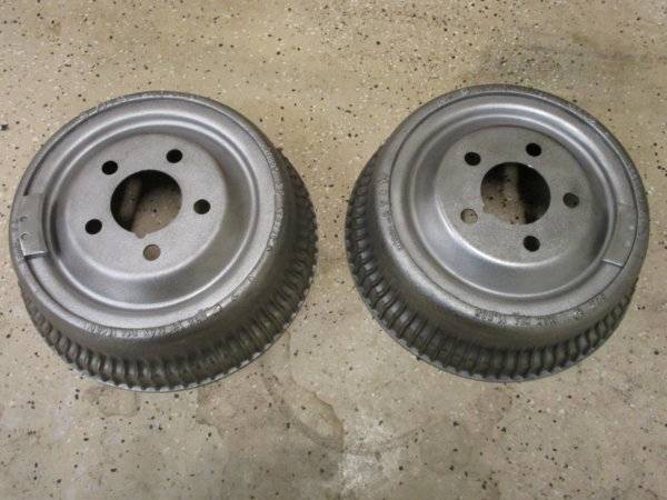

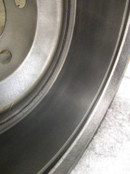

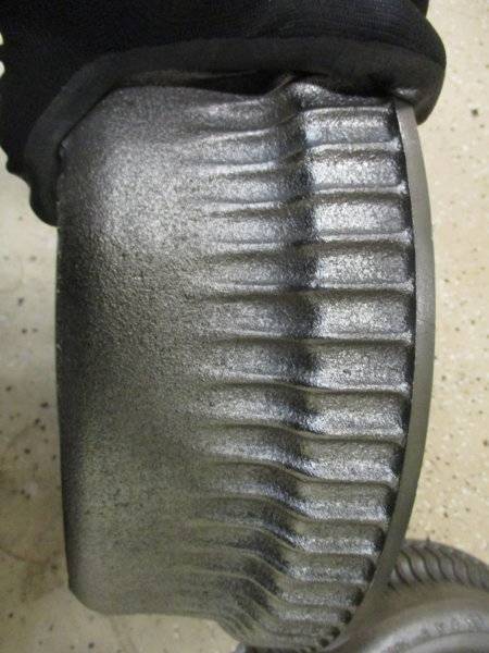

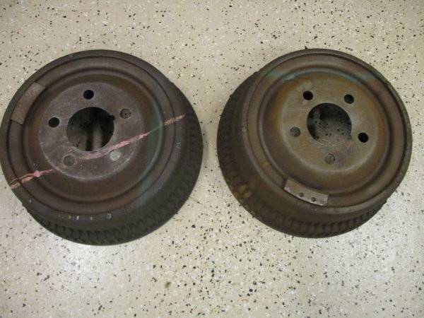

Bringing the NOS drums back to life....The process I use with cast items to get the "cast look" I prefer is as follows. I use two methods. One involves phosphoric acid and the other process uses glass beads....It is too cold right night to acid dip because I dip the part in a container outside and not inside then remove the part and douce with baking soda, then wash with ammonia and last wash with soap and water and then mover to the last process....The finishing....

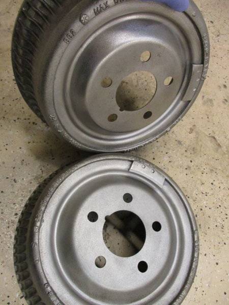

So the glass bead process was utilized for these....I use very very fine beads and blast at a low pressure and it took about 3.5hrs to blast these drum. Reason I do this I do not want to remove any other the original casting looks and features. The next step is the finishing I referred to above. The wonderful wire wheels and a high powered drill. So I go over the whole drum with the wires wheels and polish up. They get very shiny as you can see....Then I shake them with lacquer thinner and wipe and wipe and wipe...Ohh and wipe clean...cast iron is a PITA to clean up....

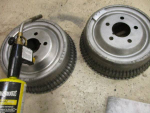

The main parts of the finishing look is polishing and the heat treatment...I take mapp gas and heat up the drum a lot....this brings out the impurities and removes the shine....resulting in a near cast look. If you do this move the heat around and do not focus in one spot you are slowly heat the metal up to hot...watch the change as you go and stoop when you got the best look....

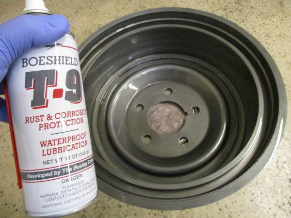

With the drums warm but not hot I apply Boeshield T9 and that finalized the cast look giving it the "grey" appearance....
ohh on the shoe surface I polished that up with a red scotch brite pad....
After 48 hours applying Boeshield T9 daily I will put the on the X!

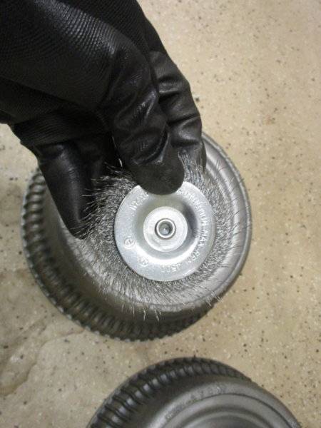

##pics below are of the blast and then polish##
Thats one worn out wheel lol

Oh, and those are the nicest set of brake drums I have ever laid eyes on!

Thanks for the compliments on the drums....this time the wire wheel lost:D
