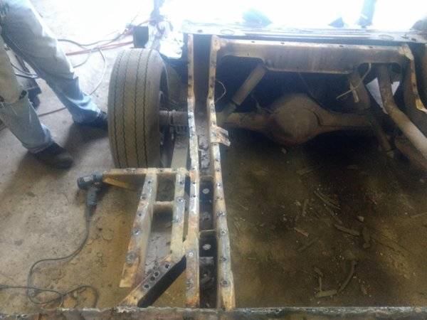

Hi everyone, I'm curious to understand why these b bodies are literally eaten by rust.
Since I have the chassis disassembled on the rotisserie, the question is this:
can I make some improvements, at the bottom level or something else?
Thanks in advance
Mine was under coated, still had the factory paint underneath. You probaly have a car that day in the elements for some time. Plenty of improvements to be made, frame connectors and torque boxes to name a couple.
A big improvement is to treat the inside of the frame rails with POR15 or equivalent epoxy sealer before you close them off with new trunk and floor pans. Even cars that where undercoated from the factory have issues with rusting frame rails. The reason is that the interior side of the rails were raw steel and as the trunk and door seals fail water would get into the floors and trunk and then seep into the frame rails from the top. eventually over time the trapped water would corrode away the raw steel from the inside out. By treating the frame rails internally and then adding undercoat you have doubled your level of protection. That being said, unlike when our cars were purchased new, most of them do not see daily use these days so will already have one up on their post factory life.
I agree with 1967coronet440 & aeon280. For frame connectors, the US Car Tool full length, weld-to-the-floor-pan, need some trimming (expensive labor for sure to install) seem to be the preferred frame connectors...BUT, any old bolt-on (weld them though) frame connectors will work. If you decide to add torque boxes (I suggest them), AND use frame connectors, have them put on at the same time. My bolt-ons (welded) interfered with the location of the toque boxes on the rear frame rail, but it was no big deal (grind a little metal) for the welder when the frame connectors and rear toque boxes were installed at the same time.
And yes, coat the frame, inside it too. IF you can't get to some locations inside the frame rails, hose them down with WD-40 or other oil-based lubricant (after coating of course). Oil prevents rust too, but doesn't last as long as a real "coating"
