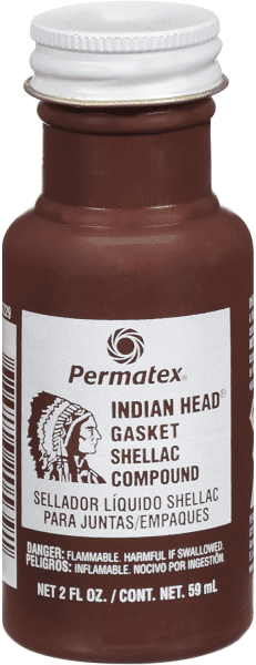

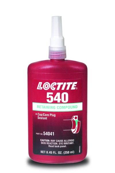

You will still have leakers with the 3M and Indian head products. It doesn't have proper lubricating properties for "Core Plug" installation so the plugs gall and create paths that will leak. Also, those products do not seal a bad block "Core Plug" hole effectively. RTV of ANY kind is not the correct product to use on "Core Plugs" and will not seal them correctly. I used to have leakers ~30% of the time until I started using Lock Tite 540 which IS a "Core Plug" sealant and was designed to aid installation of the plugs and sealing imperfections in the parent bore. You have to get the plug installed because it cures fast. Wait about 5 minutes and tap it with the hammer and it sounds dead solid as the sealer has cured. This stuff is awesome, but it carries an AWESOME price! I can only find it at one place and they get $200 - $300 for a 250ml bottle which seems to be the only available size. So, I get that regular people are not going to run out and buy some, but was just passing on some experience and advise on this issue...

The lettering and pic of a bearing alluding to it being a "Sleeve/Brng retainer are misleading to say the least. The text says that it is a "Cup/Core Plug " Sealant, and is actually a blue liquid and not green. Just info for ID purposes...

Good info. It's cheaper at this site, but still pricey. LOCTITE 540 Core Plug Sealant, 250 mL Bottle, Blue (1/BO)
