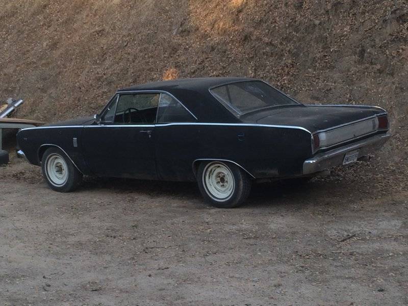

Not so easy with the Dart since the front wheel opening is so high and the rear so low...

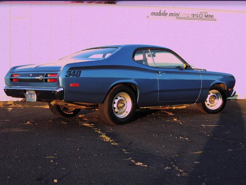

The Duster is even harder to get there:
