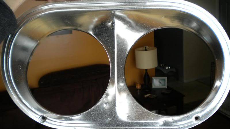

I finally got done (mostly) restoring the aluminum headlight bezels on my Fury. The process was interesting as this was my first time attempting a resto like this, but below are the before and after pics...
Before (pitted and oxidized):

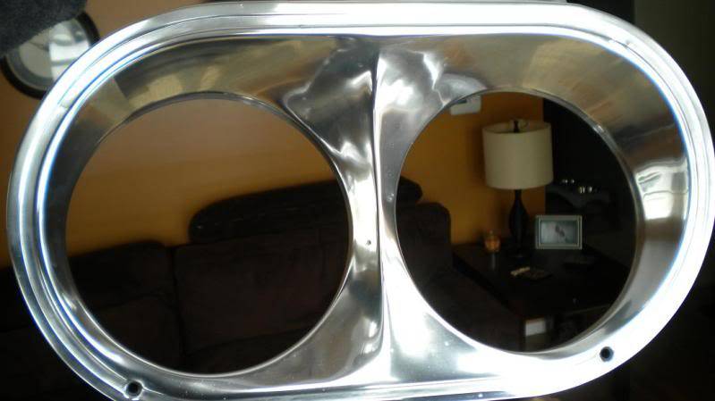

After:
Process was dry sand with 320 grit, wet sand with 400, 600, 800, 1000, 1500, then 2000. I then used 3M rubbing compound and finished it off with Mothers Mag/Aluminum Polish.
Only question I have for those of you who have done this before...how do you flatten out the dents from rocks, etc...? I don't have any small bodywork hammers so any advice is appreciated.
You gotta tap them from the backside using whatever will fit, and be gentle, that aluminum will dent if you look at it wrong. Then start the WHOLE sanding/polishing process again. It took me a month to do my grille anfter I converted it over to a superstock (single headlight), and it wasnt too hard, just time consuming.
Cool, thanks for the info...I'll have to see if I can find some sheetmetal/body-work hammers and get to work. Time consuming may be the understatement of the year haha...it took me about 10 hours to get that housing to look the way it does.
The pictures are actually of the left and right side, I forgot to take a picture of the RH side housing before I started the process, but it was just as bad....just not as many dents as the LH side.
Much appreciated, this was my first attempt at refinishing aluminum so I was hoping for the best..I must say, I was VERY nervous about sanding aluminum with such a coarse grit initially. I was astonished at the results, minus the dents but those will be fixed eventually.
On a side note, does it look ok with the ring around the bezel being polished or should I paint them black like they were OEM? My car is flat black but I have removed ALL black accents from the front and rear aluminum so far.
