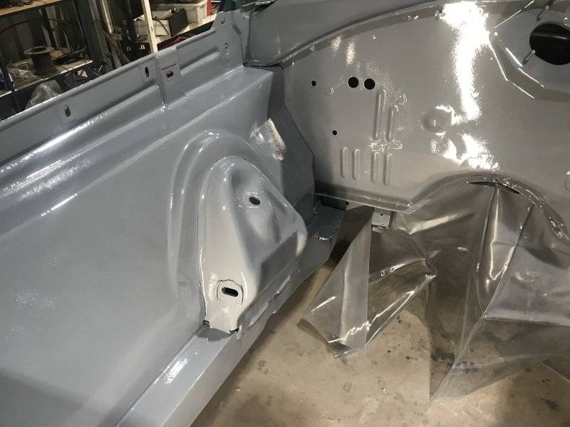

This is my first attempt at body/filler/paint work so I don’t really know to much about it all.
I’m smoothing out the engine bay on a 69 coronet and have done the metal work, sprayed with epoxy then done the filler work. Once I got the filler down I blocked it with 40 and then 80. Then sprayed primer filler, blocked it with 120 then 240. Still have 400 to go and then was going to hit it with another filler primer.
My question is was I meant to sand the epoxy with a finer grit before I sprayed the filler?
Please let me know if I’m meant to add more steps in.
Also do I spray again with epoxy after the filler or is it sealer?

Thanks. Forgot to mention that I scuffed it with a brown scotch brite pad.
It came up due to me reading a post on another forum that If you didn’t sand the epoxy prior to filler primer that scratches would show up.
Cheers Doug.

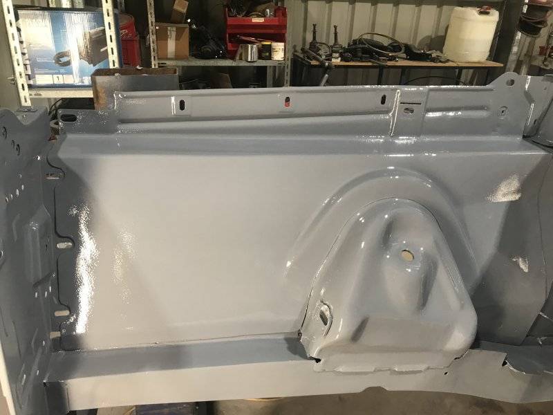

look like glass! You've already done the hard work.View attachment 1336202
It came out like a bloody grey orange haha. I will have to play around with the gun settings a bit before the top coat. Yeah I did remove the peel. Really gotta find out how to spray flat. Save so much time. So go up to 600 on the primer filler?
Yes, since B5 is a metallic. To make topcoats lay down flat, use an HVLP gun with about 30psi
and thin it for multiple coats. If you atomize the paint very fine, it will be nice.
