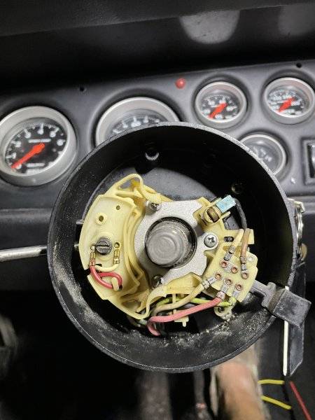

I got back on it this morning, removed housing and cleaned everything up, went through bulkhead connector to ensure all pins are set. Still the same, parking light works fine, flashes with four way but will not flash (verified no power at bulb) with turn signal. You can hear flasher clicking and rear tail light is blinking.

I'm yanking the wheel tonight, I'll let you know how it goes. This is my last discrepancy I need to fix before I make this 6 hour trip to Carlisle in a few weeks

Holy crap that was it! Easy fix, thanks to everyone for your inputs, I'm ready to hit the road.

I have same trouble as y’all , I’ve pulled the wheel , do I unplug , and remove turn switch?
You shouldn't have to remove entire switch, mine had just enough slack in wire harness to pull it out just far enough to adjust small brass tabs, wouldn't hurt to clean them up and re grease with dielectric grease.
