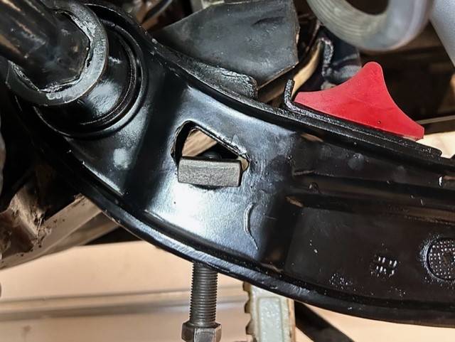

See the adjuster bolt hanging down in the photo? Yours won't be out that far but at least you can easily identify it.
1. Jack the car up off the k-frame to take the weight of the wheels.
2. Tighten the adjuster bolt a few turns to raise the front end. Do both sides of car.
3. Put the car back on its wheels and roll in back and forward a few times to settle it.
4. See how you like the height and repeat as required.
Depending on how much you raise the front end you may need an alignment. The camber will definitely change when you raise the car (increased positive camber).
