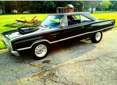

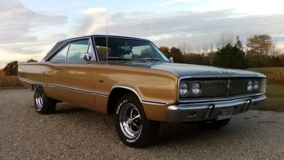

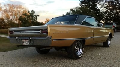

I would like for my wheels and tires to come out farther on my '67 Coronet (they are in way too far compared to rear). I'm currently installing QA-1 Upper and Lower Control Arms and a Pirate Jack's 11" disc brake kit. (Not that this matters). I'm running 225 70 15's on 15" x 7" Magnum 500's. On the rear I have 255 60 15's on 15" x 8" Magnums. The only option I can think of are 1 1/2" to 2" wheel spacers. Any other thoughts out there? And if I did go with wheel spacers, what style, brand, hub-centric or not,etc?
The photo from the rear shows it best.
Thanks all, God Bless!

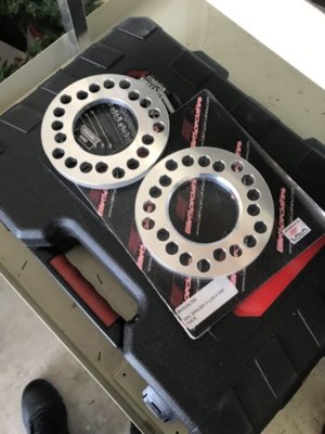

I have a nice set of new .5” billet spacers of you are interested. 1.5-2” might be a bit much.
I kinda dig the tucked in look on the front. Gives it that raked look I don’t think you want them sitting all the way out even with the fender. Also with spacers that 1.5 to 2” you’ll most likely have to change the wheel studs.
I'm not sure 1/2" would be noticable, but I will consider yours. Great looking Coronet BTW! Looks likes it's ready for the strip!
