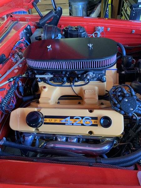

EFI fuel lines don't need to be as big as carb fuel lines. 3/8 will be big enough for your engine as long as you are running 60 psi of fuel pressure.
I am running the Fitech dual throttle bodies on my 446" engine. Using 3/8" feed and return lines and a 255 lph in tank pump. Maintains the 58 psi required. Street use only...
