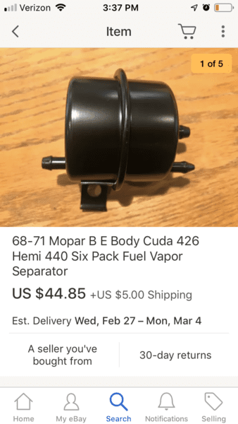

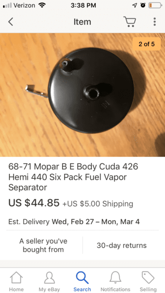

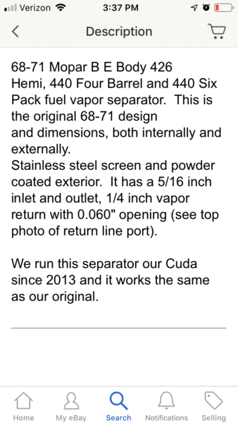

Here is a replacement VB on eBay. The 1/4” hole is reduced to a 0.060” hole. Mystery solved!
the aftermarket vapor seperators have too large of a return orifice. I clean the paint off the return nipple and soft solder it up; then re-drill to around .030". these are filters as well as vapor return. too large of a return orifice will definitely bleed off too much pressure.
You were correct!! Thanks!

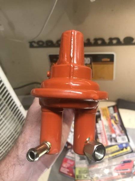

One last question. I took this pic from an episode of graveyard carz last week of the separator. Does someone sell that 5/16” fuel pump output hard line? My spectra hp fuel pump has the same orientation, but the threads are 1/8” npt and there is an inverted flare on the inside.
View attachment 732984 One last question. I took this pic from an episode of graveyard carz last week of the separator. Does someone sell that 5/16” fuel pump output hard line? My spectra hp fuel pump has the same orientation, but the threads are 1/8” npt and there is an inverted flare on the inside.
you can get those fittings at any parts store that sells brass fittings. 5/16" female inverted flare with 1/8" male pipe threads.

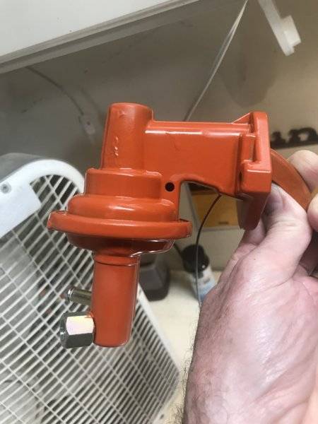

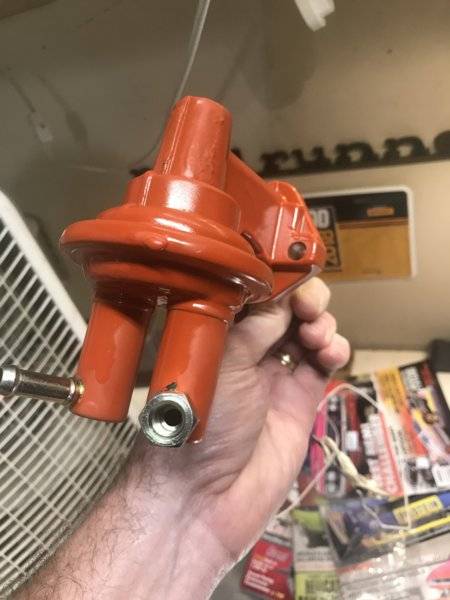

When I look into the hole, the flare (pointed part) points into the pump (away from the fitting) like in needs a male flare adapter to go in there first.?
Post a pic of your pump. Stock they normally use a parallel thread and a double flare on the pipe.
By the way NPT is a tapered thread that is designed to lock and seal on the threads alone.
I have seen it on aftermarket pumps and in that case you would use an adaptor fitting to convert to a pipe/nut style fitting.
They should be easy to get. That steel tubing is called Bundy tubing.
It is a bit hard to see. It looks too fine a thread and no taper to be NPT but not sure. I cannot identify that thread but I suggest you do. Once you identify the thread you have something to work with.
I think that taper at the bottom of the threads may not be a seat but is from the drill used when the fitting was threaded/manufactured.
That pump would need the adaptor fitting in my opinion.
