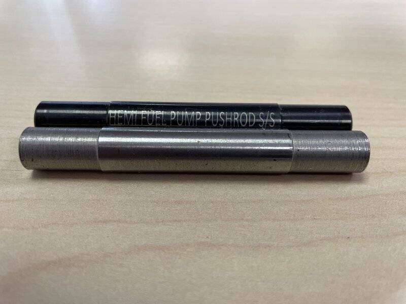

fuel pump pushrods
Hardness is only one material quality and not representative of good or bad with these. If the maker didn’t select the right steel it’ll wear away regardless. Hardness can also be “through” or “case”. Case is cheap, in both respects for a part like this.
Seems like the originals are good enough and plentiful enough to get the job done. If that’s not the case I can make up a print for a good one and we can get it quoted in qty 20 and divvy it up evenly. Could make it as indestructible as needed.
Makes you wonder if they didn't make them soft to prevent cam wear. May be a roller is in order. LOL

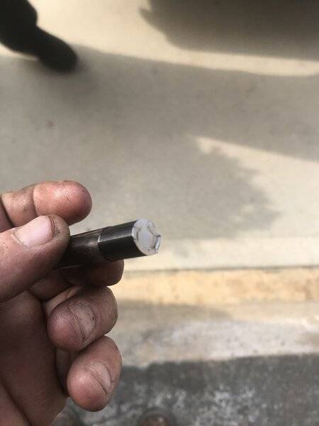

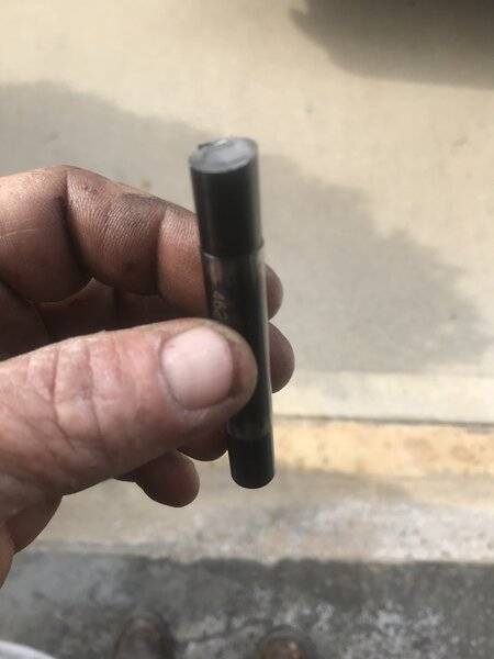

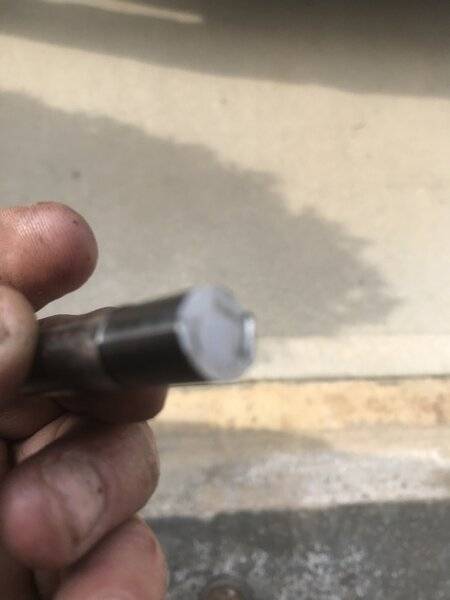

When I refreshed my engine about 15 years ago I used a Comp Cams pushrod. it failed within a year, luckily in my driveway, could not figure out why I wasn't getting fuel until I read a thread about the push rods. Shure enough thats what it was! I had a hell of a time getting that thing out because it mushroomed.
Luckily I found somebody on eBay with New Old Stock, I bought three of them.

Find old original or a good used one
Take both to a heat treat shop. Have them do a rockwell test on good end. Then ask them how much harder they recommend. And have harden it. Think induction hardening is the way to do it, you only harden near the ends. You don't want it glass hard. If you have several maybe have them do them to different hardness.
It only takes a few minutes to induction harden those pieces.

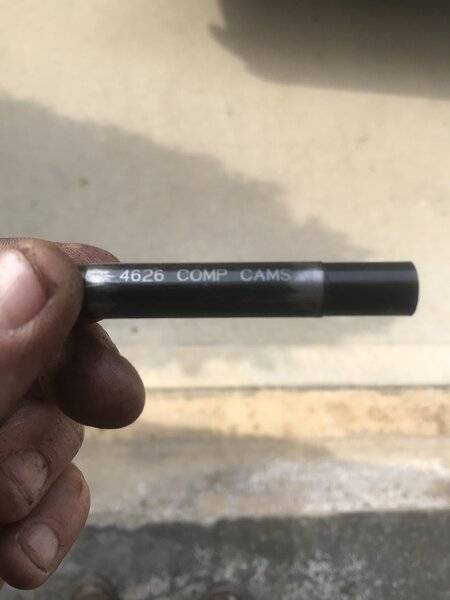

Well, I went to a local metal heat treating shop this afternoon and they did a Rockwell test on my new Comp Cams pushrod and a used one that I have (no idea whose it is). Both came out at 60.4, which I was told is very hard. I told him the issue of wear & he said that if there is a problem with wear, it's made of low-carbon steel. I asked about heat treating the tips and he said that it wouldn't do any good if the steel is cheap. So, I guess this leave me with a trial and error method.
Looking at some of the pictures of the ones that have failed, it looks like just the outside is hardened and the inside is soft (mild steel). Like stated in the last post if they're using cheap steel there's not enough carbon to create the hardness needed. It's the world we live in today.
Well thanks for finding out hear treating isn't the answer. Did he say what steel alloy you should use? Would it need to be heat treated if you had one made?
I don't think it would be 60 Rc if it was low carbon, unless it was carborized. I wouldn't think that would be much cheaper than using high carbon steel.

The used one I brought in had some slight wear on the cam end & that’s the number the machine came up with when that end was tested.
I've had a couple that have worn, but who else has been having trouble with them wearing? What do youz guys attribute it to; the rod being made of Chinesium, the camshaft, or using oil with no zinc?
I just bought a Comp Cams hardened one.
https://www.summitracing.com/parts/cca-4626

The problem if it is carburized low carbon steel is that the first .008"-.015" will be Rc60, but the remainder of the part will be around Rb85 which provides no wear properties. If you break through that thin egg shell of hardness....there is nothing to stop the wear.
The medium carbon and high carbon steels can be through hardened which means it is the same hardness all the way through.
Low carbon steel is way cheaper than medium and high carbon steel and the carburization process is relatively inexpensive in a production atmosphere. The easiest way to check would be to take a used worn part, section it and take a hardness reading at the core.
