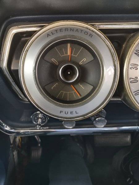

I finally got the seats back in and took the car for a short drive to the gas station. It turns out my gas can holds 6 US gallons (22 litres), so I had actually put in 12 gallons so far. The gauge was reading just over half. It took about 7 gallons (28 litres)to fill it and the gauge read full. I put it up on the lift when I got home and no leaks. Success!
