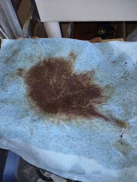

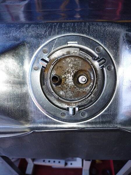

In case you wondered why I needed to change it. This is what I got when I tried to get the last of the gas out of the tank.

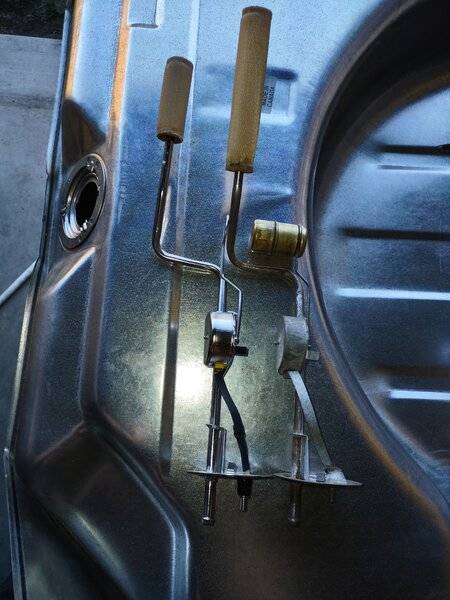

The only fuel strainer I could get locally was for a Jeep. I had to ream it out to slide it further onto the pickup tube, but it worked. It fit fine and I reused the original gasket and lock ring.

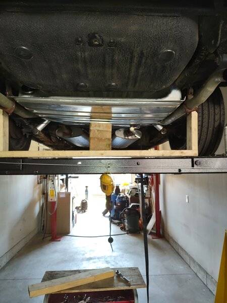

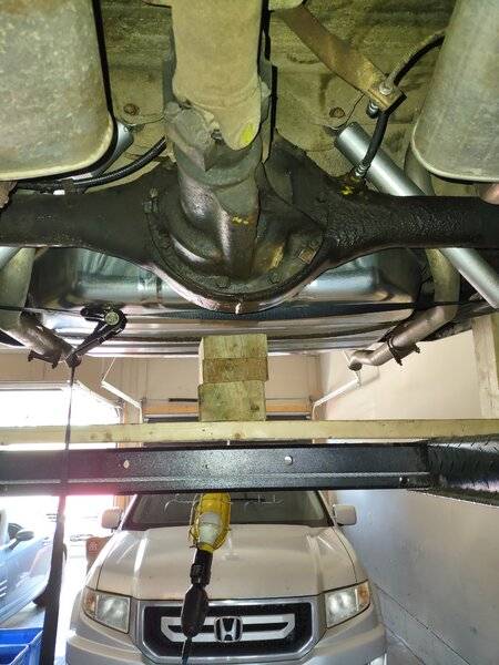

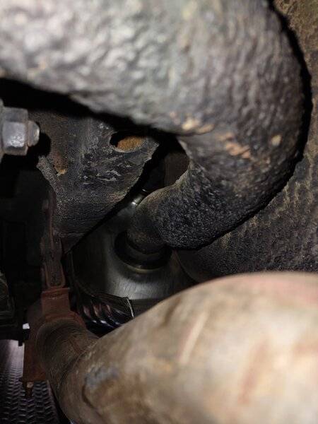

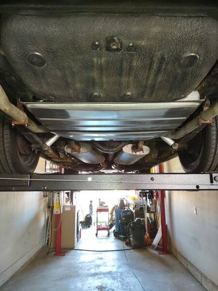

I got the gas tank in today. Working by myself, I had to improvise. A ratchet straps and some blocking worked out.

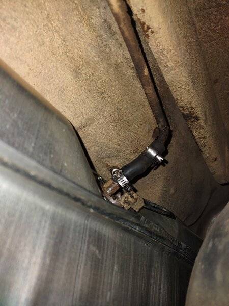

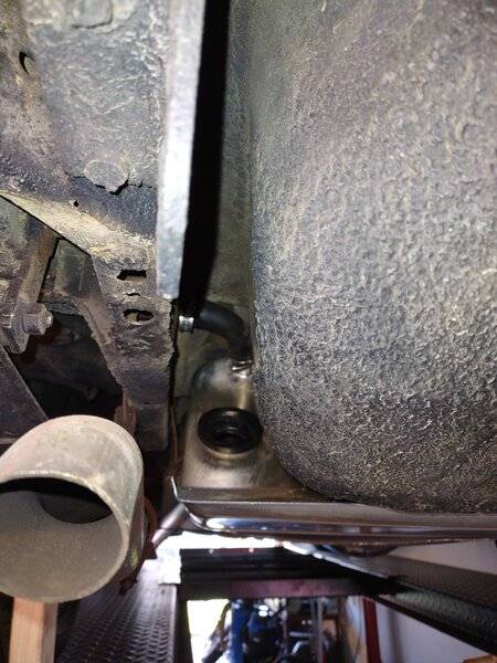

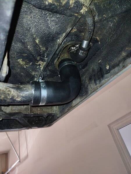

The vent tube was a pain. The hose ended up too long so I had to cut it in place. I put lots of grease on the filler neck and it popped into place.
The filler hose and vent hose both had to be shortened. I have no idea how the factory installed these on a production line. The fuel line is hooked up and I even got the ground strap installed. Hopefully the gas gauge will work now.

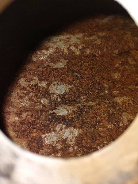

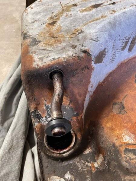

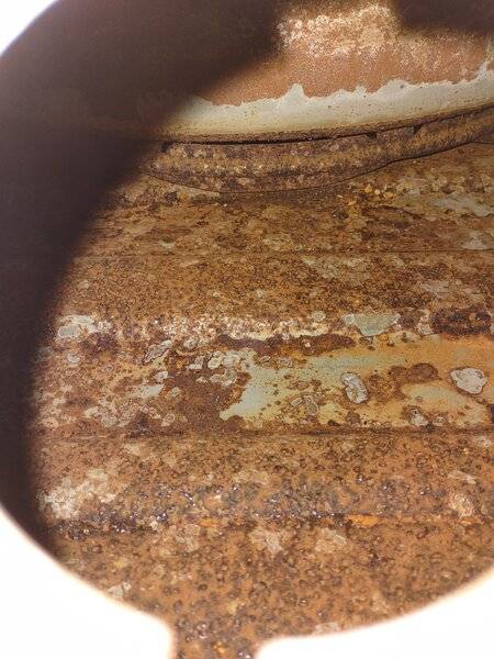

The tank is in, but as I was admiring my work I realized it was a bit crooked. I will try and adjust it another day. I think I am going to undercoat it like the old one. Here is what the inside of the old tank looked like.
IMG_20220515_153631179.jpg IMG_20220515_154816672.jpg IMG_20220515_154850354.jpg
With the tank looking like that I would have back flushed the line from the pump.
Looks good.
Don
I drained it from the fuel pump end so 9 gallons of gas flushed through the line. I also ran a rifle brush through the original sender and flushed it with brake clean. I'll pop on a new filter and we should be good.

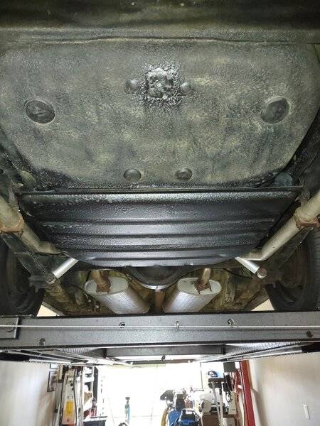

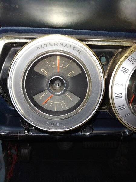

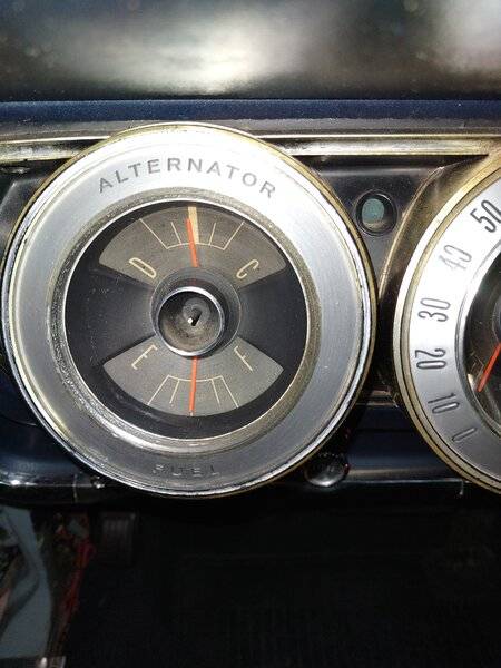

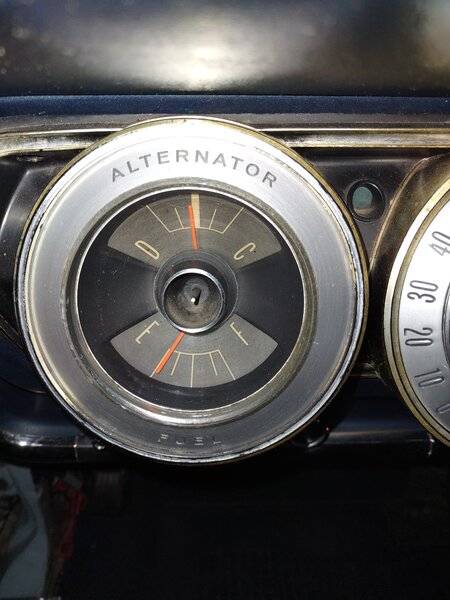

I figured out why my tank was crooked. The seam was hitting the frame at the front passenger corner. I fixed that and it lined up pretty well. I ended up undercoating it the same as the factory tank. I changed the fuel filter and put 5 gallons of gas in it and so far no leaks, and the gas gauge works now!
IMG_20220522_124853843.jpg IMG_20220522_130723707.jpg IMG_20220522_125849792.jpg
I would say that's a little low for 5 gallons but it may come up further after a few minutes. They are slow reacting.
It moved quite a bit from where it sits empty, but I'm going to test it again and then add another 5 gallon can and see where that brings it.
I double checked the reading with 5 gallons in it and it was the same. I added another 5 gallons which brought it up to half full. The gauge is a bit notchy. When I had it apart I bent the brass contact arm a bit so it was making better contact with the windings. I might have overdone it causing it to have too much tension and stick a bit. I hope it will smooth out over time.

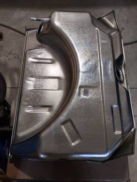

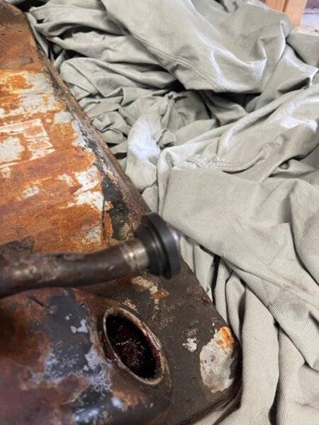

Interesting post, I was installing my gas tank today in my 67 Charger and the new vent tube grommet I bought did not fit, it was too large and I couldn't install. I did install the new elbow that fits onto the tube from the gas filler neck and I fortunately have the correct pliers to crimp the clamps that came with the kit from Vans. I had my original tank boiled out and lined. I ordered a vent line grommet from Classic Industries and hope it fits. I also am installin a new exhaust system and wanted to know if I should install the gas tank first or install after I install the exhaust tail-pipes. Any thoughts on the order of installation?
If you get a vent tube grommet that fits with vent tube installed. I'd like one I know someone else who'd want one.. I change one many years ago. If you look in large hole on top of tank vent tube has two straps hold vent tube to top of tank. I found the four spot welds and drilled them. Some wiggling and got vent tube out. Changed grommet put vent tube back in. To hold vent tube in I fished brass wire through drill hole around vent tube and out other drilled hole. Do the other drilled strap. Then you solder the 4 holes with wire closed. If you had some brass strips could be done neater, it's what I had to work with. Of course gas tank must be gas fume free if you use a torch! A soldering iron you preheat is one other way.
My new tank came with a soldered in vent tube, so I didn't have to deal with the grommet. When I put the tank in I loosened the tail pipe hangers and was able to push them out of the way enough to install the tank. I would probably finish the tank install before doing the exhaust.
Thanks for the insight. I will install the tank first and then the tailpipe exhaust. I also received the new grommet yesterday, so I will install this weekend. I painted the tank with a stainless paint and I had planned to put undercoating on the bottom side, just like it came originally. When I get it in I'll post some photos. Thnaks to All of thr Forum members who responded to my questions.
One other tip, measure your original hoses. The replacements were all too long and especially with the vent hose, because it butts up against the frame rail, it can make it hard to get the tank centered correctly. I had to cut mine in place, which was no fun.
