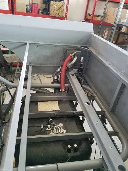

Hey Guys I Mini Tubbed My 1969 Road Runner and Now Cant Re-Use The Vent Line That Went Across The Trunk.
Any Ideas On How To Go About Venting The Gas Tank?
Thanks
Make a new line that does the same thing but fits within the new parameters of your newly mini tubbed trunk
Just terminate it where you can drop it through the trunk floor. It's OE placement was just so any fuel was dropped into the frame rail.
You may be able to run something similar
to what I use. A charcoal filter (from a corvette
booster vac hose) with a marine vent screen.
(keeps the bugs out).
