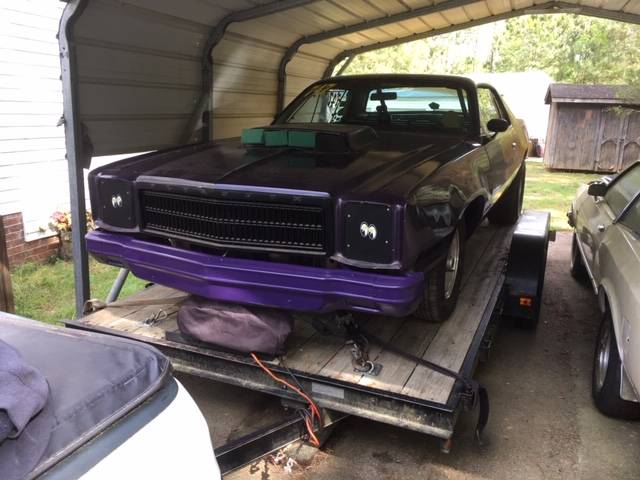

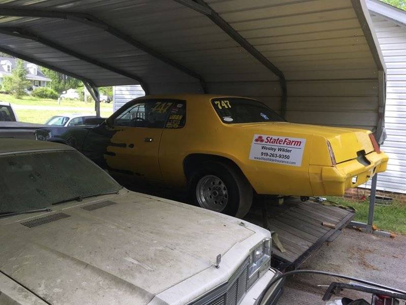

After nearly 2 years in the shop as the resurrection of this old race car was taking place. She went out for her first shakedown runs two weeks ago & frankly lived up to her name as she was a handful. Nearly crashed her on a mild easy pass. So two more weeks in the shop & she’s ready to go out again. Just easy runs planed & if all goes well I’ll turn the wick up.

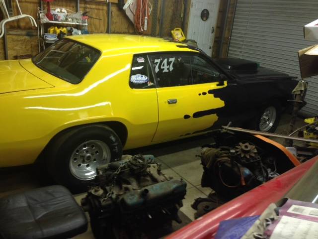

The red 64 Barracuda in the back is another old race car I’m trying to bring back. It has a vintage Hairy Glass front clip.
thanks looks like a monster.:thumbsup:
It’s named aptly. During the Resto it was two steps forward & 1 3/4 steps backwards. Car is originally out of eastern Tennessee. It was raced in Georgia, Tenn & NC that I’ve found out so far.

why was it such a handful to drive ?
(almost crashed on an easy pass)

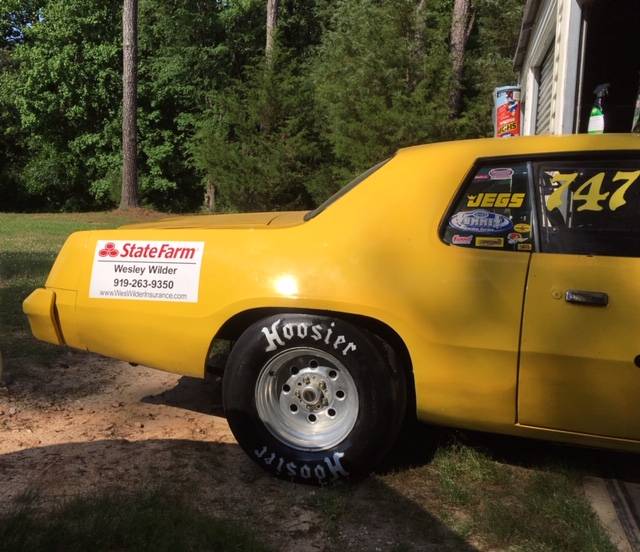

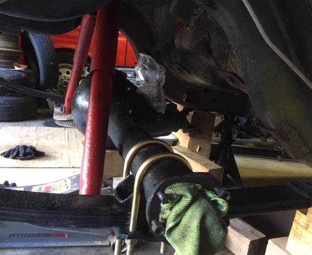

I completely forgot to check the front shocks while working on the car. They where worn out completely. Front of car started bouncing very bad. I just made drive down passes to check steering (all new from box to steering wheel) & brakes (all new master & rear wheel cylinders & lines). Just wanted to get a feel for all of that before I made a hard pass. Was not worried about times yet. There was a lot of rear end & suspension issues I had to correct. Installed a completely new rear in the car. It’s a long story. Hope to take car out again very soon. I’ve fixed a lot of the issues & lowered the car 1 inch. New slicks on the rear. It should do better.

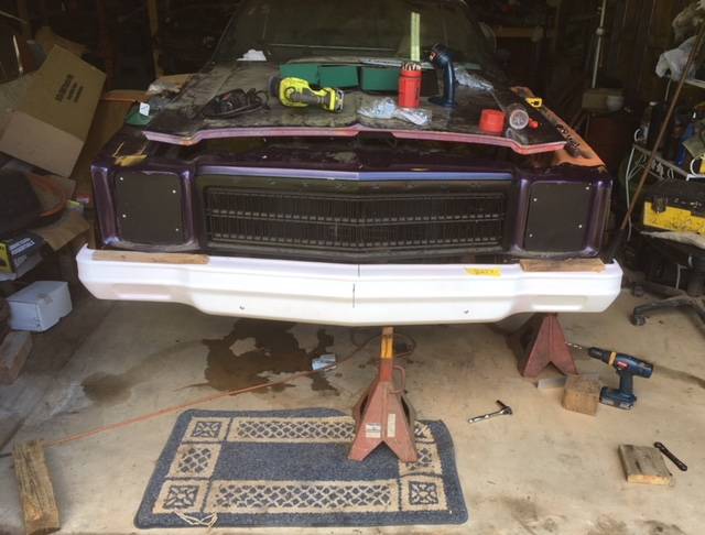

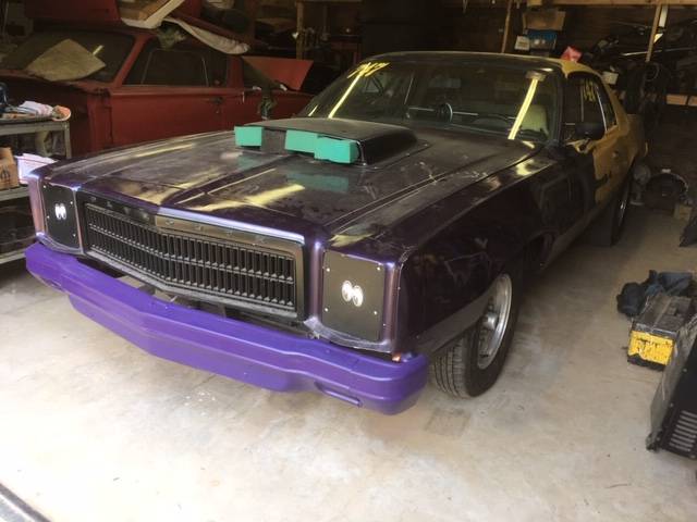

When I first got the glass bumper. I had to section it to fit. Not as hard as I thought it would be. I’ll dig up the pics of that later. 60 pounds savings

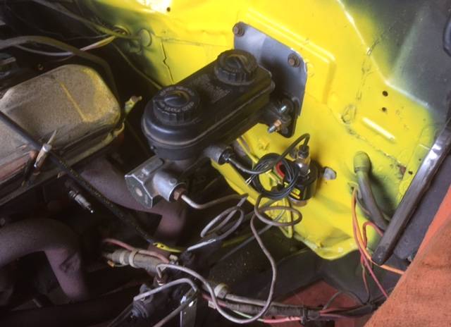

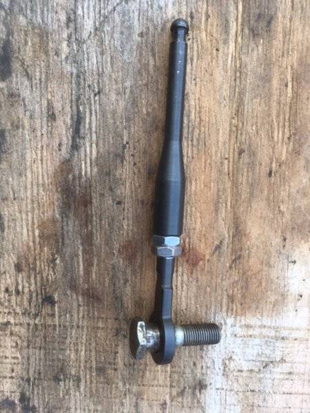

Installed a modern 80’s Ram truck master & used a Mancini Racing adapter & pedal push rod. I had to modify the push rod. That was a lot of mock up & trying different lengths. Before I cut it to fit. It seemed to work ok. Brakes felt good.

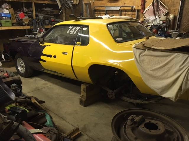

Hey Bob, I think we talked a few times in the past. Can you tell me anything about the motor mounts, k frame isolators, and frame ties you used? (Assuming you did) . I would greatly appreciate it. I have one of these mid 70's B's going together. Would love more pics too! Thanks!!!

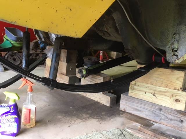

I’m still running the factory spool mounts. I don’t see any need to change those at this time. I did install Polyurethane K frame , torsions bar support & leaf spring bushings. Not hard to do at all. Can’t say if or how much that helped as I didn’t run the car before.
Not frame tied or any additional support?

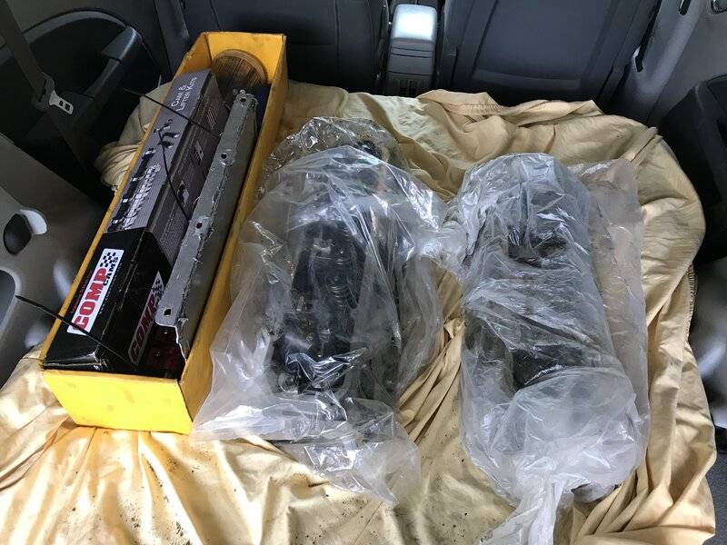

Scored these go fast parts yesterday from a fellow racer. Aluminum heads complete with roller rockers, push rods, bolts & a 509 purple bump stick. These parts will find their way on FURYIOUS next year most likely as I’m going to stay with the combo I have for now.
