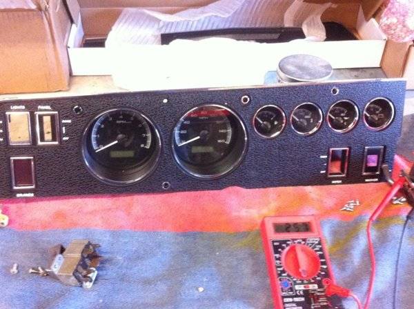

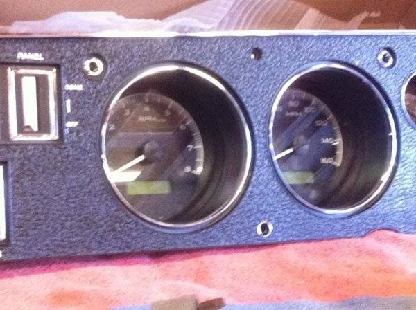

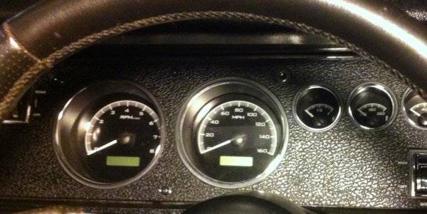

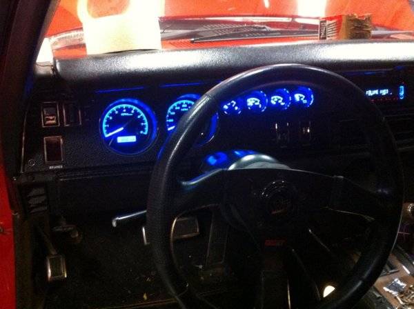

Dakota Digital makes clusters for many classic cars. I have one on my 70 Charger. Originality was not my main focus with the car. I did consider either having my originals restored or buying OER guages from Classic Industries but for the same money, I got an volt meter instead of an ammeter and a tach. This cluster also has a trip odometer, low fuel warning, 0-60 timer and a few other features.

I have no idea what car you are working with, you didn't mention it.
View attachment 545693 View attachment 545694 View attachment 545695 View attachment 545696
I like that !
