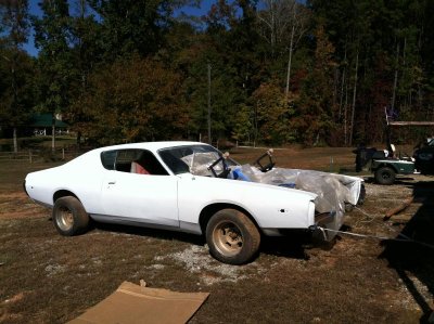

hope this pic shows up
Fill us in "what are your plans". Looks like a pretty solid car.
it needs to be in neutral when you start it,ebrake on & foot on brake pedal.
Charger looks great. With those deep dish rims and wide tires, it gives it that stock car look kinda.
