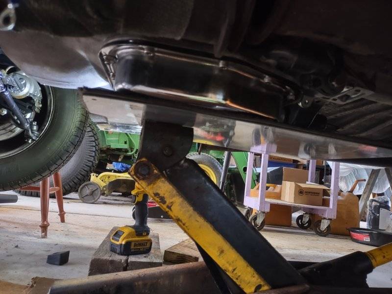

If you're on jack stands one of these works great.
