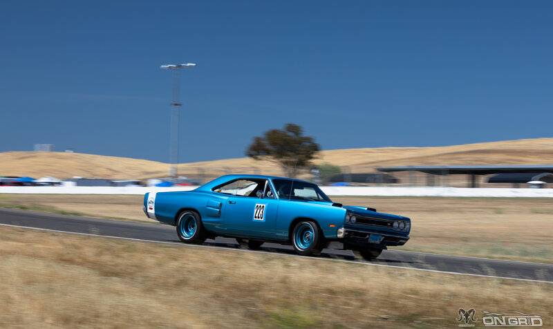

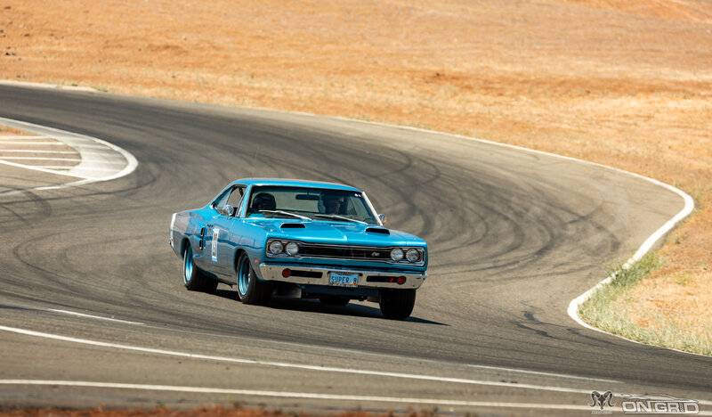

I'm very happy with my Mickey Thompsons Sportsman S/T's. They seem to handle track use and street use well, and aren't wearing down as fast as I'd expect them to.
Here are the sizes on my 69' Bee
Front Rim: 15x8, 4.5 bs
Front Tire: 245/60R15
Rear Rim: 15x10, 5.5 bs
Rear Tire: 295/50R15
