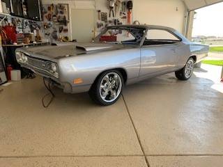

I've got a new picture to post. The Harland Sharp roller rockers look great!
I really like those! Adjustment fairly manageable?
According to John Mercedes, they are unique and add for much more power due to their lift capabilities. I cannot speak about the ease of adjustment yet. Honestly I have been sworn to secrecy about many parts on this build which have beeen recently developed. To me, all I care about is a solid, relatively noiseless valve train, and what the dyno says when Joey runs it on motor and then with the Edelbrock Stage 3 blower. I'm going to start a thread on the specifics of my 68 GTX build. I haven't yet because I want to wait until the engine is in and see what things are left to address. Then there's the fact that she's still in fab, so my fab guy wants to reveal the car at SEMA 2017. I see so many members doing such great work on their Mopars, yet I can't say the same. I've spent a ton of money on here because I can't do the work myself anymore. The sad part is that she won't be my creation, but I'll take her just the same!!

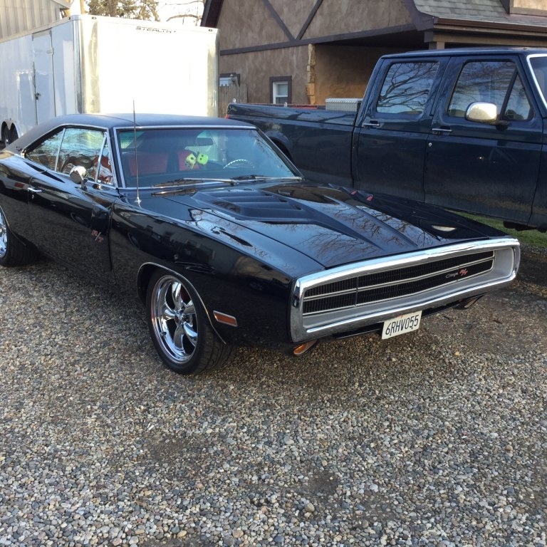

dpaul63, Thank you for your service. Sounds like a great build. My brother put a 4l60e behind a 572 HEMI in a 70 charger recently. I believe it was over 700hp and I know with the Nitrous kit it was over 800hp. I know he did some hammer/dolly work on the tunnel for it to fit, as far as i know he didn't have to cut into it. When he was taking the car back to the customer and cruising down the freeway, he said it ran and handled really really well. He really liked the transmission.

Like mocajava said, digital and gps. They put in Dakota Digital gauges in the Charger.
