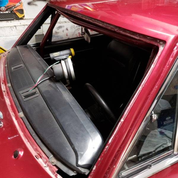

Front windshield- 27lbs.
Windshield gasket- 5lbs. !!!! Wow, who knew?
So what’s a Lexan windshield gonna weigh?

Removed all 4 regulators, replaced the side windows, and rear window on mine with 1/8" Lexan. Still has stock windshield. Saved 88lbs.

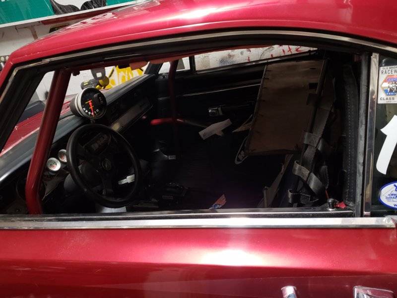

Driver side window and regulator removed.
-24 lbs. More x2
I'm now at 80lbs. removed.

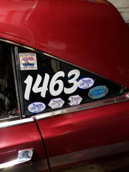

Still have rear window and quarter glass.
I'm not sure if I'm removing the quarter glass yet.
-7 lbs. per side for the quarter glass.

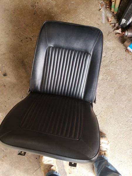

Passenger seat -38 lbs.
Driver seat -38lbs.
Front bumper and brackets -24 lbs..
That brings my gross total so far to -194 lbs.
