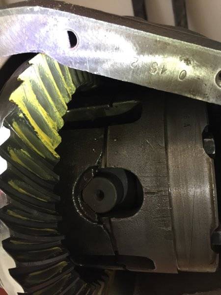

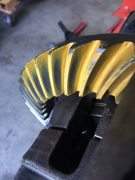

Here’s some pics. First is coast side. Second is drive side.
4B1B3A09-CF5B-42E7-ACC2-D2784BE2CF28.jpeg 183CB2C0-2879-41B9-80BF-643189BE10CE.jpeg

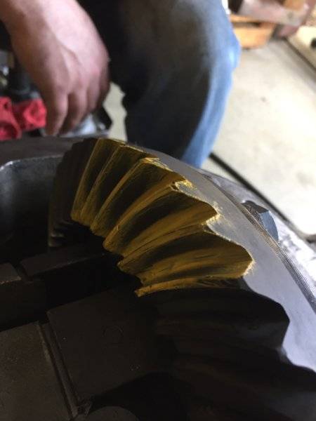

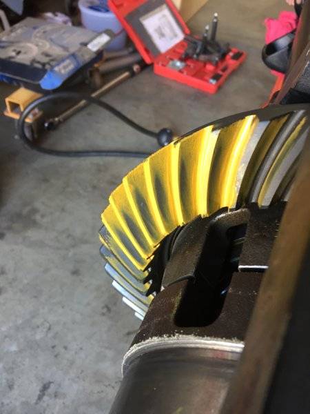

A few more of the coast side. The reason you want to concentrate on the coast side is because the drive side is “worn in” but the coast side really hadn’t been touched.....unless you drive around in reverse all the time. So, get your pattern set on the coast side and the drive will follow really close.
65EC7A95-44D6-46FD-A0F6-04004871A2F6.jpeg F3043877-3B22-48DB-B944-D34B78968288.jpeg
