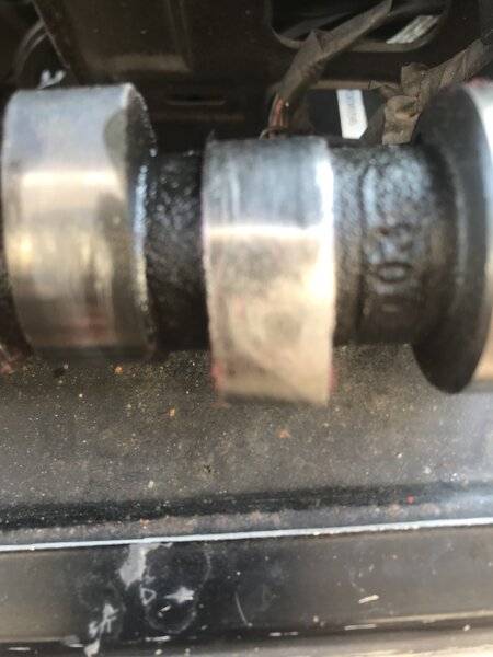

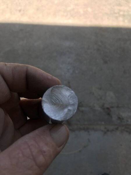

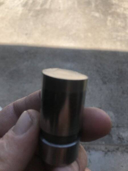

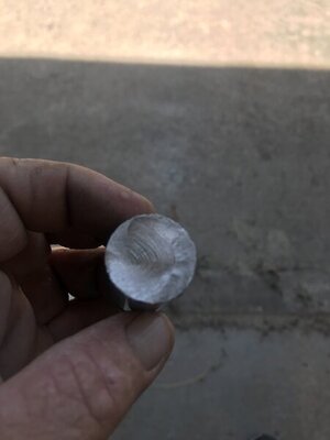

Well spent the better part of today waiting on a tow truck to get the car to my house. I now have the cam out and all of the lifters but the exhaust lifter on number 8 is bad as well as that one lobe on the cam. Everything else looks like normal wear to me. No cupping or mangled lifters they all look useable. The first picture is the rear most lobe and then the lifter.

Now to figure out WHY only one lifter failed. I guess it stuck pumped up. Perhaps I should tear it apart and see if anything internal looks messed up.
One lifter failed cause you didn't run it long enough for more to fail....
When going back together verify that the lifter spins....
Thing is the metal from that lobe went somewhere... I've seen it embedded into piston skirts, stuck in rocker shafts, or just in the oil pan.... Some get lucky and have no damage, some lose the whole engine....
High mileage engines seem to not get damaged as much cause they have looser clearances, fresh rebuilds that aren't caught quickly damage allot of parts....
First time I saw a completely destroyed engine was a 4V Cleveland back in the eighties....

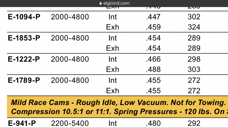

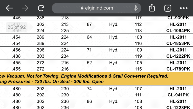

Looking inside the engine it is as clean as the 440 I built. Its almost like the engine was rebuilt. I cannot verify when it was built. The guy the roadrunner came from said that the engine was built prior to him buying it. He gave me the guys number I called the engine builder a long time ago but he was very vague on the information. But when I pulled the valve covers I could tell it was at the very least a recent rebuild. He told me it had a purple cam but couldn't tell me the duration. He said it was a roadrunner cam. Now with that said. I looked up what numbers I could find and those numbers pointed to a 440 6-pack cam. So anyhow I'll drain the oil and cut open the filter to see what's in it.

I moved the lifters from one place to another. It was just a coincidence. In that picture they are in no particular order.
I have a new set of pushrods,new lifters and new cam. All of the pushrods that came out were straight as an arrow. Nothing bent. Not even the one on the messed up lobe.
It wouldn't have made any difference anyway would it, as you couldn't re-use old lifters with a new cam. I just wasn't thinking straight, been a long day.
Awesome.. Good stuff. I will check to make sure there is no binding when I install them. But to note when I pulled everyone of them out of the lifter bores I just hooked under them with my finger and pushed them out and grabbed them with my other hand. So I will say at that point nothing was binding. I was thinking maybe an internal lifter problem. As in maybe stuck inside. I will take the offending lifter apart and show what I find. Now on the same note. I was watching Tonys Garage and he showed that lifters are supposed to rock a tad on a nice piece of flat steel. If they do not then the lifter is flat and not good for rotation. And he also said that its a big issue with modern lifters and the quality control of who makes them.

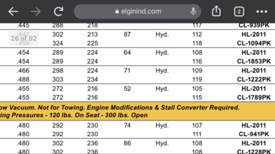

My thoughts too. Sounds a bit choppy for a stock style cam. The cam didn’t have anything engraved on it but it did have some numbers stamped into it. I don’t recall the numbers at the moment but it came up as a Elgin cam. But on another site it mentioned 440 6 pack cam. I will go get those numbers and post them to this post. Maybe the numbers will ring someone’s bell. Here they are forgot I googled them on my phone. e1222 z012
