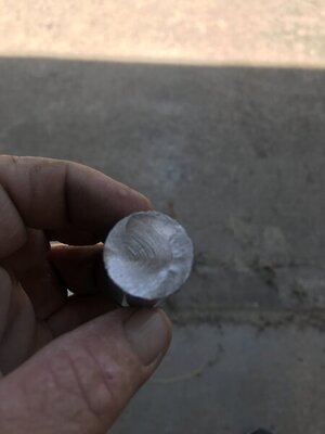

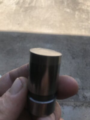

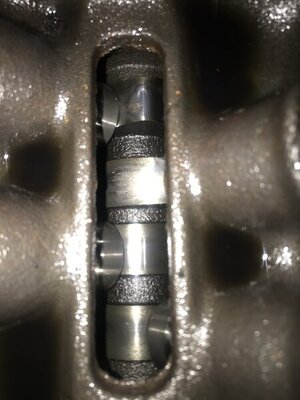

I thought a wiped cam lobe requires a complete tear down and cleaning.
I already did change the oil prior to pulling the intake. Ticking wouldn't go away. So that's when I pulled the intake. I didn't have anything with me at the time to do a better inspection. The oil that was in it was thin but clean. No metal shavings or chunks.
When I say wiped it may not be the best description. I will take some pictures and post them. I'm also changing the oil pump too. But I just need to get the cam out to make a better assessment. I did notice the lifter was damaged. Its been over a year since I last saw the car. Tomorrow will refresh my memory.
There are differing opinions on that.
If the failure is caught early, you might be okay. If the oil pan has no shavings and if the oil pump rotors have no damage, it is a good sign.
I wiped 2 Comp Cams in 2006 and ended up developing an oil burning problem bad enough to warrant removal by 2011. I honed the cylinders and replaced the rings and bearings. The bearings actually looked perfect so replacing them was more of a “feel good” measure.
It was honestly only about 10 miles from the gas station where I stopped to his daughters house. So I would say it wasn't ticking for like days maybe 20 minutes tops. I'll get some pictures of the cam. I just stopped once I looked in the valley at the rear lobe. I didn't have very many tools available and I was in the middle of rural west Georgia. I don't know anyone out that way. So I called it a day and took my beatings.

That sucks too.. Well, I think since the oil was not in real bad shape as far as metal flakes goes. Like I said did an oil change to make sure it wasn't just thinned out oil causing it. But the tick never went away. No smoking or anything like that with the 383 just a leak which I think was the cheapo Autozone sender cracked in the plastic area. And then the tick on top of that. I'll get to the bottom of it. I just hate to travel and work on a car when ALL MY **** is here.
In some cases, the lifter gets crud inside and won’t pump up. The result can be excessive clearance which makes the clicking noise. Some take the lifters apart to clean them, some replace that lifter and do a form of “break in” just as you’d do with a new cam.
I noticed some issues on the bottom of the lifter. That's what caused me to look at the cam. I will just have to see what's up. Fingers crossed its not terrible. I do have a brand new Melling oil pump I'm taking with me just in case.
