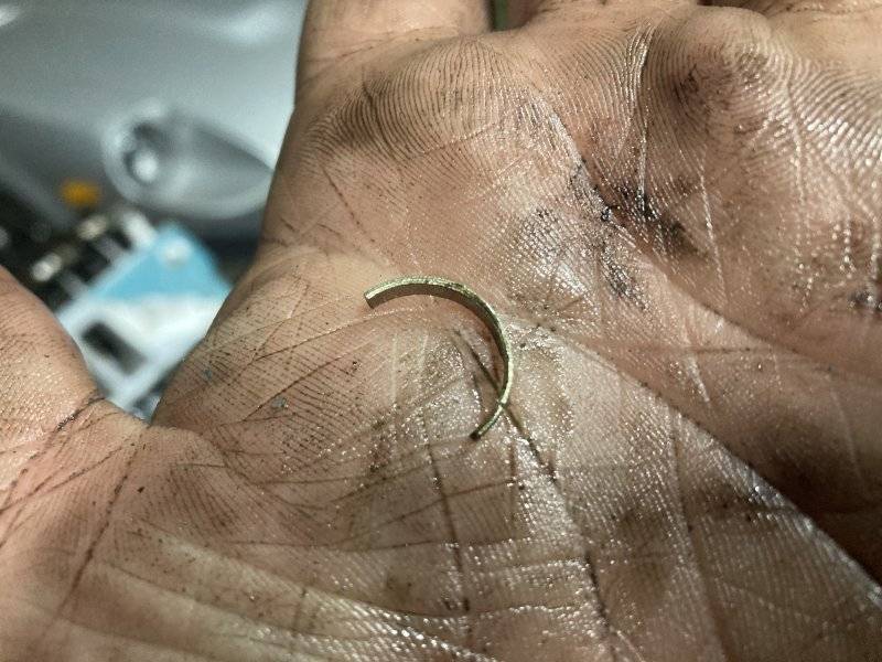

What in the wide wide world of sports is going on here!

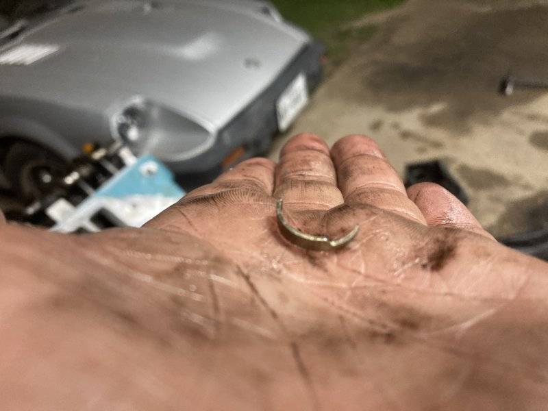

The semicircular piece is another story, it looks like a failed rocker shaft spacer.
Looks like the pushrod is about to come through the stamped rocker. Is the pushrod seat separated or cracked?
That’s what I can’t figure out, all the spacers looked fine. And that’s the only piece I could find.The discoloration on the pushrods wouldn’t concern me much, it could be from welding the tips on. The semicircular piece is another story, it looks like a failed rocker shaft spacer. Where did the rest end up?
Stamped steel rocker arm spacer
It didn’t look like it, I’ll inspect further with more light tomorrowLooks like the pushrod is about to come through the stamped rocker. Is the pushrod seat separated or cracked?

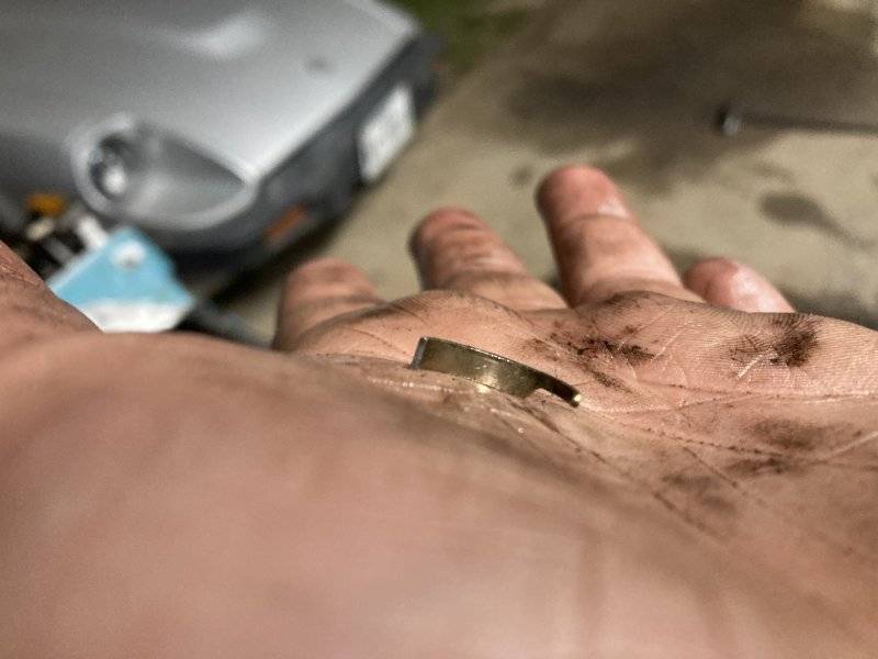

Too small for one of the spacers.
With that offset it looks like a spring clip/clamp. Maybe from a PCV valve?
I would say it’s probably not any bigger then a quarterThat was my first thought, but using Cheapsunglasses hand for scale I thought it was too large in diameter. Maybe he has hands like Marco Rubio…

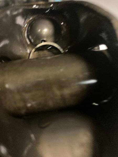

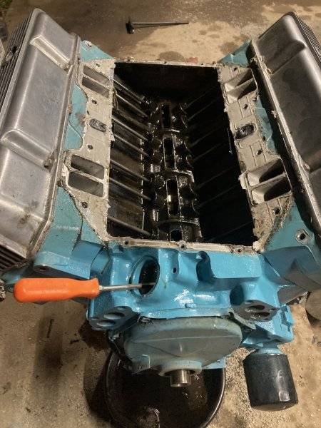

The only thing in the pan was a few pieces of old valve cover gasketWas there any bits in the pan when you took it off?
Very strange…

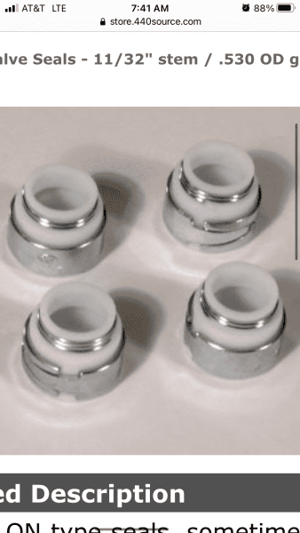

Yes that is part of the retaining ring for a positive lock teflon type valve seal.Valve stem seal ring?
Just talked to a guy yesterday that had the exact same thing. They were new source heads.Ah ha, looking at 440 sources website, yep. Is there any reason it could fail, or just an oopsy
That's retarded, not advanced.Oh boy, scrapey scrapey

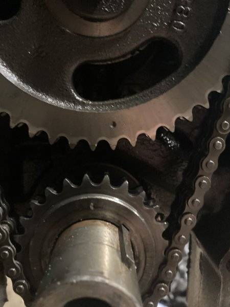

I put the engine at tdc according to the balancer, and looking through the spark plug while, I believe it’s correct. I guess I messed up a little putting the new timing chain on years ago
