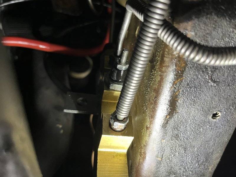

No, I tried changing the distribution block, but I’ve been battling a break line that won’t stop leaking, so I don’t really have anything to report
His lines are stainless, and I think the line that’s leaking has some “trash” on the double flare which is causing it not to seat properly and therefore leaking.
Oh I’ve spent the last 2 weeks? Taking the line off, cleaning it, putting it back on, taking it off putting it back on, taking it off putting it back on, taking it off putting it back on……..
If it's this style, that may be the problem. I have a Blue Point unit I bought back in the 70's. Always have had sealing issues with it. What happens as I discovered later on is that once you've tightened the unit up and did the flares, part of the tube would pooch out between the seams of the unit. Those pooched out portions keep the nut from cinching up fully around the flare as it's sitting only on the two pooched out spots. I found that if you dress those two areas down with a file after flaring it takes care of it.
Thorstone Double & Single Flaring Tool Kit for Brake Line and Brass Tubing Tool with Extra Adapters, 45 Degrees, Red
It’s all inline tube stuff, I didn’t flair anything
Theoretically "should" be fine then. Unless something was off on their end. Where the flare nut seats into the fittings, look for rings/dented in areas on the seats.
Well I’ll be dipped, it was the dang brake light switch:BangHead:.
I’ll try bleeding them tomorrow and then we’ll have to see if the brakes are better

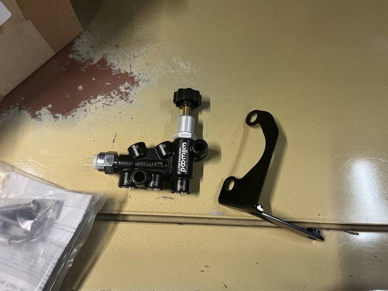

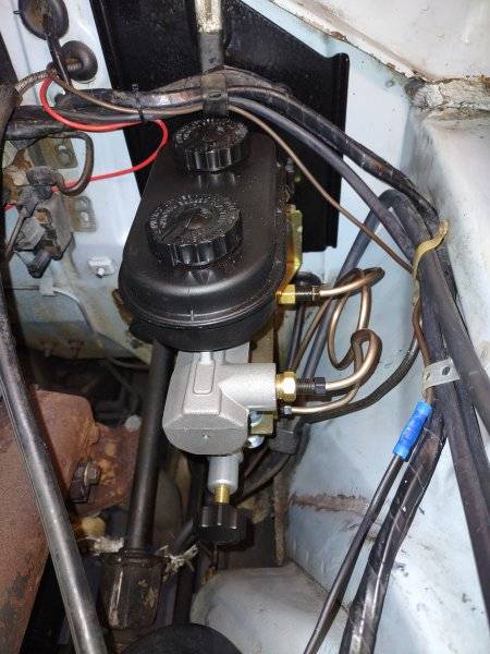

Alright, I have not been slacking, I’ve been fighting BS. That distribution block is completely garbage, it just leaks. @5.7 hemi has been very helpful (and patient) after talking with him I decided to ditch the factory block and go with this, it even bolts to the master cylinder, which is amazing, because I’m tired of swimming in brake fluid, and working in the extremely tight spot, thanks zack!….now I just have to rebuild the lines:lol:
I did something similar using a Summit adjustable proportioning valve.
