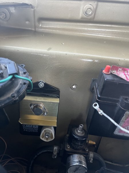

A while back I had a Mallory unilite in it and it crapped out, so I tried building an hei setup. It didn’t work, and I think it’s because I messed up on wiring. However screw all that, I’m going with factory ignition. The module is from Mancini racing, I have one on my Lil red express truck, it works great so I bought another for this one. And my distributor is from Rick Ehrenberg, it feels like a pretty solid well built unit.

The shape of the connector is wrong. I can get the box to work on lil red, so a little sanding I think I got it

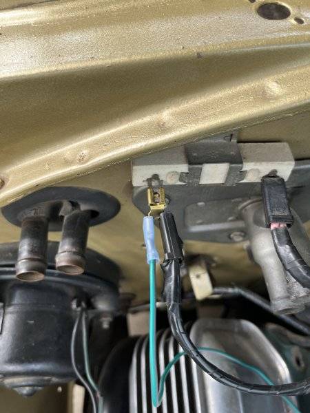

I was close. It would kinda try to run, so I advanced the distributor a bunch, and it tried harder, so I moved all the wires over one to really advance it, I kept advancing and advancing. Then nothing happened.

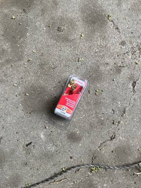

I have the ignition wire to the ballast resistor kinda shoved in, I think it came loose. I bought a package of double fork terminals at Oreillys the other day to use, and they apparently ran away. So tomorrow I’ll buy another package and we’ll see if we can get it to run.

You know how long I looked for these damn things last night, and when I got home for lunch I dang near stepped on them getting out of the car

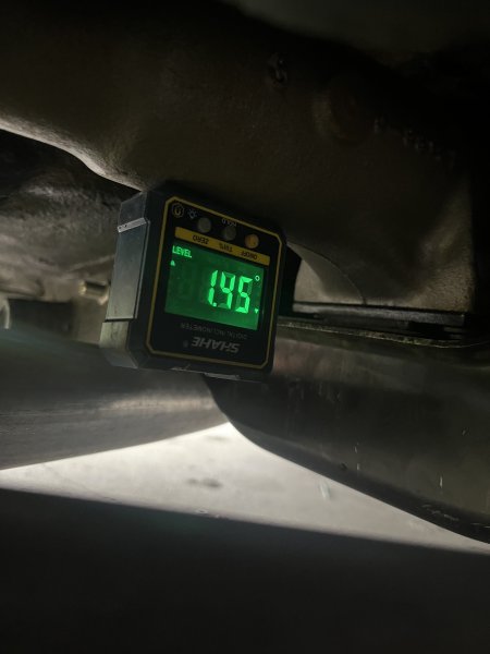

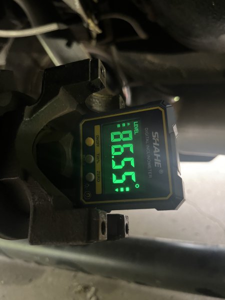

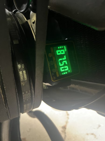

3rd problem, and this is the big problem, 55-85 it vibrates so bad. I know the issue, but I’m clueless how to fix. Back end is raised 2”, so pretty sure our pinion angle is way off. What do I measure, and what do I correct oh great wise ones?
Other than that, it’s such a great car to drive!
There's a thread in the driveline forum. Pinion angle isn't as complicated as some people make it out to be.
Remove driveshaft
Using an angle finder, measure vertically on the end of the tailshaft. For simplicity, let's say it's 0 degrees or straight up and down.
Using an angle finder, measure vertically on the diff yoke. For simplicity, let's say it's 0 degrees or straight up and down.
If both angles match, the centerlines of the trans output shaft and diff pinion are parallel on the horizontal plane. You don't want that because under power the pinion tries to "climb the ring gear" and changes the pinion angle. Opinions will vary as to what the correct pinion angle is. I'm no expert but I can tell you that 4 degrees nose down works for the GTX using 3800# SS springs and an adjustable pinion snubber set a couple inches from the floor. I run my '58 Apache at 2 degrees nose down.
While the driveshaft is out it wouldn't hurt to have a driveline shop check the driveshaft balance, runout and phasing. Any one of those things will create an issue at the road speed you mentioned.
Post up your measurements...
@HawkRod @Black_Sheep , and anyone else that knows better :lol:
Ok, my cheap amazon angle finder came in, probably not the best one to use but here’s the numbers. If I’m not mistaken engine is is down 1.45, and my rear is up 6.4 degrees. I also found at one point I put shims under the rear, and doing research they’re 2 degrees, I must have misread something 7 years ago and thought it needed to go up,
