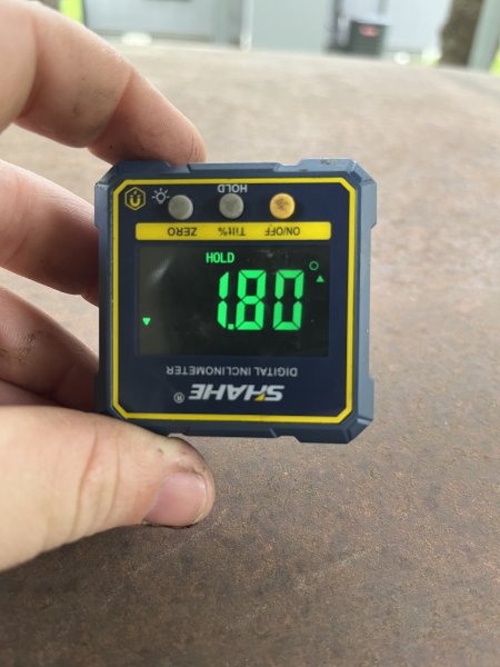

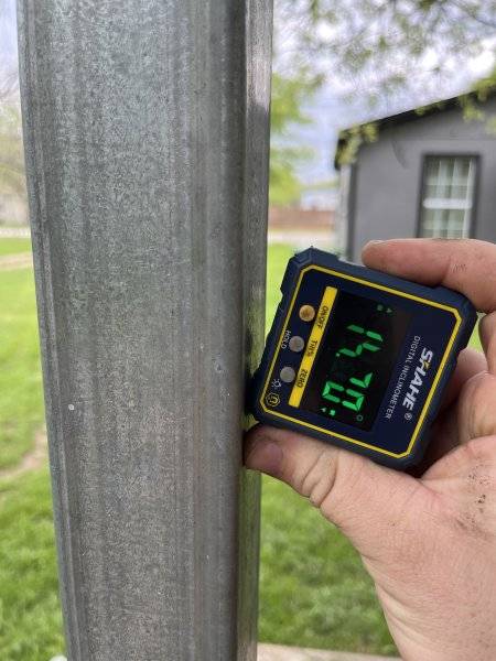

The gauge is kinda of a turd, the arrows are really confusing, I might try a different gauge
The gauge probably works fine. Easiest way to tell how the arrows work it to hold it at an obvious angle one direction from vertical and take a measurement, noting how the arrows point. Now rotate it past vertical leaning the other way. Again take a measurement - the arrows should point the other way. Now you know how the arrows work.
I had to do this with the gauge I had. It is easy to get messed up, so take it slow and measure twice, cut once!
Ok, so it looks like arrow up, arrow down, is angled down. And it looks like I can zero the angle gauge. So after all of that and making sure it’s on the flat of the yoke on the rear, we’re 2.5 degrees down
From what I understand, those numbers don't seem bad.
