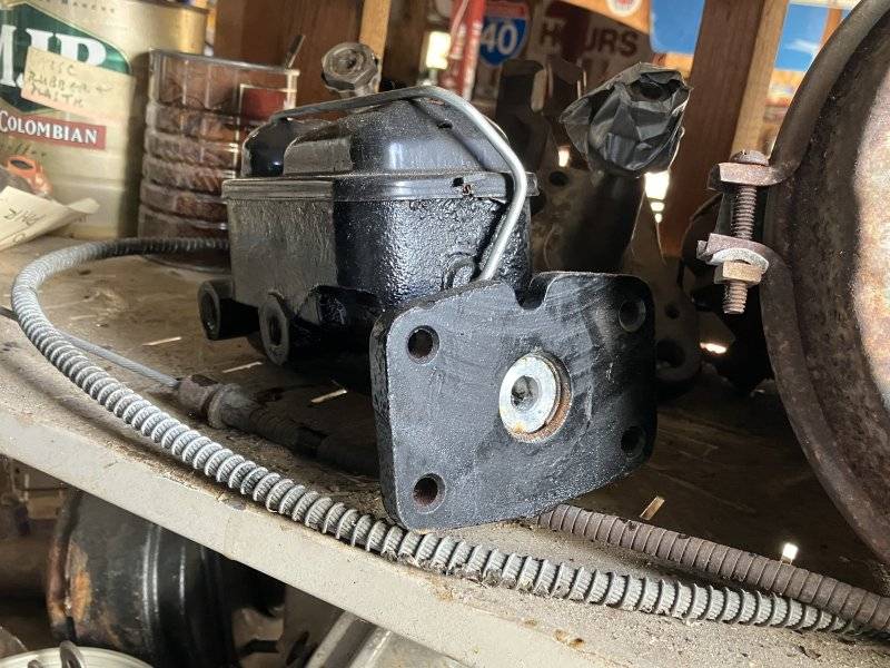

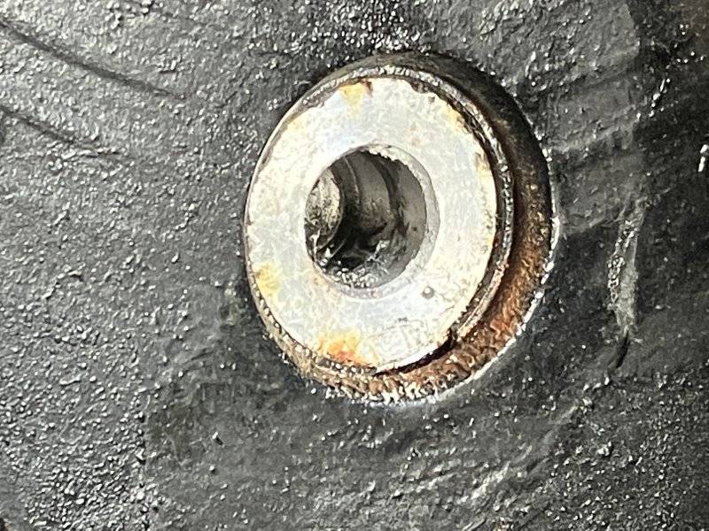

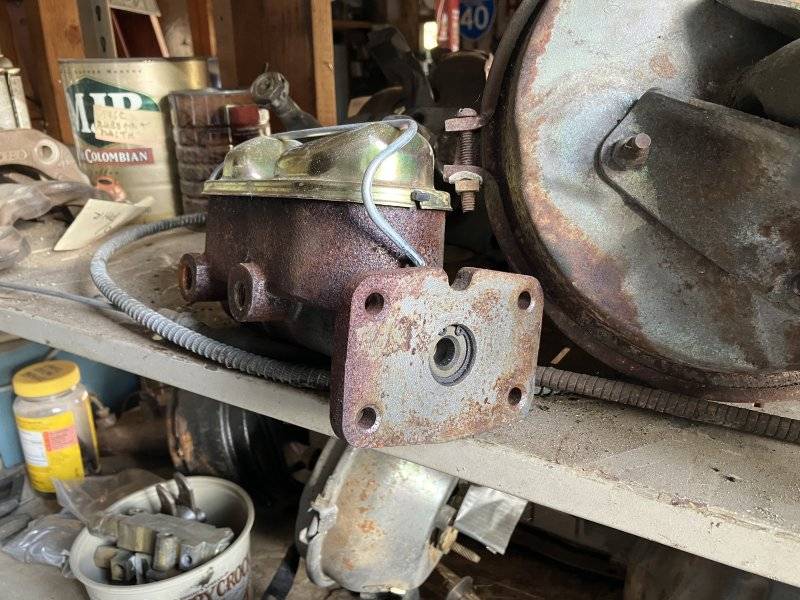

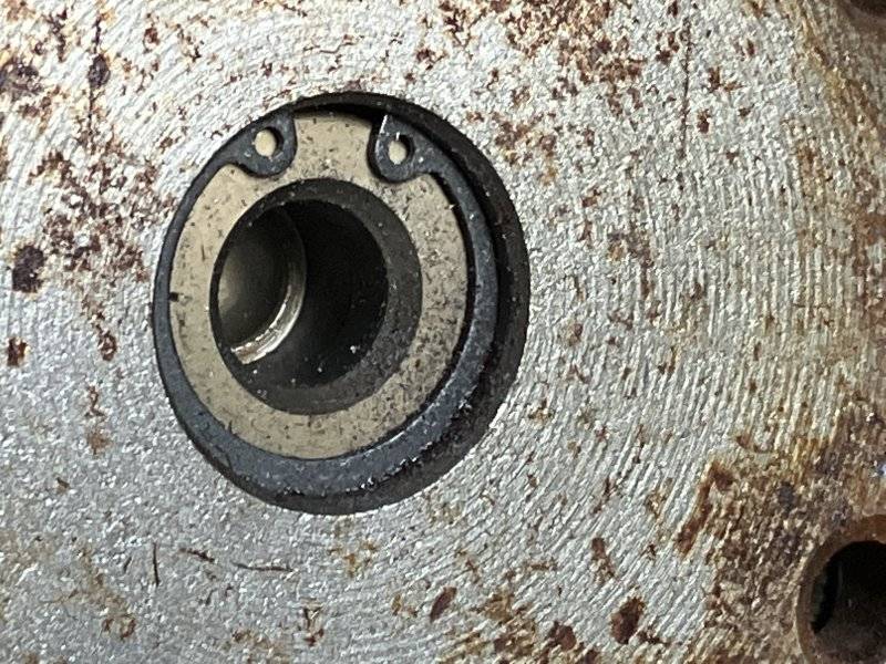

No, virgin bore

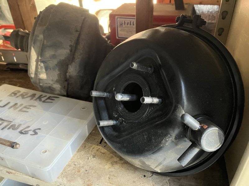

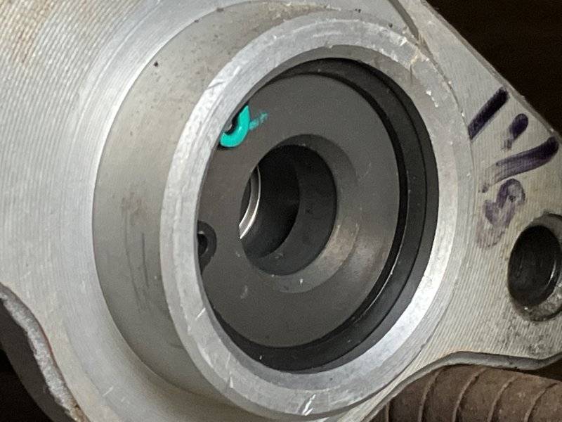

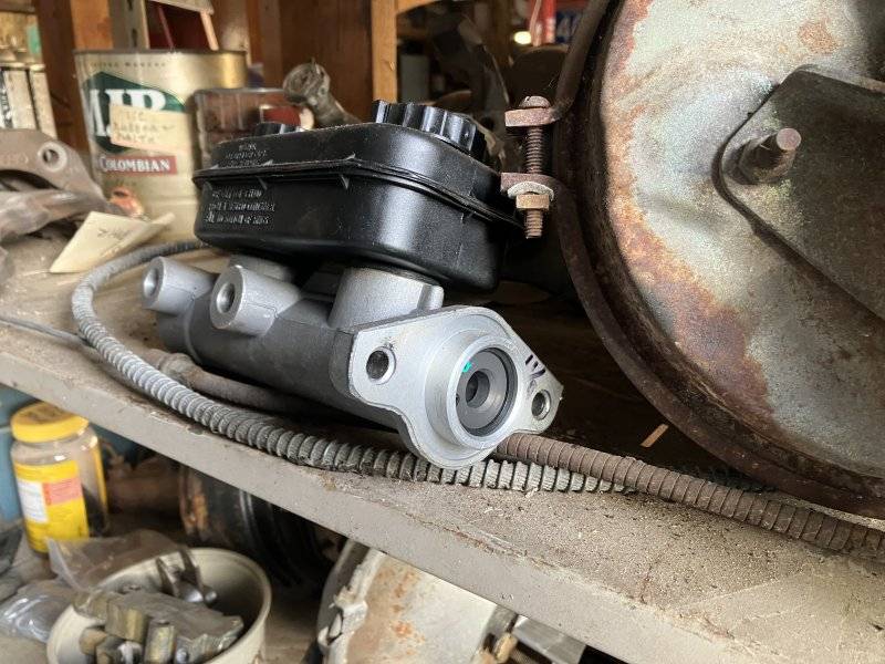

As a last ditch effort before calling it quits I pulled the rubber off the dr diff rod, stuck it in, pedal hight it s right at the clutch hight, and it activates front and rear brakes
Without the rubber on the rod it works out?
Sounds like it's not seated using the rubber. Like Kern said look in the bore for a machined section for the rubber to lock into.
