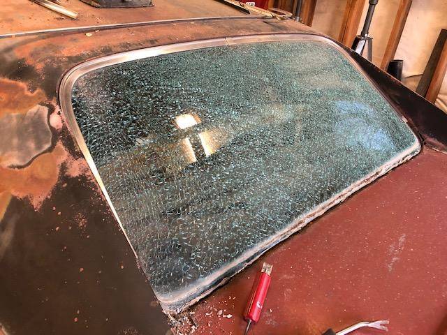

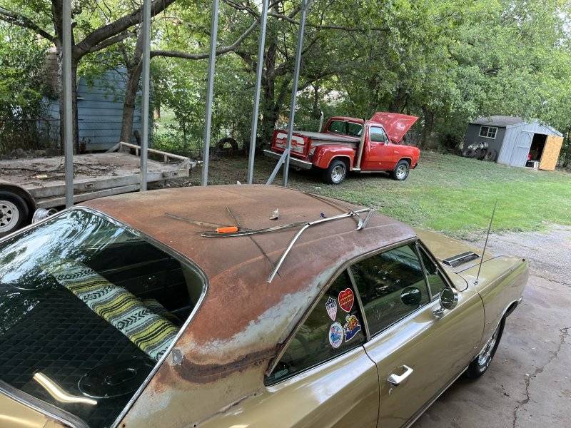

And so it begins, a bottle opener, cold beer, and good music, off with the trim and then I get to dig out all the seam sealer :drinks:
How is the back glass trim held in? I’ve been fighting it all morning, I can barely get the tool under the trim, all I’m digging out is goo and dirt, I haven’t found a metal clip yet

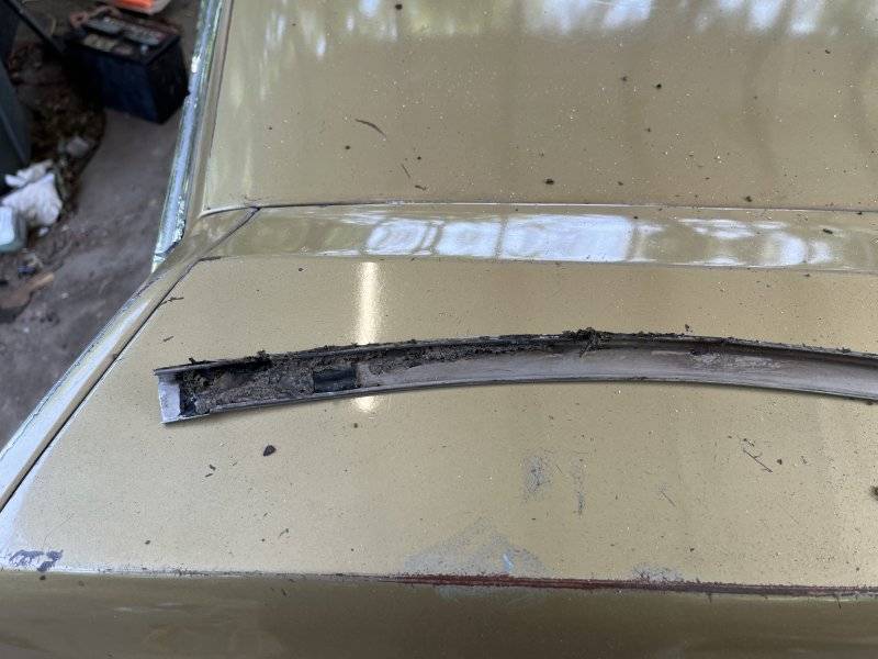

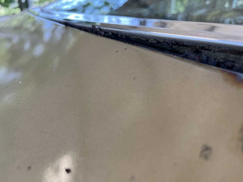

Should have clips similar to the front. Someone could have installed it with silicone sealer or something. You may have to knife it out.
Good luck. Be careful not to pry on the edge of the glass.

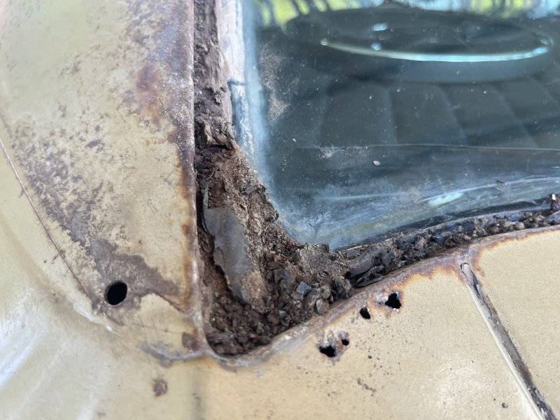

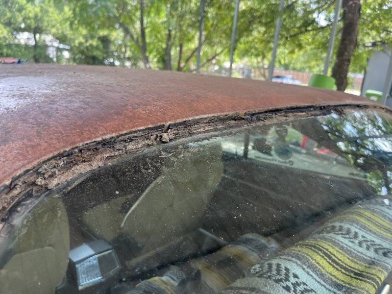

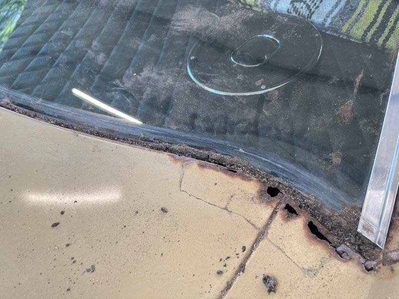

They use a clip that closely resembles the windshield molding clips. The back glass is prone to leaking so it’s not unusual to find an excessive amount of sealer at the bottom of the window. The factory assembly line wasn’t very neat with various sealers…
Yeah, I put some tape over it temporarily :lol:

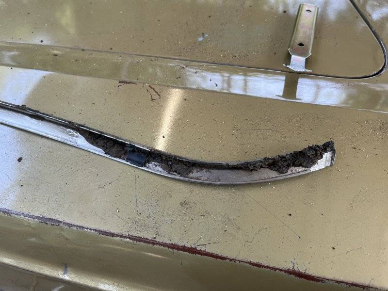

The clips were still there, it’s just whoever had stock in silicone made sure to use all of it they could :lol:
Damn, the previous owner must have worked at a glue factory! Anyway, I’m taking a break, I happened to see a roll of tape on the ground and decided to play with shapes.
