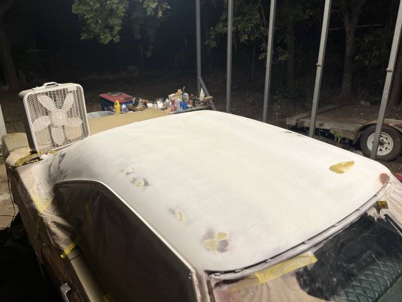

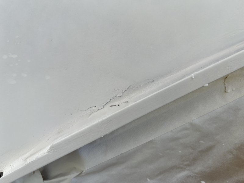

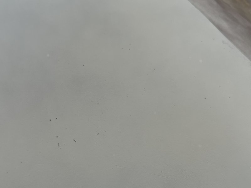

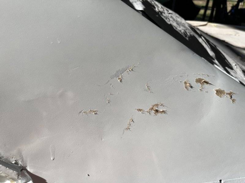

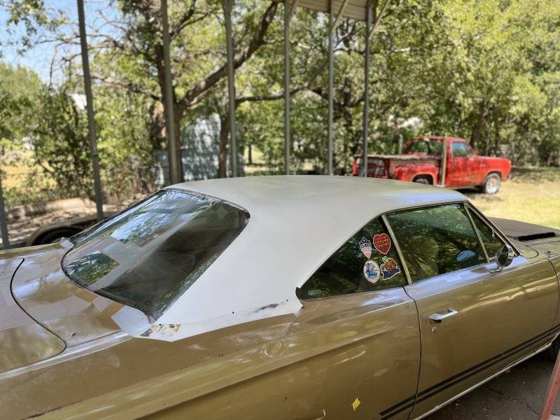

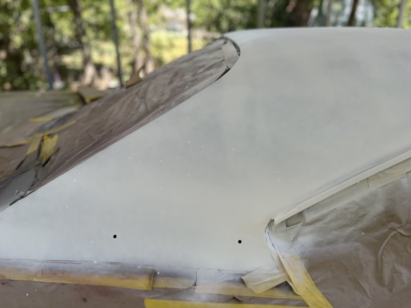

Turns out not as bad as thought…amazing what sleep does. Other than the bug tracks, got a couple pin holes a rough spot and some weirdness near the drip rail
Well it works well if you’re not under the sun in Texas, in August. I thought waiting until 9:00 would help, complete fail, it dried as soon as it touched metal and could be wiped off by hand.
So because I get tunnel vision when I set my mind to something, especially when I’m angry at something. I am going to start punishing myself and getting up really early in the morning and spray. Who needs sleep, she has a date 200 miles away in 3 weeks, and needs her best dress and pearls on :lol:
Sounds like maybe you have too much hardener? And waiting until 9pm here only makes me need to use more hardener!

The only fix is to scrape off what will not harden and apply another layer that is mixed with enough catalyst to set up within 5 minutes.
I wish that there was a way to make the rate of hardening a bit longer. The stuff I use stays soft for a few minutes then once it starts to firm up, it sets up really fast. I would prefer to have a little more time to shape or spread once I feel it is starting to set up.
Got to experiment with how much harderner you use for the humidity.....
If I scuff and shoot again, will those spots be visible, and will the dead bug spots go away
It depends how much 'oil' the dead bugs have in them lol. Also, you might try hanging some plastic around the car....sort of a poor man's paint booth. I've done pretty well shooting early in the day with a damp floor (to keep the dust down) with the doors down for minimum bugs....but I also have a cross flow with window fans and a large AC filter in one of the windows.

I have both including bugs. Haven't done that much painting but 'learnt' pretty quick what to do. Following the destructions and making a bit of an adjustment helped a lot!
I’ve had small bugs land in paint. Add to that … eyebrow, eyelashes or arm hair and sweat droplets. I’ve painted when it is in the mid 90s. Wearing gloves, my hands and arms will drip and it is the worst when I’m painting hoods, roofs or trunk lids. I’ve had to go back and pluck out bugs and hairs and sand out craters that form when sweat drips into fresh paint.
I was painting a '67 T-Bird one night, in a garage, with ventilation. It was a metallic burgundy. I did three coats on that car and it turned out beautiful. Just finished spraying and all of a sudden a large june beetle came flying in from who knows where, did a back flip right in the middle of the hood! Man was I pissed. Grabbed a pair of needle nose pliers and pulled it out but left the wings behind. So I got an exacto knife and surgically removed them. Then there was this mess about the size of a fifty cent piece. I needed to shoot that spot with a little paint to get it to flow out. Thing was, I was out of paint. A little thinner in the empty paint can, and in the spray cup made about a half of an inch in the bottom of the cup. Tried spraying the gun and nothing would come out. Started shaking it and suddenly one burst of paint came out and hit the defect perfectly. It flowed out and you couldn't even find it anymore. That car was sharp looking with the metallic burgundy, white vinyl top and white interior.

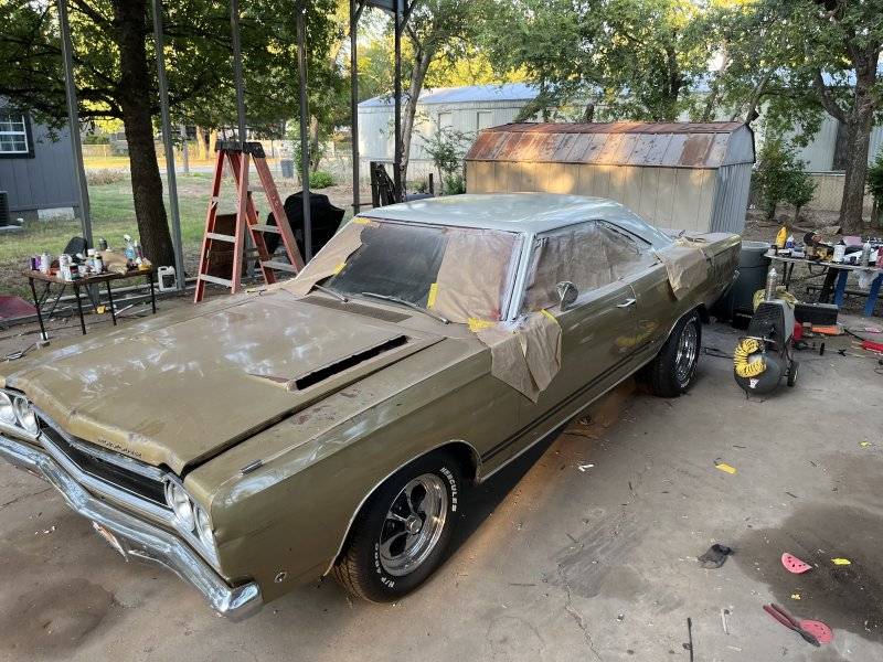

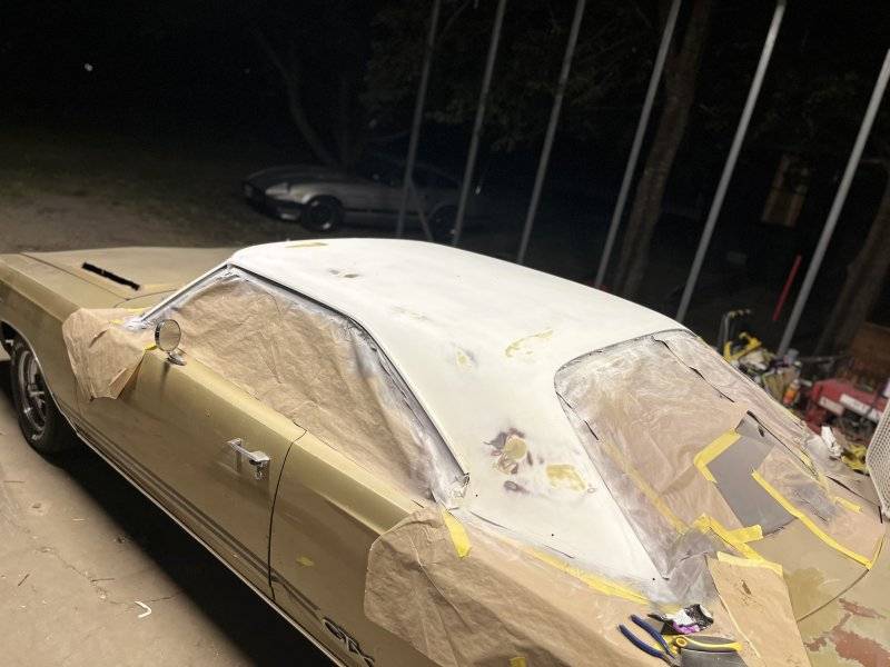

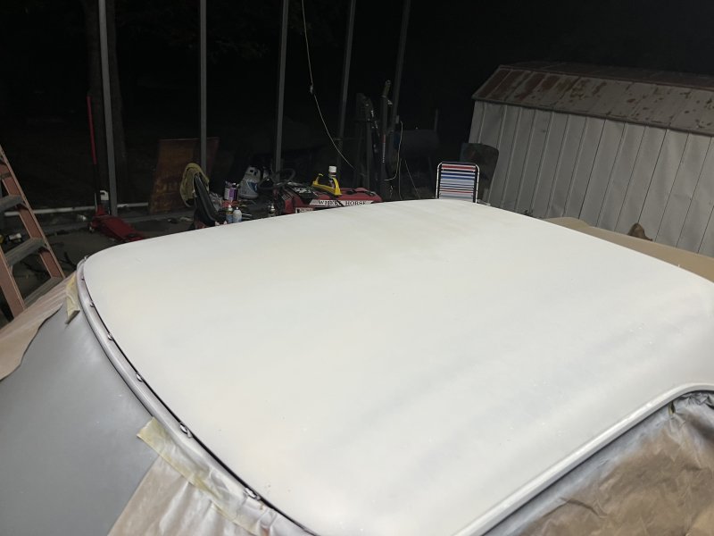

Bunch of spots needed cleaning up. Funny I stood back and looked at it, even though the primer is thin in places, there’s filler everywhere, I’m no longer repulsed by it, I’d almost run it as is :lol:
Well unsuccessfully successful I guess?

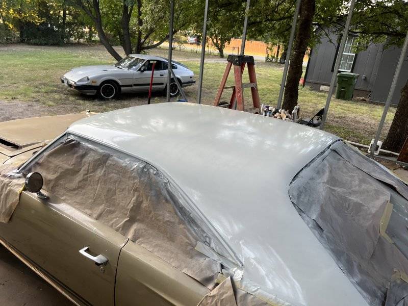

I thought 2 cans would be enough, but it wasn’t. I have more 2 cans coming but delivery was suppose to be yesterday, they won’t get here until this afternoon. I already had the day off scheduled so I went for it, I haven’t found anything on recoat time, but having the paint thin in spots does make it seem like it’s been there a while and sun burned like the rest of the car. That’s why I don’t know if this was successful or unsuccessful :lol:
Buzz can paint doesn't have a lot of solids in them, otherwise they'll plug up the nozzle.

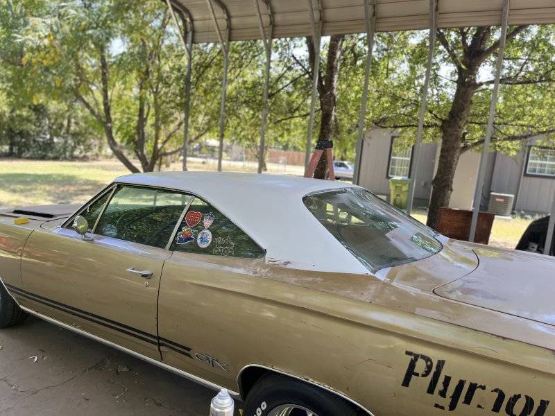

Don’t make it too nice or it won’t match your patina. Nice work though, are you still planning to do some graphics?
That’s the other reason I didn’t make it too nice, and the reason I put a layer of red primer on. I left a couple dents alone, and I’m going to sand through some of the paint in areas to match the rest of the car.

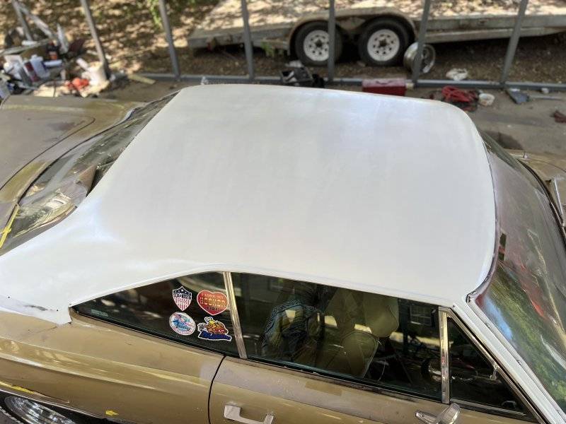

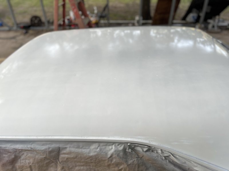

I knocked down most of the over spray with 800 and 1k. I can’t go further than that right now because I have to blend a couple of places, so no point doing all that work and doing all that work again
I knocked down the roof with 800 and 1k grit to prep for paint tomorrow. Installed the trim for reference and just to look at it

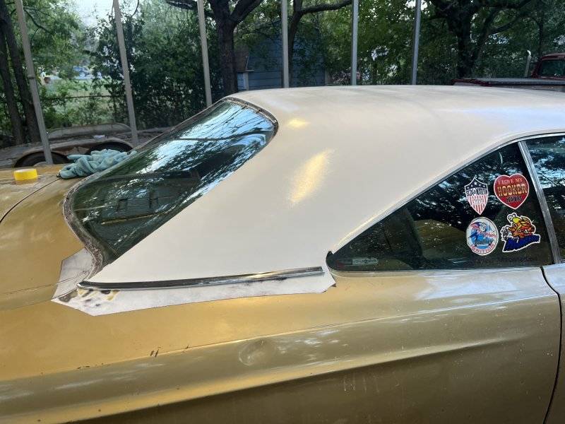

Then it was really worrying me about the paint so I had to do the first buffing step to ease my mind

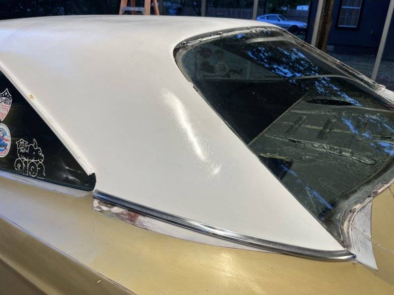

Are you going to do something about the white below the vinyl top trim? Personally, I’d sand the tape line out and dust in some single stage gold touch up paint. Even if it’s not a perfect match, it would clean up the lines and possibly add to the patina look…
