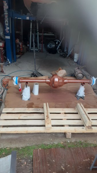

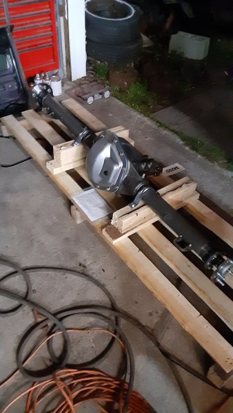

Yesterday afternoon my much awaited delivery arrived from Strange Engineering! A big heavy, beautiful 3.54 Dana 60 year axle for the 71 Charger R/T!
