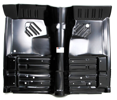

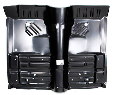

I have both an AMD and Goodmark. Without the stickers I could never tell the difference. You may ask why I have both. I bought the AMD 71+ B-body floor pan for my 71 Roadrunner. Turns out my car had the 1970 only E-body floor pan which has the flanges on the side. AMD was out of stock so I bought the Goodmark. Take a look at your pan to see what one you actually have in your car before ordering. Second picture is the one with the flanges.

wouldn't either one work though?

Pick them up and you will feel the difference, the AMD one is made of heavier gauge metal. The fitment is probably about the same. Mark Hedrick who owns AMD is the "Mark" in Goodmark.
So essentially they're going to be made in the same place. Just a different gauge metal? The AMD stuff I have is 18 gauge. The one Goodmark piece I have is 18 gauge as well. Measured both. I'd be curious if those floor pans were measured because I've heard others say same thing.

I've never seen a 70 E pan in a 71 B even in my early built cars. When and where was yours built? Got any pics? B and E rockers are totally different.

Both of those are AMD pieces,they have AMD stickers right on them.

Here are pictures of both. I was very surprised as well. There was just nothing to weld the floor pan to unless I did a solid bead along 75% of the sides.
Looking at mine it’s definitely like the first pan. It’s got those tabs that stick out near the top where it curls up to to the firewall.
So the question is will the other style still work?
