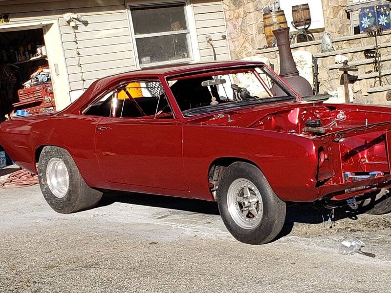

Got some color in the engine bay
Magnificent. And the color. Just WOW!
Did you have any issues with clear coat runs?

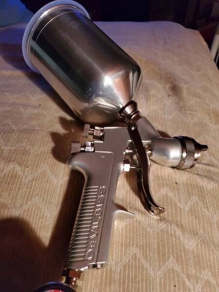

I'm a big fan of the Iwata and Devilbiss spray guns.

I had a couple runs. Not many.
I used a 15 dollar harbor freight gun for the engine compartment and trunk. Then I stepped up to the big money Eastwood concourse gun for 130 bucks for the rest. Lmao

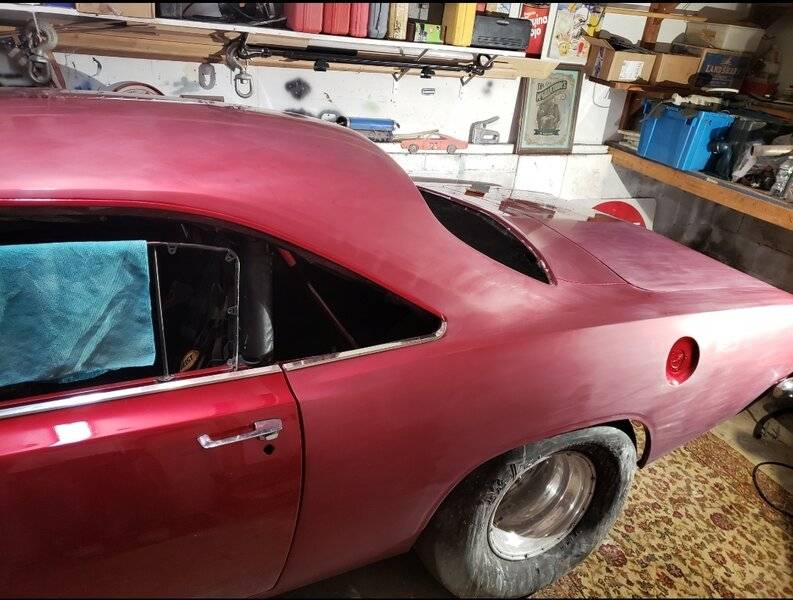

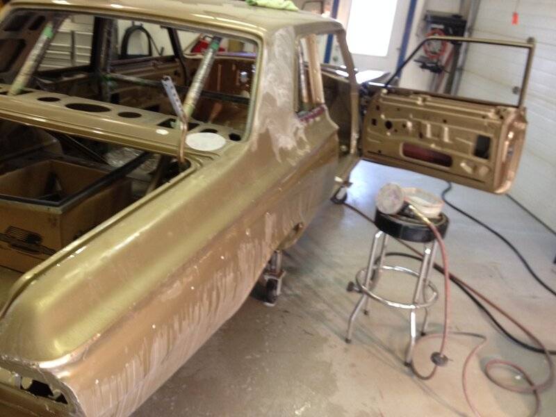

A little shine removal today...
I wet sand and polish my doors, trunk lid and hood off the car.
So much easier, but I figured your were excited to see the finish product.
Now the rough part comes. Compound, and then machine glaze.
So much fun.

I always sand/polish with the car fully assembled. Yours is going to look real good when it’s done.

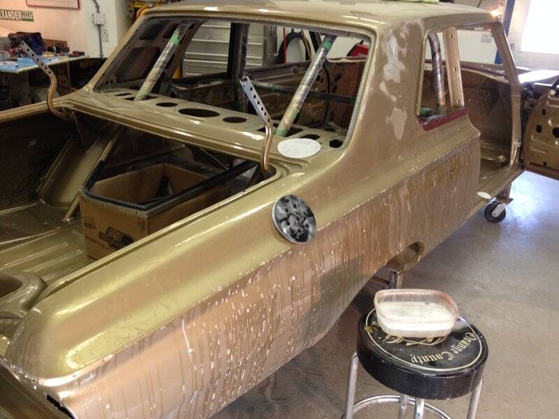

Here’s a couple of motivation pics for you of my 64, I had already dry sanded with 1000 with the orbital and this was now with 1500 WET. In the pic I had pulled the pad off the orbital and was hand sanding when I took the shot.
Can't argue with your results.
I'm hand sanding all the way though. I started with 1000 and will go 2000 and finally 3000.
I wish I used the DA...
You'll have more control wet sanding by hand over a DA if you haven't done it much. You can see what it takes to just remove the orange peel ect. and just sand off enough without burning through the clear. Use a piece of tape on the sharp edges to protect from scuffing through especially when you get the buffer out.
Don't buff the compound or the polish completely dry like I see so many do. Leave just a light film and remove it by hand with a nice cotton rag. You'll have less or no swirl marks this way.

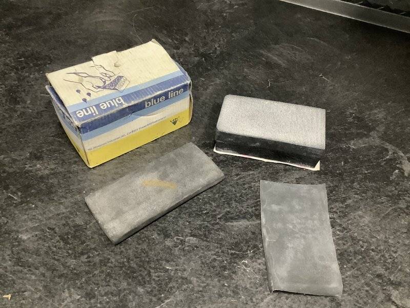

Who remembers or used to use the Blue Line block. I used these through the 90’s and up to about 2008. Stick on paper and the block was hard on one side and foam on the other, which was still quite firm.
Man this was labour intensive but they sure did a great job. And when you’d get a piece of crap from somewhere under the block you’d hear it scratching. Flush it out, look and often you’d see a fine scratch sure as ****. Orbital sure speeds things up but IMO the blue line blocks turned out a smoother surface.

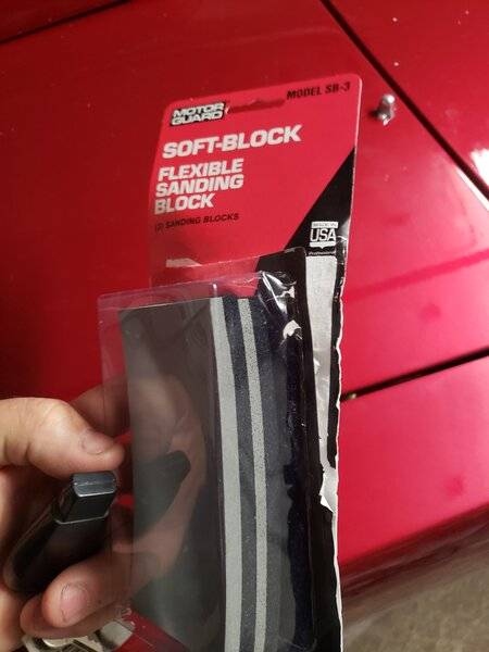

These are the soft blocks that I picked up.
Yeah Bobtile.
