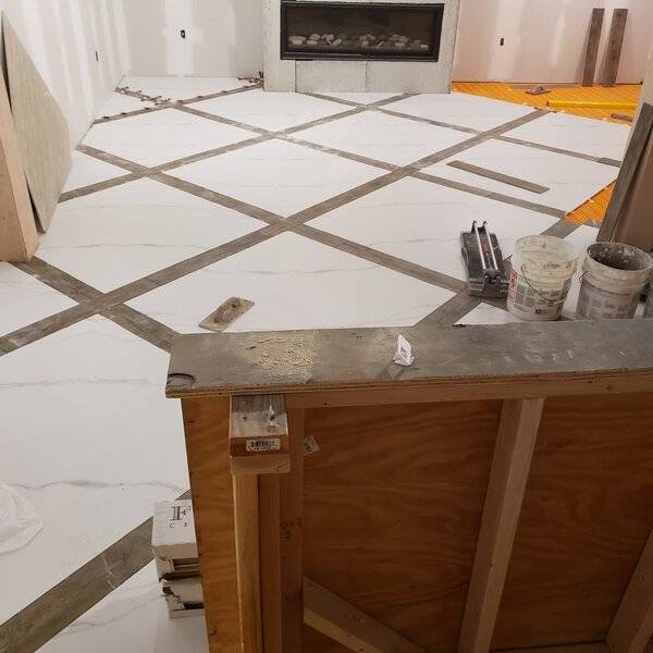

I had no idea you did flooring.

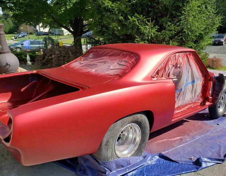

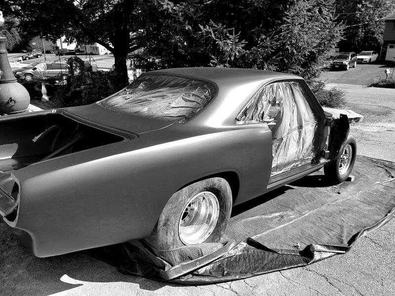

Same picture as #54 but in colour it looks like? Amazing how the colour changes with the clear.
Yes, same picture.
I really like the color without the clear on it.
It got me thinking about a matte clear, but I think it will still change the color.
Yes, same picture.
Either clear will likely change the colour but your engine compartment is done in gloss already, so I’d bet you’re going with gloss. Will be nice to see all finished.
Are you using a adhesion promoter? Sounds like you didn't clear it yet. It's a metallic right?
The products I used to use had an allowance of usually up to 48 hours for good chemical adhesion. Longer than that it was recommended to topcoat the base.
Hopefully I'll finish next weekend. It's a metallic red. I have sealer + 3 coats right now. Its been dry for a couple weeks now. It's scuffed and I'll put another coat if color and then clear.
