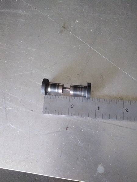

Depends on if you have a cone unit or a clutch plate unit. The cone unit has a trapped center pin and well, it's much more than just a pin and cannot fall out. The clutch unit is the one that has the thrust buttons that are held together with a roll pin. Those I take out but don't worry much about the cone thrust button. I may have a pic of what each of them look like and will post it if there's on on this machine.

Like I said above, those I take out. Just don't trust them to stay in place with a wormy 1/8" roll pin.....Here's a pic of what's in there.....and I couldn't find one that came out of the cone unit.

I've seen damaged gears etc from the center pin on the clutch units coming apart is why I remove them. There's no way the center pin of the cone unit can fall into the bottom of the housing to be picked up by the gears.....unless there's a catastrophic failure of the whole thing and even then it would most likely stay in place.
