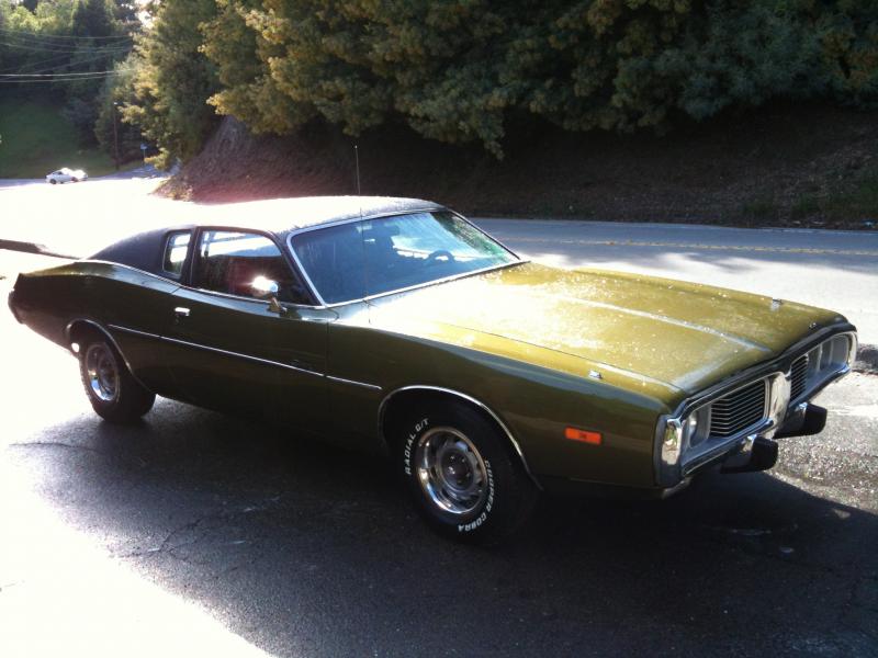

Thanks LE I plan to take my time there is a lot of rust to remove and repair. This is a true adventure.

Right on, Rebel! I dig the name "Green Envy", you certainly don't see many green Chargers out there... looking forward to following your progress on the resto, good luck!
Green Envy, meet Avocado Gold:
