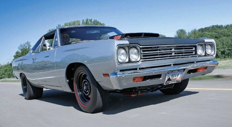

Based on this photo, can you guess/speculate on the rear wheel and tire sizes? This photo has me drooling, and I would love to set my car up like this one. Also, could this have been done with shocks/springs in stock locations or was this car mini-tubbed and the shocks and springs moved inboard?
Man that looks like a 10" wide wheel on the rear. I run 15x8's and the tire bulges quite a bit and this looks wider with no bulge on the rear. I would guess 295/60/15 range for the rear. The front looks like a 235/60 or a 215/70.....somewhere in that range.
Definitely looks like a 10” wheel. A 295/50/15 tire would be shorter than the one in the picture, and it also kinda looks like a drag radial, so I’m guessing it could be the M&H 275/50/15”
You can fit a 10” wheel with stock spring and shock locations but things are tight with the tire.
This is a 255/60/15 on a 8” wheel and you can see how much more room there is.

That picture blown up as big as i can get it, looks like a M/T et street radial pro. They only come in two sizes, 275-60x15, and 315-60x15. (Note: 60 series, taller than a 50). I think you can get a 275 under a 69 runner, on the right rim, but if thats a 315, and thats what it looks like, i think he had to move the springs at least, and maybe a mini-tub. I have a set of 315s,and a 69 runner, and i very seriously doubt the 315s would fit!

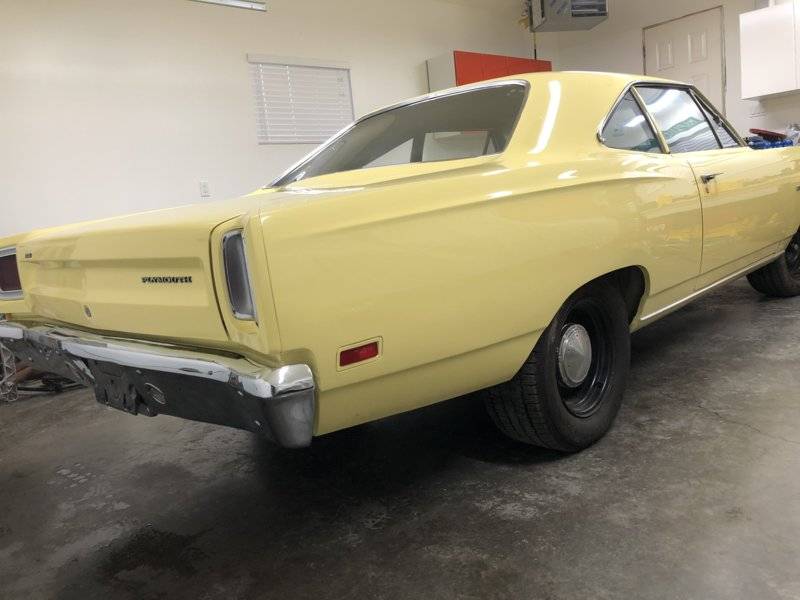

My 68 Runner rubs lightly with a 255/70/15 under the rear. I am unsure if the 275/60/15 will fit on the Runner without rubbing at all over bumps. I am redoing the car and want to run a 275/60/15 but don't wanna rub the upper wheel tub inside and scuff the redline tires. The 255/70 is 29.1" diameter and the 275/60 is 28" so I am hoping someone will agree that will fit better. They fit fine on my 68 Charger, but the quarter on the Runner is a bit diff and I am unsure if the inner wheel tub is identical on the Dodge and Plymouth.

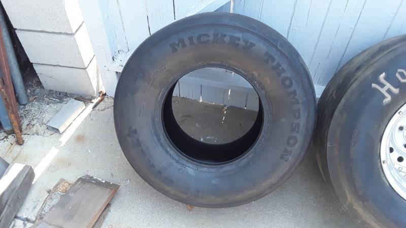

I ran a 10 1/2x28 mickey slick on my runner, no problem. That tire is bigger than a 275-60x15. I think a 275x60 should fit fine, on the RIGHT rim, with the right backspace. Mine were on a 15x8 1/2 centerline autodrag with 4 7/8 backspace. ( a little too much backspace can be fixed with a small wheel spacer, if you dont have enough bs, the tire will rub the fender.) I use the same wheels and the same slicks on my 62, but i have to use a .350 spacer, the 62 wheelwells are tighter.
