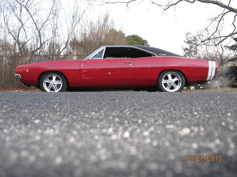

This car:
Uses an 18 x 9 up front and a 275-40-18 Nitto NT 05 tire. Rear has an 18 x 10 with a 295-35-18 Nitto NT 05 tire. All 4 wheels have the same 4 3/4" backspacing.
The fronts only rub their sidewalls to the frame rails at full turn, otherwise no contact. Even then, the tires rub against a flat surface causing no damage.
The rears don’t contact anything.

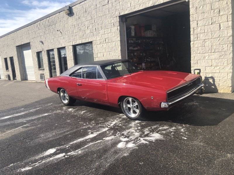

This car:
Uses an 18 x 9 up front with 4 3/4” backspacing and a 275-40-18 Nitto NT 05 tire. Rear has an 18 x 10 with a 295-35-18 Nitto NT 05 tire. The fronts only rub their sidewalls to the frame rails at full turn, otherwise no contact. Even then, the tires rub against a flat surface causing no damage.

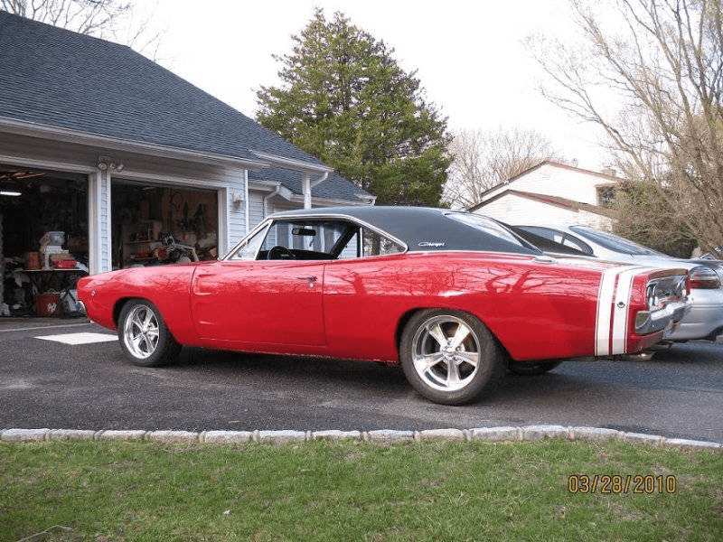

This car:

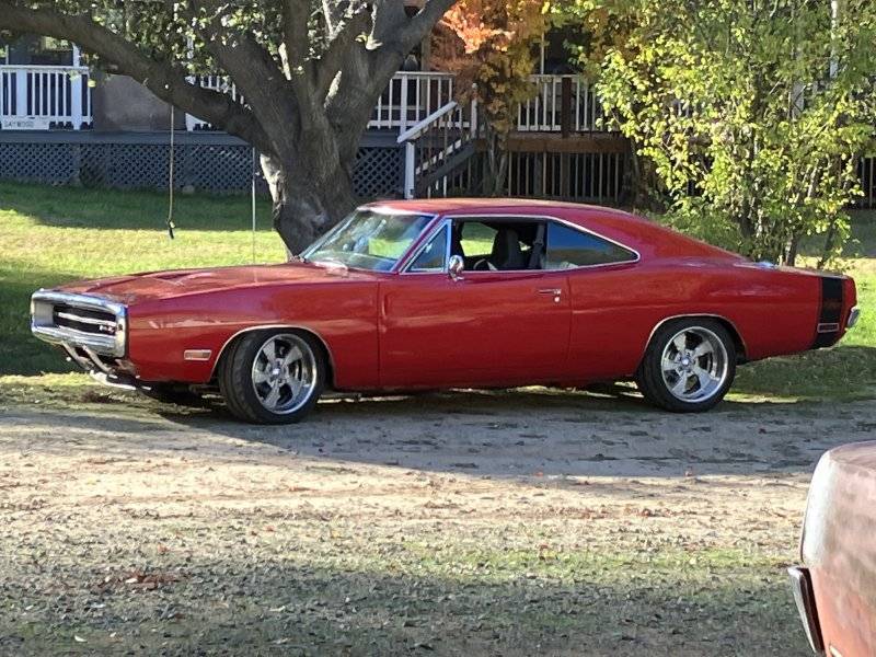

Very same question here. Looking to replace the stock 15s on my 70 Charger. Looking at this exact set up: 1968 Dodge Charger
Think there will be any clearance issues? Wheels appear to be 0mm offset/4.5 backspace front; 0mm offset/5.5 backspace rear.

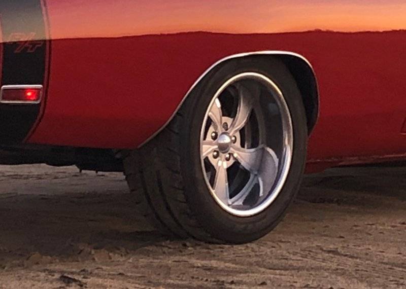

Here is what I did.
Increasing rear tire clearance in a '70 Charger.
