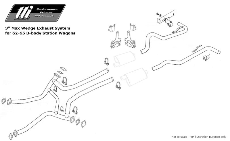

The h will work best if you paint stripe down the head pipe and let it burn off. Where it ends is where the h wants to go. Packaging is a problem with that deal so do what you have to.
