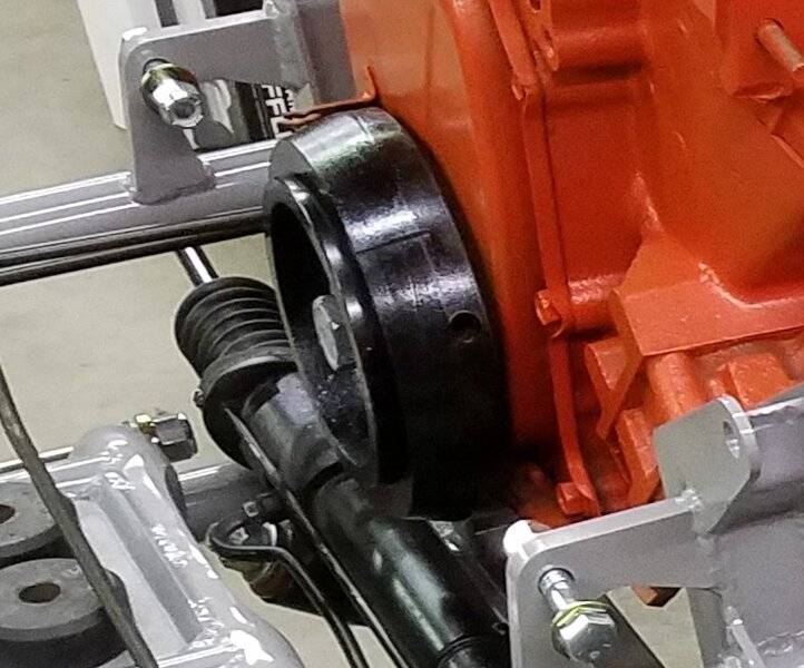

Just curious. Is this a stock balancer, or has
it been machined down?
The engine has a forged crank, and is internally
balanced. 1968 block.

Bad picture. Take one looking at it dead on so we can see if it's ext balance
The center (counter balance) ring is perfectly
round. Sorry, can't supply a better pic.
I would guess maybe they turned it down on the lathe(the oblong inner ring).
As pointed out in the 440 source document, it's not a hemi balancer, but the 76-78 bullet nose one.
I'm inclined to agree that it's been turned down.

The only Hemi balancer I have seen are ones on the web in images. They are usually thicker and squared off like 440/383 internally balancers. The latter are usually only about 1" to 1.25" thick and the former almost 2" thick. The chamfered edge was NOT cut by a machine shop, the late 440 cast crank balancers came like that. Please reference the link in my post #4. The cutout is on the back side of the balancer for the offset weight. Just because the build sheet says forged, doesn't mean it is. They could have made a mistake when writing it up. The ONLY way to verify is to pull the pan and verify the wide or narrow parting line on the crank throws. Can't say that you can't balance an internal steel crank with an external balancer, but I would think a lot of material would need to come out of the last counterweight. If it runs fine, and you don't want to go inside to verify the rotating assy, then don't, but I would lean towards a cast crank is inside.

It is a forged crank with a modified cast crank
balancer installed. The torque converter installed
helps to confirm this as the one I bought is
"neutral" balanced with no weight welded on it.
The engine runs smooth with no shakes or
shudders.
The counter balance center section on the
balancer has been machined to round.
