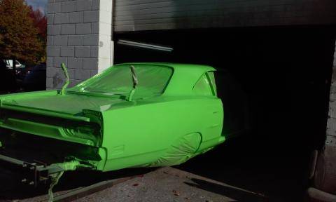

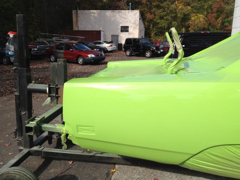

The 'ol girl is looking FINE in her new coat of paint - finally back to her original color after many years of wearing yellow! Given my time and inexperience with bodywork, I could never have achieved anywhere near this kind of result. Proof that I took it to the right place! Thanks Mark and Tom.

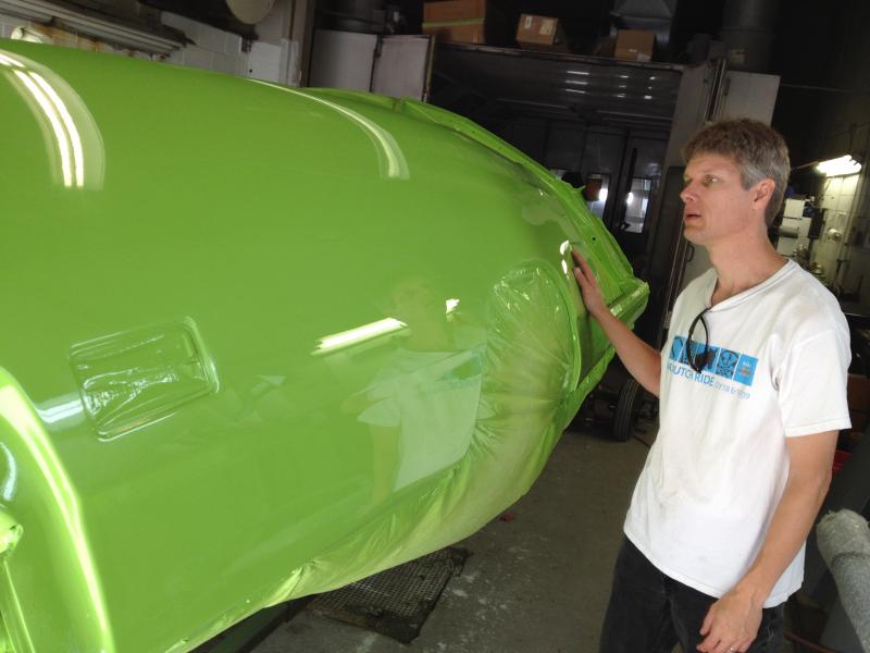

I went down today to check out the car in person and bring the rear down too. The car looks fantastic! And the important thing is that the beauty is not just skin deep: every effort has been made to remove any and all rust, and paint/protect the inside and hidden areas as well. This thing is about as well prepared and protected from future rust as is reasonably possible.
Mark is doing a great job on this car - I am going to have to step up my game to keep up with his quality and attention to detail... :headbang:

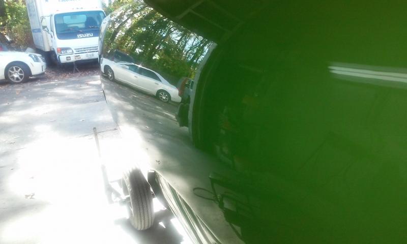

Forget my ugly mug in this picture - check out the reflection instead :icon_fU:

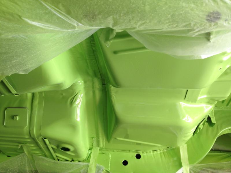

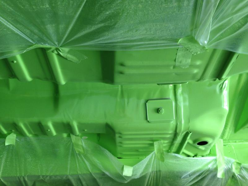

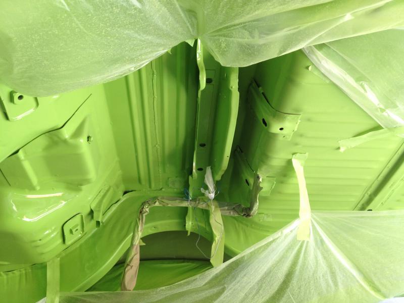

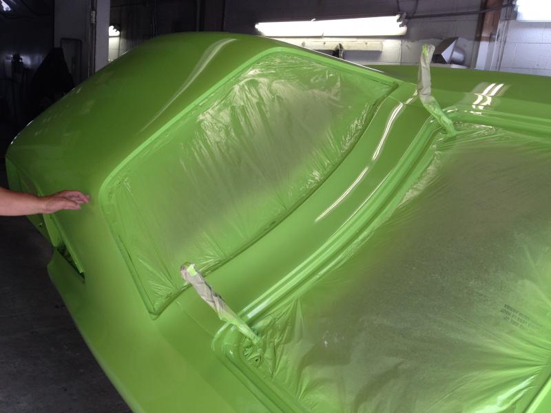

It was cool to check out little details that Mark did. For example, he mimicked the factory spot welds throughout the body, so you really can never tell that quarter panels were put on the car - it looks totally factory. The bottom of the car is "over restored", but that was because I wanted to protect the bottom from rust as well, and it was just as much work to paint it a primer grey color as it would have been to paint it Limelight. Here are a couple of shots of the bottom, somewhat hidden with plastic to protect them from overspray...
In this shot, the new fuel lines are wrapped up - they had to be installed prior to the sub-frame connectors going in. Otherwise they would need to be cut and reconnected and I didn't want an extra connection that could leak...
Next two shots are all the factory original floor - that did not need to be replaced...
