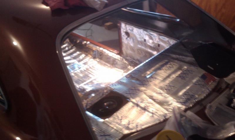

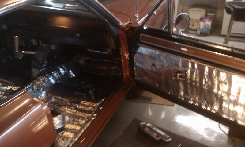

The package tray will fit fine with the Dynamat and it can't be seen afterwords, I had extra material so I did the cardboard divider, I wanted to keep out as much noise as possible.
Thanks - this is a great picture too, as I see you covered the interior area on the side, rather than trying to get some Dynamat slid in through the back window channel. I will do that too unless there were fitment issues with doing that - I was worried that there would be, but I was honestly unsure how the heck I was going to be able to get it back there!
It to me and my big *** hands it looked impossible to get anything behind there, although I know some people have, I also did the doors the same way stopping the dynamat just behind the push in clips for the panel and once installed it looks perfect, I don't know how much it helped sound wise but I had enough material to do it so I went for it
Fantastic feedback - Thanks! Then I will do the same and not kill myself getting into all the small spaces. Even though I have smaller hands and can sometimes reach into tight places, I still don't enjoy the cuts and marks that would come with trying to smooth out and firmly adhere the Dynamat in there.
My hands thank you sir! :headbang:

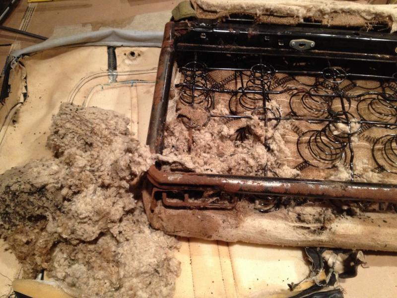

The good news is, I got my front seat recovered. I think it came out pretty good, maybe a B+ or A- job, so I am pretty happy. The biggest issue was that &^$#! mice had gotten into the passenger seat back. It stunk, but the worst part was, all the fluff and stuffing they brought into the seat back helped to rust some of it. Luckily, the seat bottom and driver seat back were OK.
Here is what happens when mice get into seats - yuck!

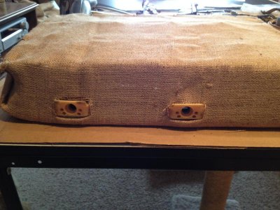

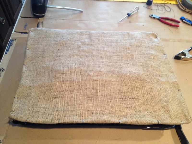

First added some burlap to the seat backs

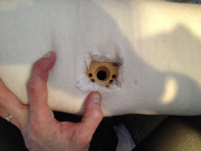

Head rest holes needed to be cut into the burlap

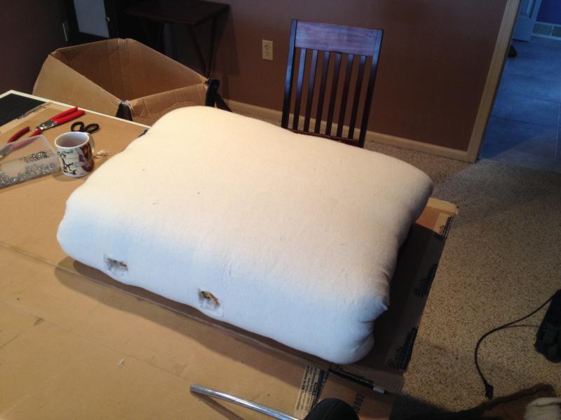

Then added 4 layers of cotton and cover - the head rest holes needed to be cut out again prior to putting the cover on.
The completed seat back - ready for the seat cover. What I don't have pictures of is the seat cover installation. I folded the seat back cover in half. Based on a tip I saw on a video clip, I put a plastic bag over the seat back. This helped the cover easily slip over the seat back. Once it was half way on, I rolled the rest of the cover down over the seat and attached it.

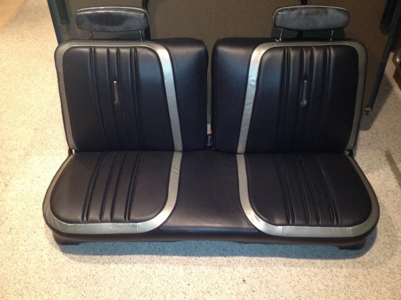

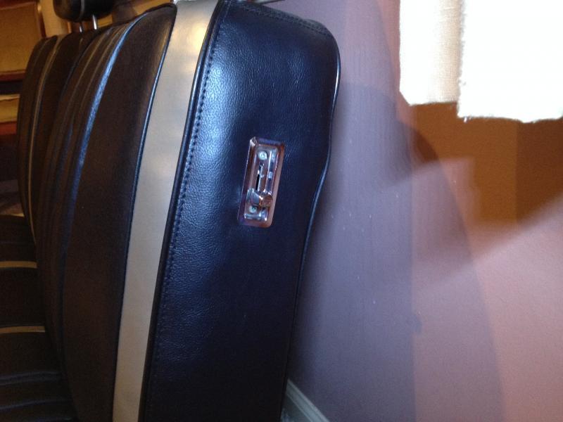

Completed seat. Ignore the head rests - they are wrong and obviously not in great shape. These still need to be completed. I think with a little heat gun action and "resting" in place the wrinkles in the seat will get a lot better...
Here is a shot from the side
